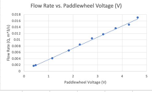

Step 8: Analysis: Flow Rate and Paddlewheel Voltage
The relationship between paddlewheel voltage and volumetric flow rate is demonstrably linear here. Thus, we can calculate cutoff fluid velocities using the equation Q = V*A. Taking the area of the flowmeter entrance as 102.3 mm given in Table 1 above, we get A = pi* (.1023/2)^2 , and thus the velocities are 0.202 m/s and 2.07 m/s. The maximum fluid velocity would correspond with highest flow rate Q, meaning the maximum fluid velocity achieved is 2.07 m/s.

The paddlewheel flowmeter is reliable, because of the linear relationship we observed between flow rate and paddlewheel voltage. It would be more accurate and higher flowrates because if the pipe was not fully filled with water, there might be differences in flow reading based on where the water is hitting the paddle. Therefore, a full pipe of water flow would be ensured at higher flowrates to minimize error.
