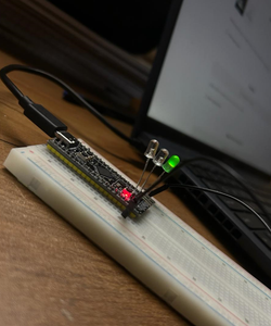

Introduction: THREE LED PATTERN USING BREADBOARD
In this project, we're using a breadboard and an STM (System Target Management) setup to create a cool light pattern with three LEDs. It's like making a mini light show! By arranging and controlling the LEDs, we can make them blink or glow in different patterns. It's a fun way to learn about electronics and coding while making something eye-catching. So let's dive in and see what kind of cool patterns we can create.

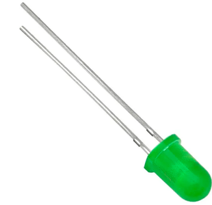

  2. LED 3V

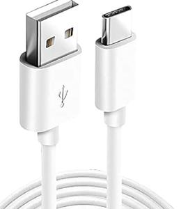

  4. C-type Cable

Step 6: Add the Code
HAL_GPIO_WritePin(GPIOC,GPIO_PIN_13,0);
   HAL_GPIO_WritePin(GPIOC,GPIO_PIN_14,0);
   HAL_GPIO_WritePin(GPIOC,GPIO_PIN_15,0);
   HAL_Delay(400);
     HAL_GPIO_WritePin(GPIOC,GPIO_PIN_15,1);
     HAL_Delay(400);
      HAL_GPIO_WritePin(GPIOC,GPIO_PIN_14,1);
      HAL_Delay(400);
        HAL_Delay(400);
        HAL_GPIO_WritePin(GPIOC,GPIO_PIN_13,1);
         HAL_Delay(400);
           HAL_Delay(400);
            HAL_Delay(400);
              HAL_Delay(400);
Write this given code in While Loop.

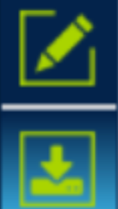

Step 7: Build Binary File
Click on debug (On top left corner) to build a new binary file.
Step 8: Open STMCubeProgrammer and Connect With STM Board Via USB
Change ST-Link to USB and click on 'Connect'.
Step 9: Go to Download Options
Step 10: Modify Download Options and Click on "Start Automatic Mode
Step 11: Final Step
