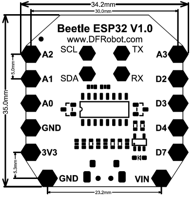

With BEETLE-ESP32, Bluetooth and WIFI are integrated in microcontroller for supporting more applications. So I can easily build up a car which can be remotely controlled via WIFI or Bluetooth.
With dimension 35×34mm, Beetle-ESP32 is suitable for projects that require compact electronic components. It is equipped with 4 analog ports, 4 digital ports, UART and I2C interfaces.

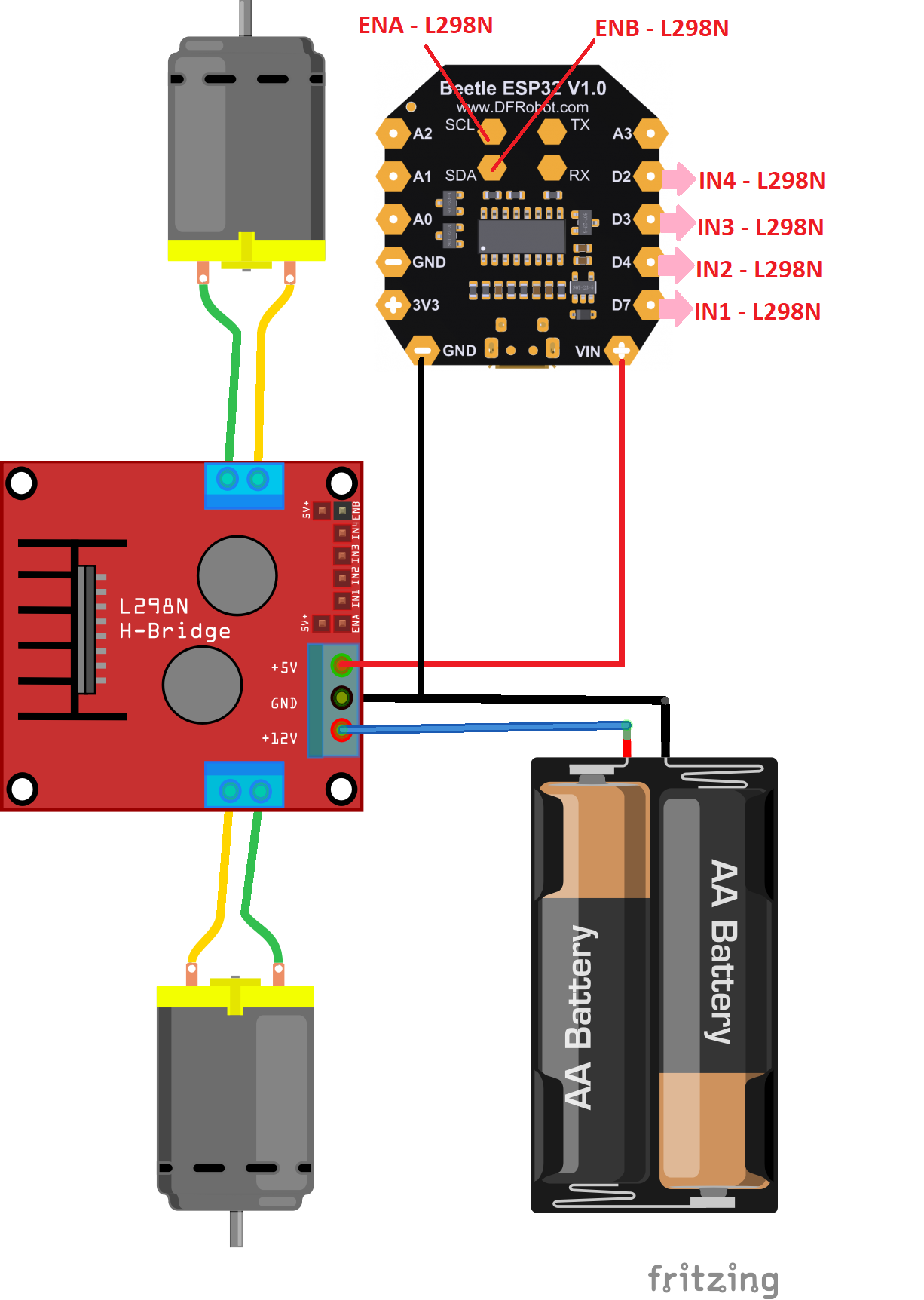

Here below is the connection diagram of 2 wheels car:

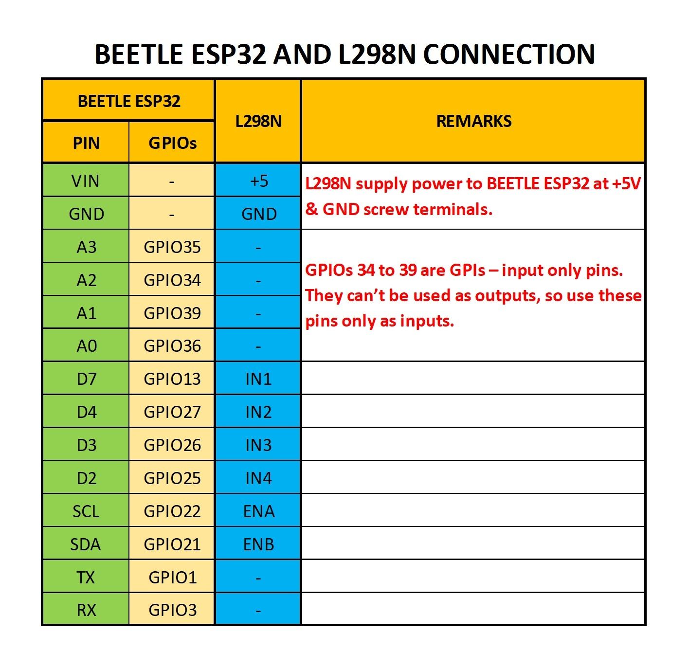

To control the direction and speed of 2 wheels car by L298N, we need 6 control signal outputs from BEETE-ESP32. The BEETLE-ESP32 has 4 digital ports and 4 analog ports but unfortunately, we cannot use 4 analog pins (A0 ~ A3) as outputs, only be used as inputs. With ESP32-WROOM-32, GPIOs 34 to 39 are GPIs – they're input only pins.
- GPIO 34 – A2
- GPIO 35 – A3
- GPIO 36 – A0
- GPIO 39 – A1
So I had to use 2 pins of I2C interface (SCL and SDA) to control motor speed, they were connected to ENA and ENB pins of L298N.
Take note that L298N supply power to BEETLE-ESP32 at +5V & GND screw terminals.
For more detail, we can check their connection as table below:

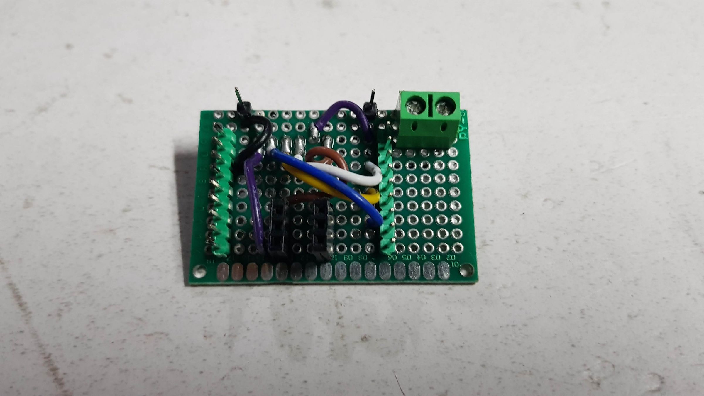

SOLDERING HEADERS FOR BEETLE ESP32: The distance between the BEETLE ESP32 pins is 5 mm, so we can use the popular 2.5mm male/ female header and modify it a bit by this way: with every distance 5mm - 3 pins header, we remove a pin in the middle.

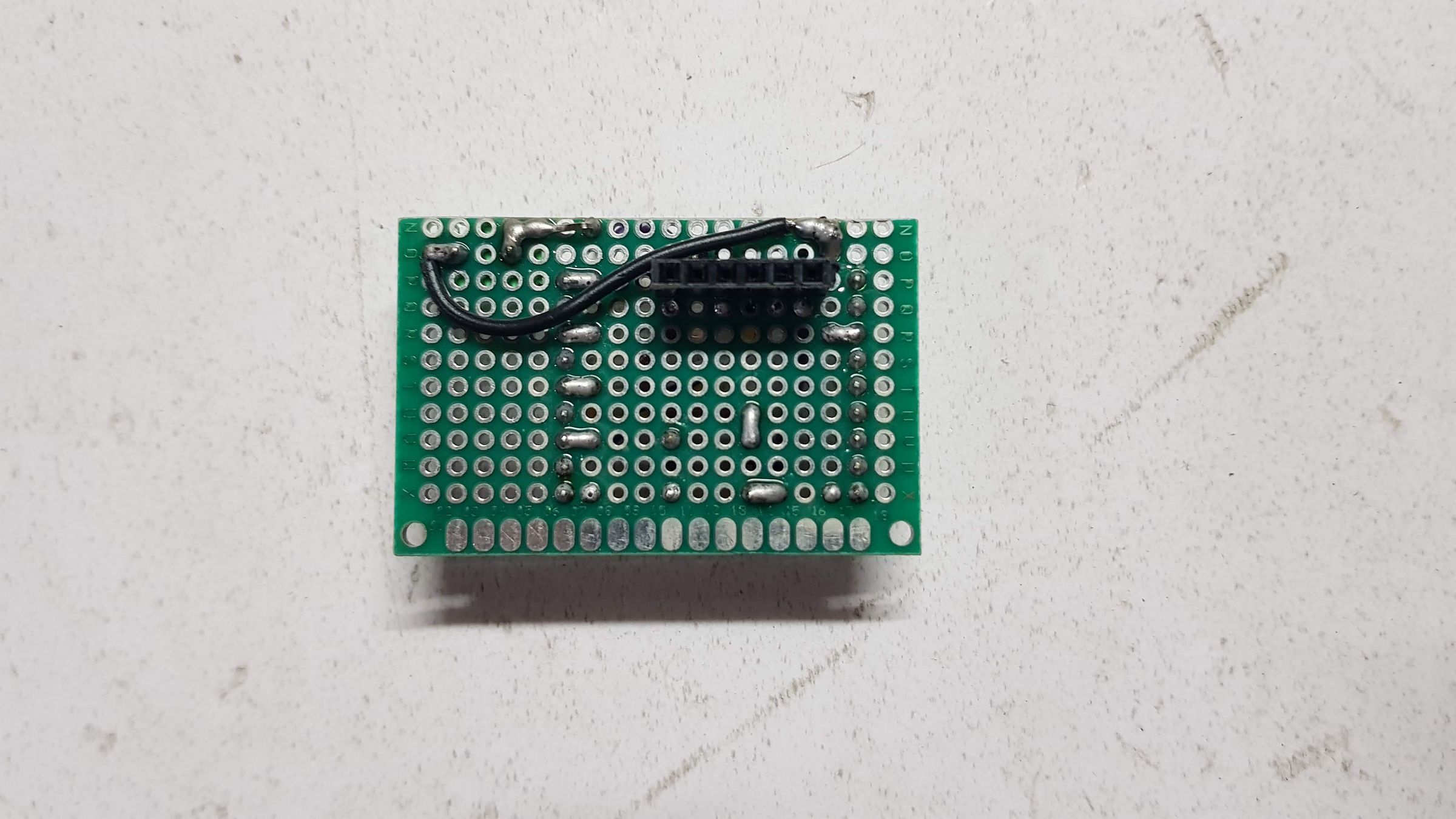

SOLDERING AN ADAPTER CONNECTING BEETLE-ESP32 AND L298N: Cutting double-sided proto-board into 2 equal parts. I used half of this proto-board to make the adapter shield which BEETLE-ESP32 can plug on its top and the L298N can plug at its bottom. The adapter shield was soldered following the schematic on previous step.
- Adapter shield - TOP: is connected to BEETLE-ESP32.
- Adapter shield - BOTTOM: is connected to L298N at 6 pins female header.

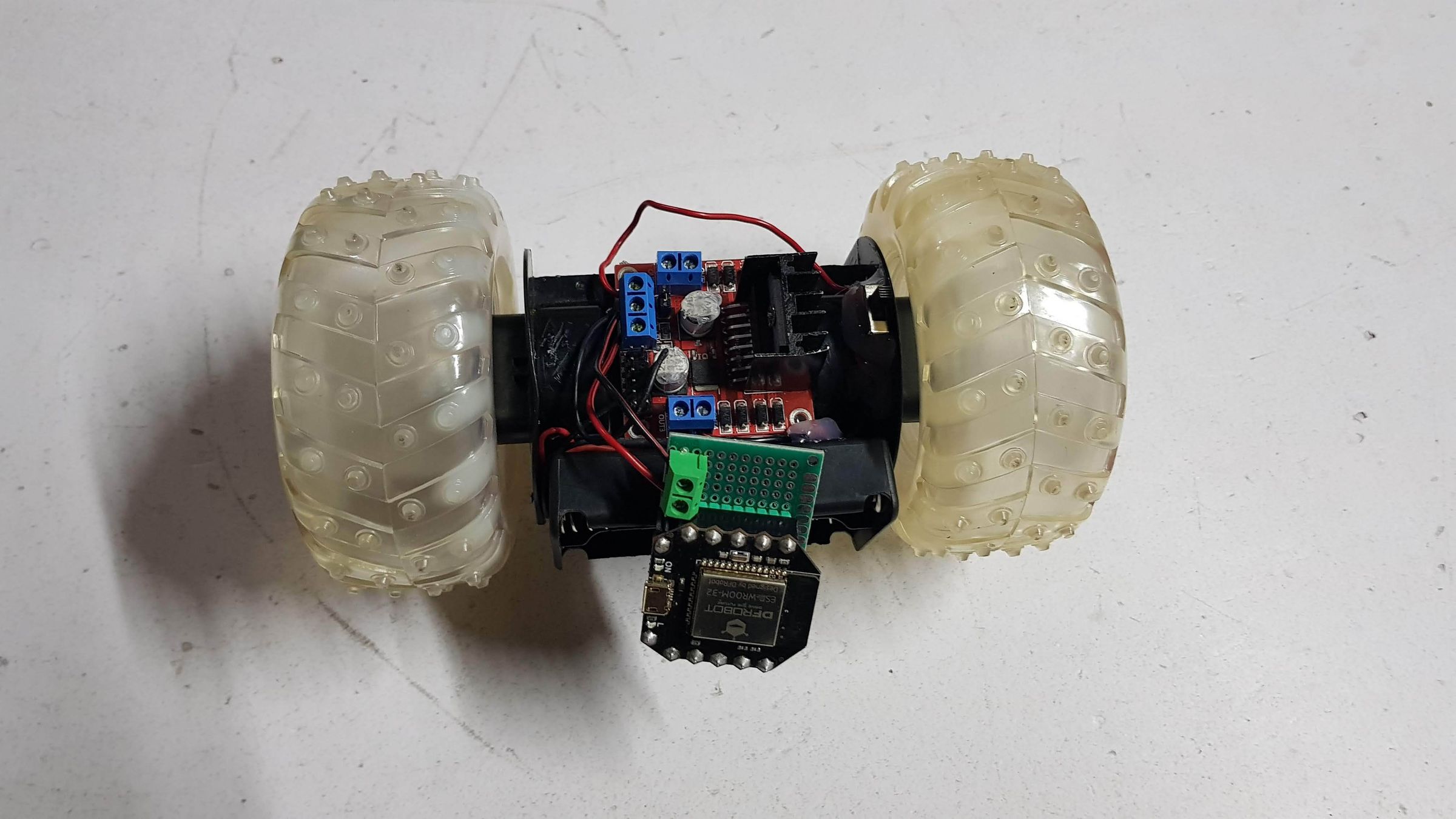

BATTERY HOLDER: Glue battery holder to the car chassis. We need to test and ensure that battery holder and chassis including 2 DC motors can freely rotate around the car's axle.
L298N INSTALLATION: Glue motor driver module H-bridge L298N and battery switch to the car chassis.
ADAPTER INSTALLATION: Connecting power supply wires to adapter shield. It supply +5VDC and GND to VIN of BEETLE-ESP32.

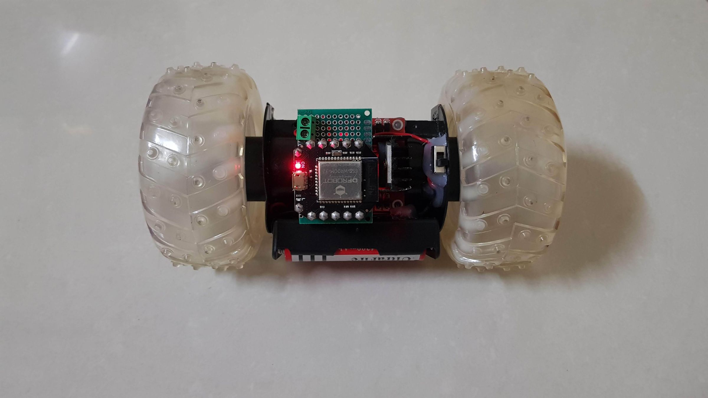

ASSEMBLY DONE: Plug adapter shield on the L298N. Due to car can be operated in high speed rotation so we need to arrange wires neatly, and fix all components firmly together by glue.

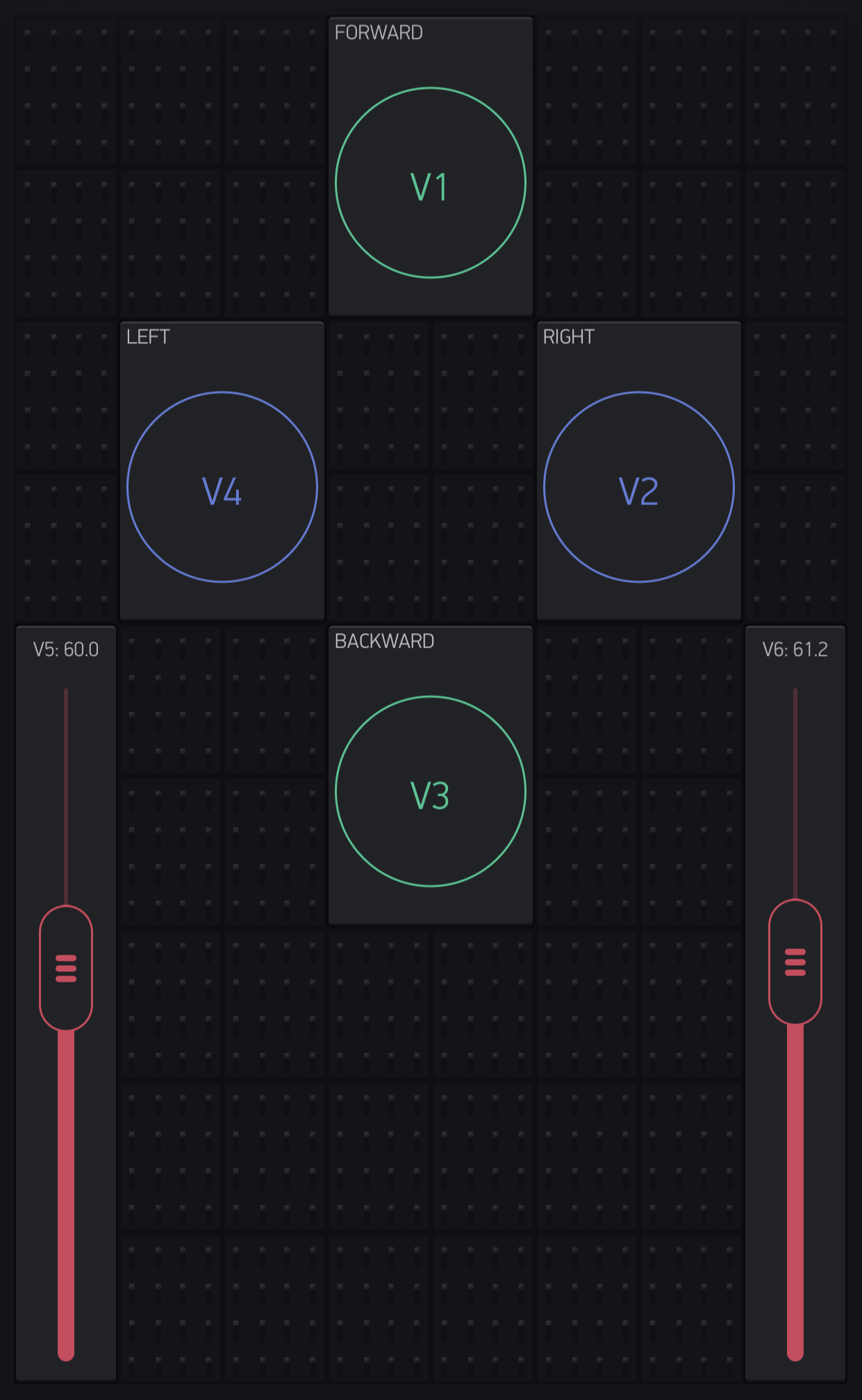

Step 6: REMOTE CONTROL BY BLYNK
I created on the Blynk app a panel with 4 push buttons V1 ~ V4 and 2 sliders V5 ~ V6. You can refer to previous programing step for more detail.
- V1 - FORWARD
- V2 - TURN RIGHT
- V3 - BACKWARD
- V4 - TURN LEFT
- V5 - LEFT MOTOR SPEED
- V6 - RIGHT MOTOR SPEED
With 2 sliders, I can calibrate 2 wheels to expected speeds or adjust their discrepancy to perform some crazy movements.
Step 7: FINISH
My daughter - 8 years old - is very active and naughty. She just wanted this car to spin rapidly, laughed and jumped for joy. Simply that is my pleasure!
