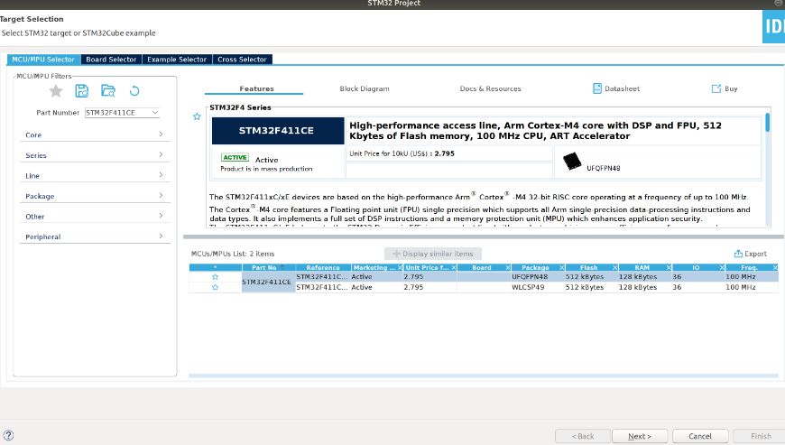

  • Launch STM32CubeIDE and create a new STM32 project for your Black Pill board.

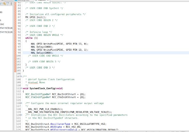

Step 3: Writing the Code
  • In STM32CubeIDE, navigate to the Core folder and open the main.c file.
  • Initialize the HAL library by adding #include "stm32f401C_hal.h" at the beginning of the file.
  • After that we will write the code to blink the LEDs in various combinations.

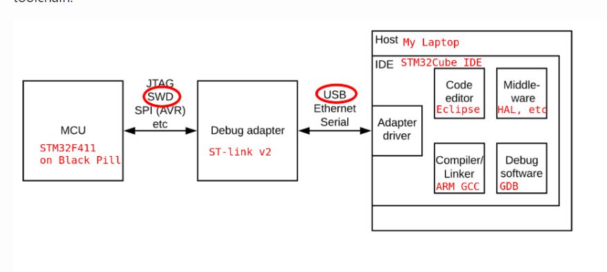

Step 4: Compiling and Flashing the Code
  • Click on the hammer icon in STM32CubeIDE.
  • Connect STM32 Black Pill board to y computer via USB.
  • Click on the play button to flash the code onto the board.
