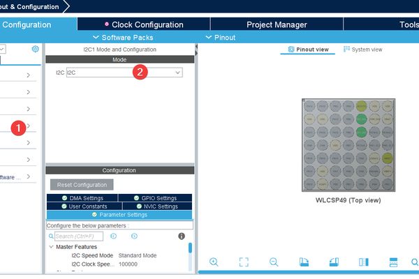

Step 4: I2C Configuration
Configure the I2C under connection menu

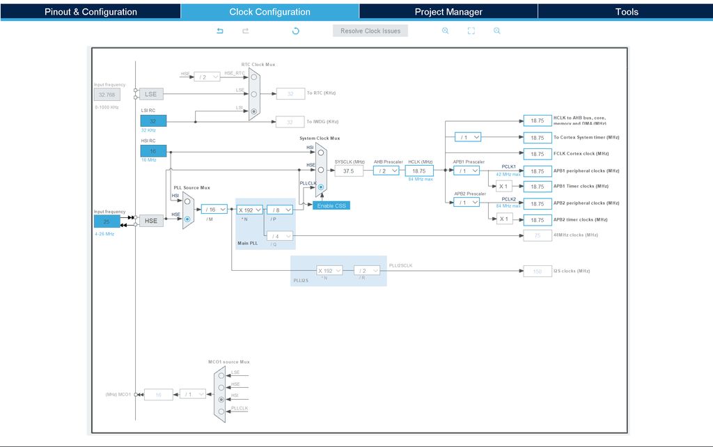

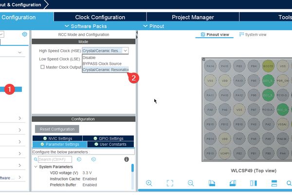

Step 5: Configure the Clock

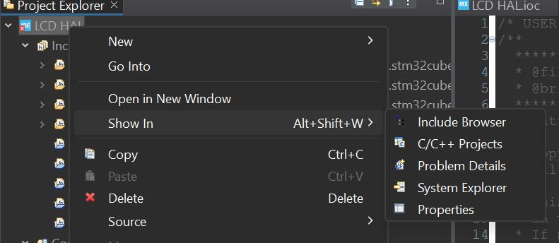

Step 8: Opening the .elf File Created in System Explorer
Right click on the project and click on show in system explorer and copy its path
