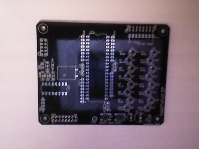

Step 1: Design Your Board
Step 2: Prepare Your Copper

Step 8: Cut the Execess Copper
Step 9: Develope Board
using a glass or plastic container place your board in the bottom. fill the container up to cover the board from an 1/2" to 1 1/2" of Etching Solution. gently shake the container from side to side. At room temperature this will take about an hour and a half. With the liquid at higher temperatures it will take less time to develop the boards.
