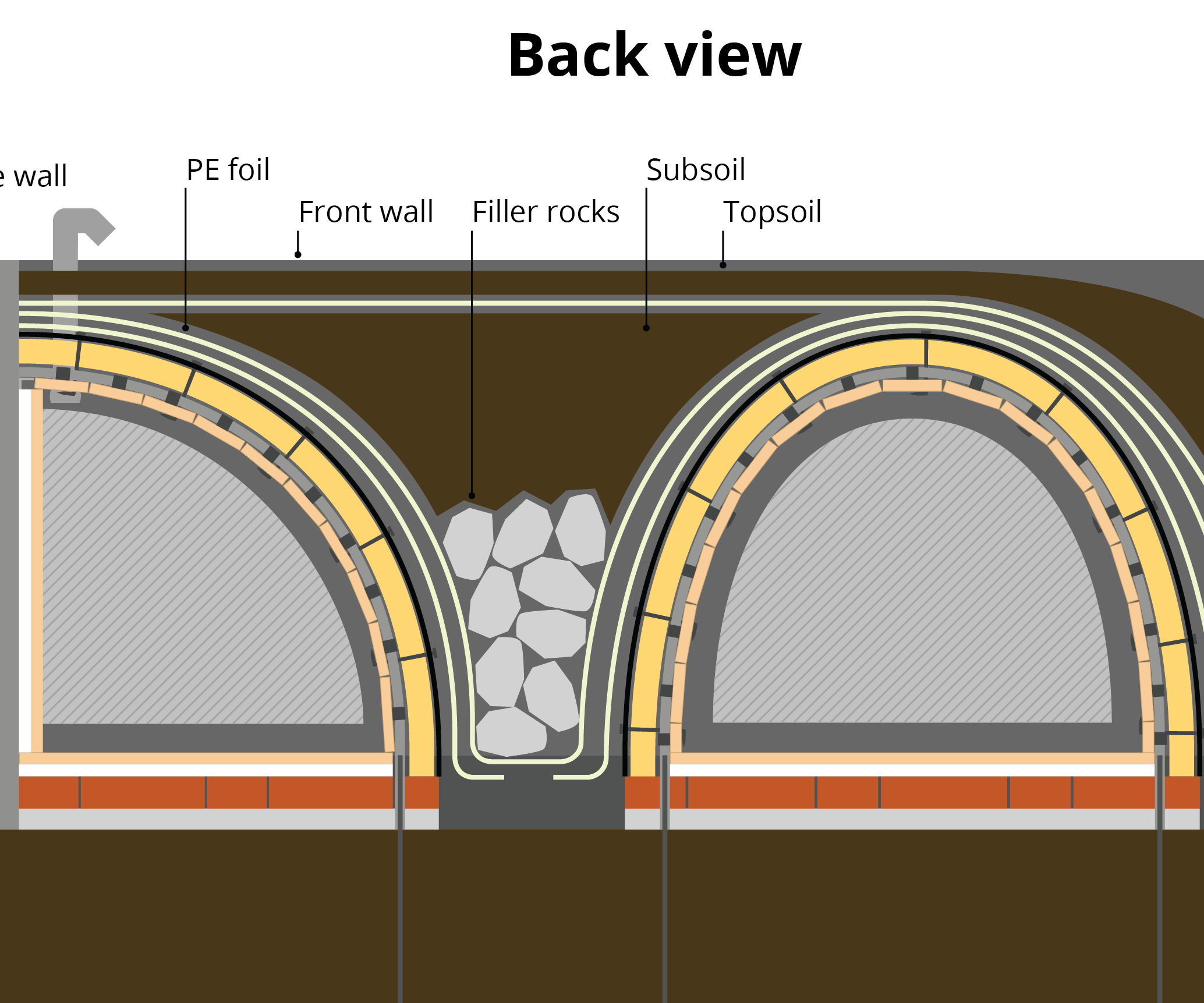

Step 9: The Burial
Before I started piling back the dirt, I’ve put some rocks around the house to make a slope, and put an oversized layer of PE foil to keep out the moisture.
Then I proceeded to pile on the first layer. After the dirt had covered most of the house and made an even gentler slope, I’ve put another layer of PE foil. This will prevent the rainfall from saturating the deeper layers of soil and making the overall weight and pressure on the house lesser by draining the water down the slope and away from the house.
Then came the final layer, about 15cm/6in thick at the top. I would recommend an entire foot if you can, since the soil will get compacted over time.
