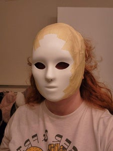

1. Take your tape measure or string and wrap it around your head. Note the measurement or mark your string. You want to blow up your balloon so that the thickest part of it matches the thickest part of your head. I would add an inch or two as the mask will shrink a little during the process.
2. Tape the balloon to the mask.
3. Start layering tape on the mask and balloon. You can decide how far down the balloon you want to go depending on how big you want the mask to be. I usually go about a quarter of the way down the balloon with my tape.
4. Lots and lots of taping. When you think you've finished, add another layer just in case. This is the foundation of your mask.
5. To make the cheeks, stick one end of the tape on the chin of the mask and pull it diagonally towards you cheek. Stick the other end to your cheek. Add another strip of tape to the skin below the first and attach it to the chin. Repeat until the cheeks are covered. Once a thick layer of tape is formed, I was able to painlessly peel the tape off my cheeks. Make sure to use Painter's tape!
6. Pop the balloon and remove it from the mask. Add tape to the inside of the mask to cover the sticky parts.

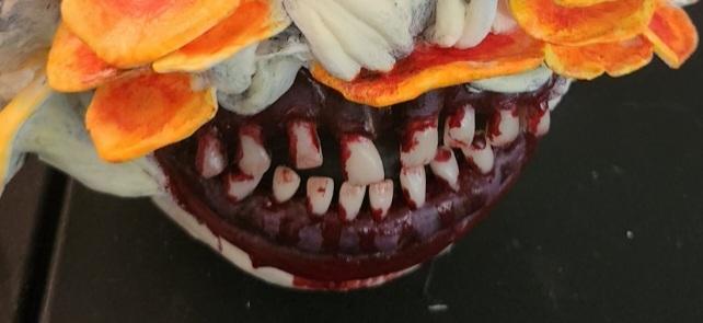

1. I first painted my gums with pink and red paint (pic 1), but that looked all wrong, the gums were too healthy looking.
2. I ended up mixing a lot of purple paint with black paint. I did a base coat of that to the entire gums. I then added a bit of black to my purple mixture to make a darker black purple. Take this color and paint it in the gum grooves between the teeth. This makes the divots look more contrasted to the bulge of the gum. Gives it more of a protruding, dehydrated look.
3. Honestly, if you don't like the look of your gums, you can cover it with blood and saliva.

1. Cut a small piece of translucent bead cord. It should fit between the upper and lower teeth. Put a dollop of glue where you want the saliva to start. Insert the cord into the dollop. Let that solidify for a few minutes.
2. Slowly drip a small amount of E6000 down the cord. It's pretty viscous, it should flow slowly. This is your saliva, add as much or little as you want. I like to drip it down the lips and from the corners of the mouth for a wet look.
3. I have had way more luck with the Citadel Colors than any of red paint, would highly recommend buying some. I used Blood for the Blood God, Blood Angels Red, and Flesh Tearers Red.
4. Drip the paint wherever you want blood. You can also paint the saliva to look like bigger drops of blood or like blood is mixed in (pic 4).
