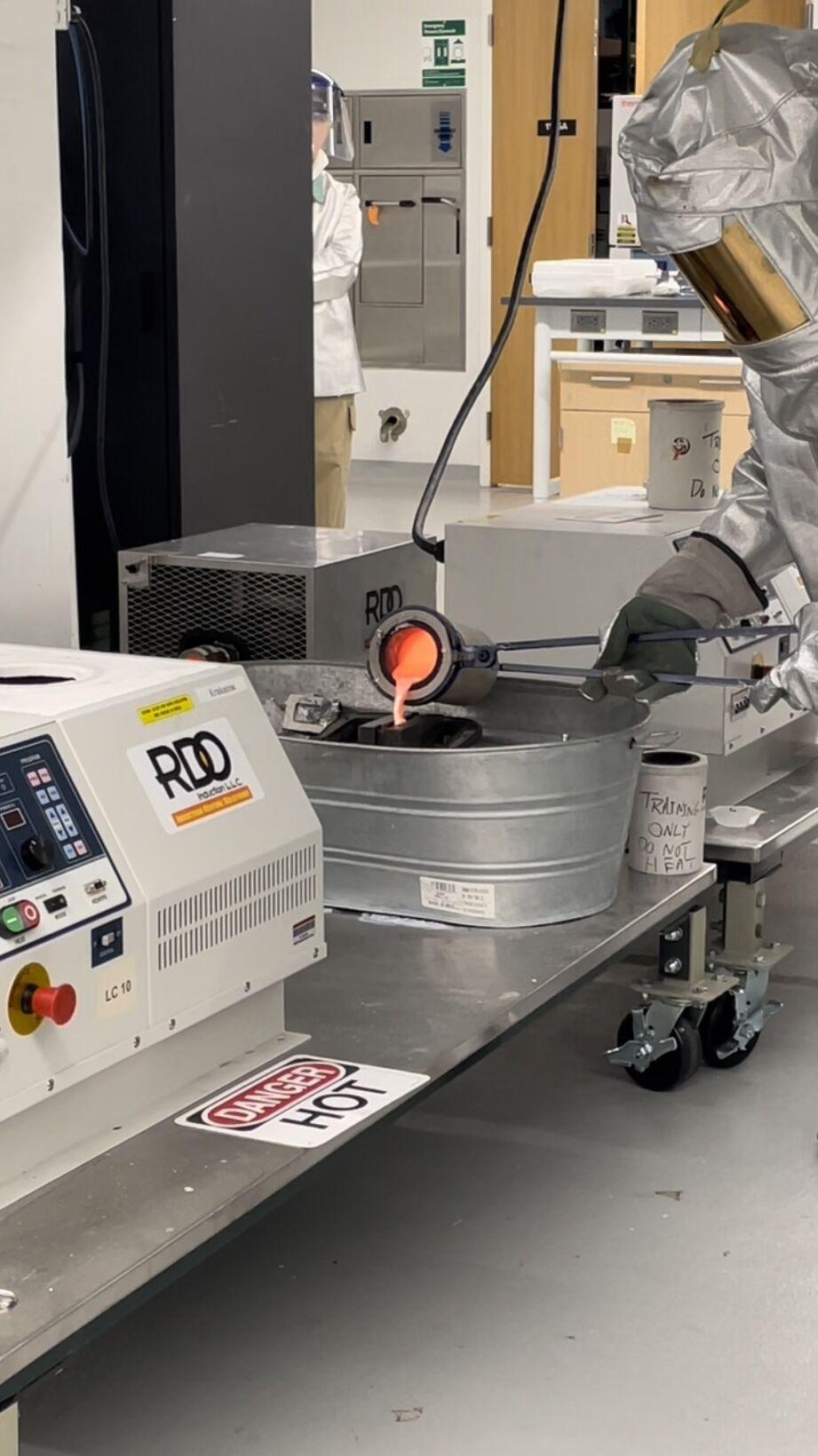

Step 2: Casting
It was calculated how much of each element needed to be added to the 90% aluminum alloy. The elements were weighed out and melted, starting with aluminum. The other elements were stirred to ensure proper mixing before being poured into a preheated mold.

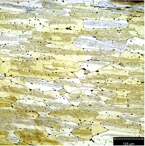

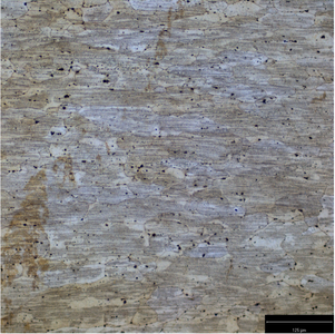

Step 9: Microscopy
The microstructures of the samples were examined with a microscope according to ASTM 883-17 standards. This included the microstructure of an as casted 7475 alloy, a sample homogenized at 510 for a week and annealed for 3 hours, a sample homogenized at 470 for 24 hours and annealed for 3 hours, and a sample homogenized at 510 for a week and annealed for 96 hours, and. Before examination, each sample was etched according to ASTM E407-07 standards. They were examined at 500x and 200x.

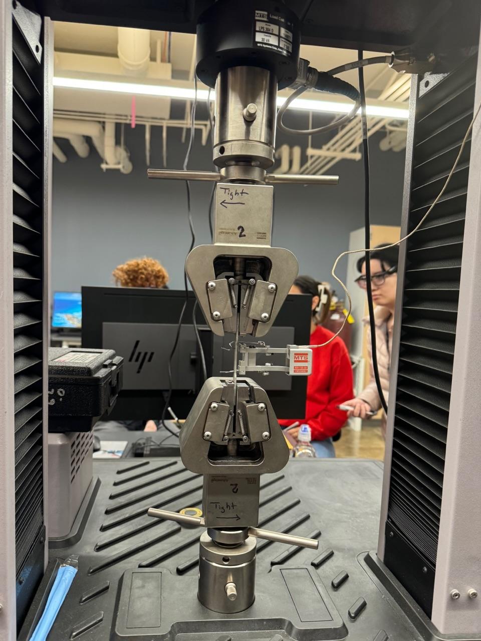

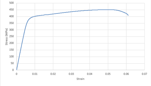

Step 11: Tensile Testing
Each sample was made into tensile bars and were measured for their width and thickness. Each sample had three tensile bars tested for their elongation and yield strength. These values were averaged and compared. The average yield strength and elongation of the tensile bars homogenized at 470 ºC for 24 hours and annealed for 3 hours were 411.61 MPa and 4.5 % respectively. The average yield strength and elongation of the tensile bars homogenized at 510 ºC for 168 hours and annealed for 96 hours were 357.63 MPa and 3.45% respectively. Finally, the average yield strength and elongation of the tensile bars homogenized at 510 ºC for 168 hours and annealed for 3 hours were 386.86 MPa and 4.2%.

The competition sample produced an electrical conductivity of 39% IACS, a yield strength of 389.6 MPa, and an elongation of 6.1%, giving a total score of 686,165.
