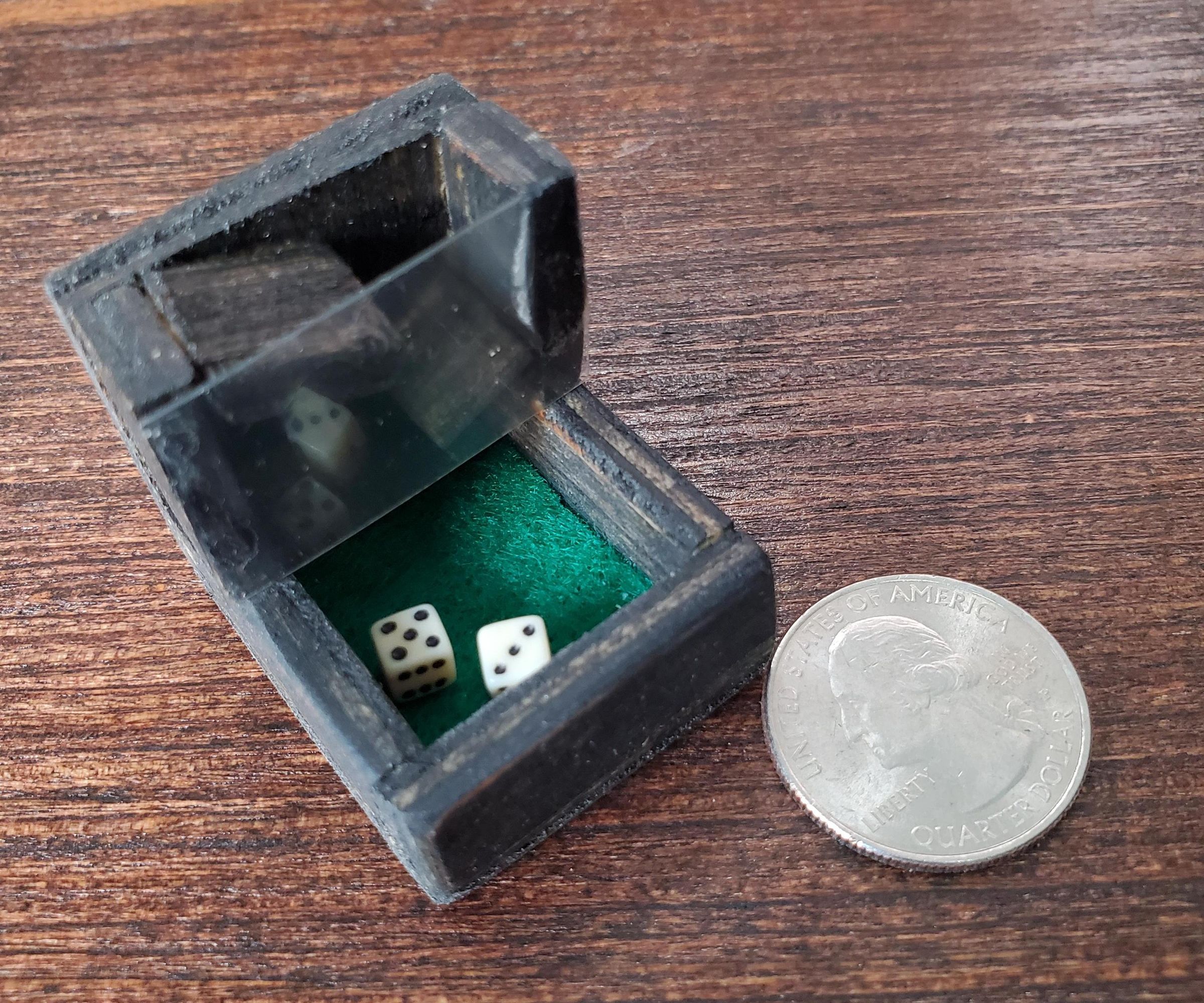

Step 3: Get a Box
I got my box premade at a local craft store. However if you are more crafty at wood working you could just make your own box however you want it. Also note you want your lid and the bottom to be wide enough for dice to roll freely. In my case my boxes lid wasn't going to work so I just got 2 of the boxes and put 2 bottoms together.
Step 4: Space It All Out
The interior of my box was 7.5 in x 4.75 x 1.25 in deep (this is just one side so I have this x 2). Meaning all my spaces and pieces needed to fit into that. For me since this was originally just a dice box I wanted to be able to fit all my dice into it so in my case I had 3 sets of dice so I wanted enough to hold 3 sets of dice, as well as a place for a pencil, and can't forget a rolling area.

The first image is the first platform for the dice to go down it's just a small rectangle about 4 inches long with a 15° angle cut in it.
The second image is the next area the dice will hit basically is just a 45° angle cut off the corner of a 2x4
The third and fourth image I really have to give credit to my friend because it was his soul to get the dice where we want them and without this piece I don't think the tower would work at all. basically what he did was measure the remaining space left on the bottom of the lid (the same size space as what later will be the rolling area) on 2x2 then long ways made a 45° cut then another 45° cut short ways.
In the end it should all fit in the lid like image 5.
He also went in and trimmed the thickness of the pieces down so the Plexi glass would fit snug in the box when it was closed.
I'm just going to pause here to say thank you to him, really with out these pieces this would never have turned out as well as it did.

Step 8: Fixing a Future Problem
one problem I saw from there get go I needed a way to have the box open at a 90° angle. I thought of a lot of solutions like perhaps a chain, perhaps a moveable kick stand, learn telepathy, or even trying to limit the hinge on how it opens.
What a came up with was cutting a piece of square dowel to attach to the bottom half in the back. I did try and cut it just a hair shorter than the box so it didn't interfere with the hinge. I also wanted the exposed edges.

Now with the gluing, I was lucky enough to think to have my friend cut spacers for the dice compartments. In the future I would probably make the spacers about an inch shorter than the compartments just to avoid the pieces from getting stuck after the gluing. Basically all I did was put penny down to try and raise it up a bit to avoid from the glue getting stuck to the spacers. (not sure how much this helped) I put a thin layer on each edge (not the top) basically just put a spacer then a wall, spacer wall and so on then. Get the long piece and put it in with a clamp to hold it in let it sit for the time suggested for your glue.
The lid is self explanatory but the first platform you want to make sure there is enough space for a dice to roll down.
Also don't forget to clamp on the back kick stands.
After I allowed time for it to all dry I noticed the dice walls were preventing the box from closing properly, so I took the whole bottom half and sanded it down. Just take your time and make sure just to sand enough so the box closed well.

Step 11: Plexiglass Cutting
My plexiglass came with a plastic sheet on both sides I kept one side on to draw on. What ever shape you want to do that works best for your box. When I originally cut my holes I the dice some times got caught on the exit so I extended it a bit.(a bit too much the dice can now transfer from the third hole to the rolling field or even the lid. A minor inconvenience that I can live with)
Next I drilled some holes to attach the plexiglass with screws. I took a dry erase markers to mark where I wanted to put the holes. You want to make sure to pre drill the holes as to not break the glass, or split the wood just go at a show speed.
Now would also be a good time to clean the glass of any finger prints or saw dust it may be hard to do later.
Also note the spacing for the screws that they don't interfere with the deviders I had to move mine for one.

Step 12: Adding Magnets
I decided instead if a latch (that I couldn't find one I liked) I would use magnets. My magnets were .25 inch so I used that drill bit. A good tip is hold your magnet at the bottom and put a piece of tape above it, that way when you drill your holes you know when to stop.
Another tip I have is take 2 magnets let them attach and put a mark on each side the side with the mark will go face down in the hole with the glue. Get a good dab of glue and put it in the hole then the magnet on top. Make sure to clean any extra glue.
Step 13: Felt Placement
The felt is completely optional I just opted to do so to cover my less than perfect stain job. All my compartments were the same height so I just measured and cut out for a piece for each spot. Then cut one for the pencil compartment.
Next is gluing the felt down. Put a fair amount of glue in each compartment. (I'd do one at a time) I like to spread it out with my finger just to give it a good even coat. Make sure not to put too much or it may result in a wrinkled finish.
