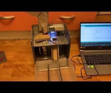

Step 4: Finished!!!
This is the project that's reformed from the original one on Arduino official website. What I did is that I changed add more functions to the rfid machine. Instead of just turn on the PC, I make it can help you open some website that you need, also if your have some websites that need your to insert username and password. You can use my codes too.
