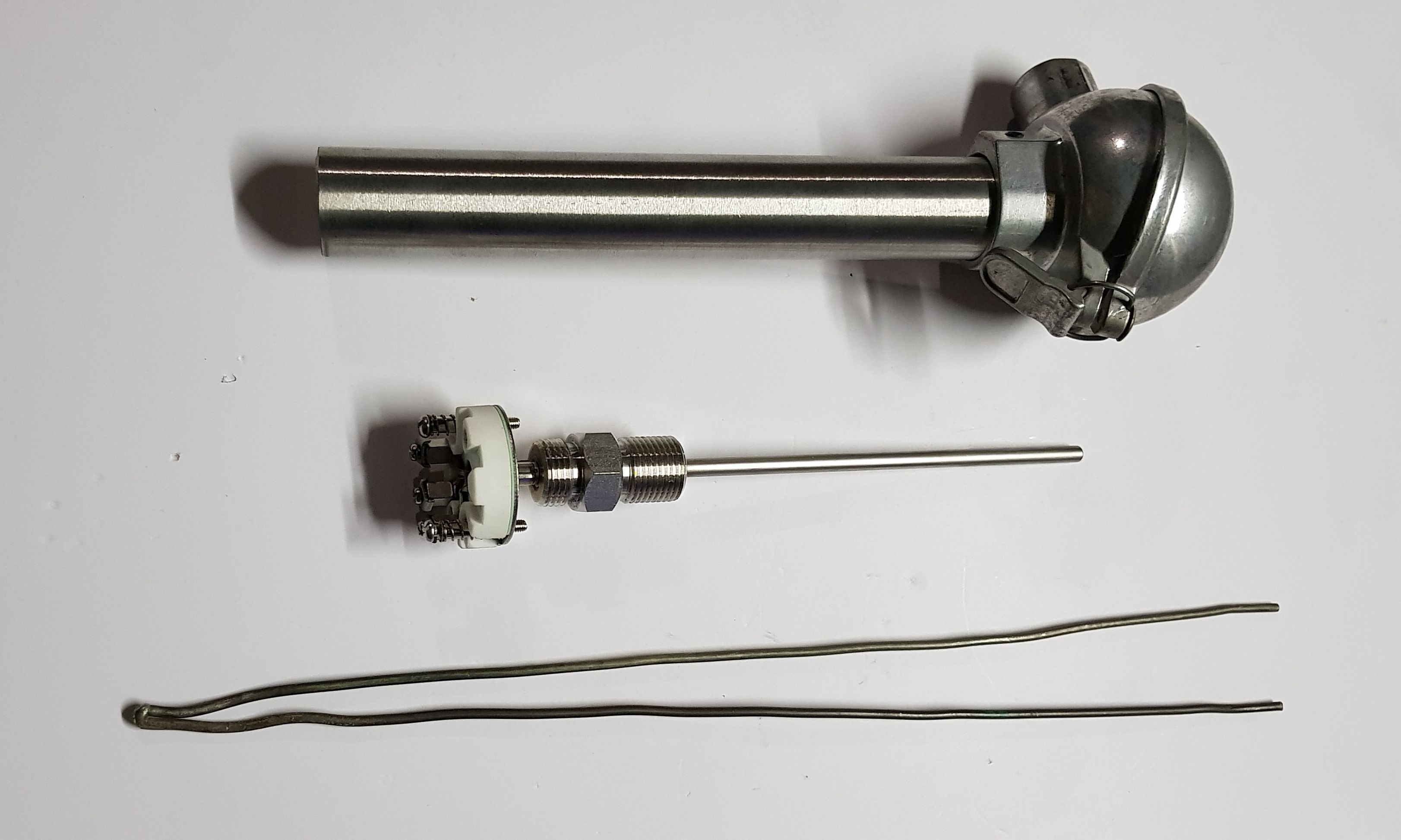

1. Broken industrial thermocouple: You can reuse any broken thermocouple parts as picture below:

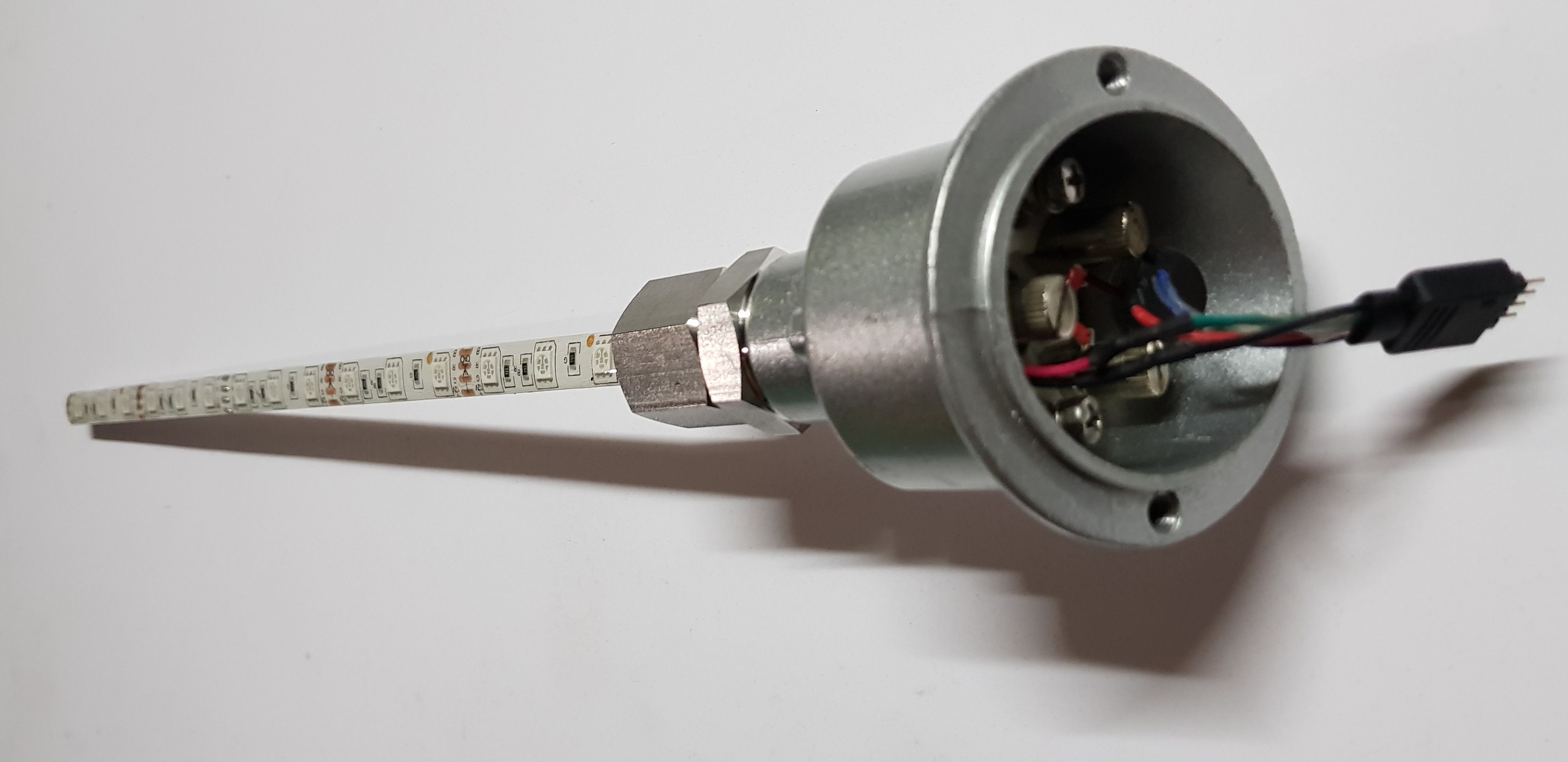

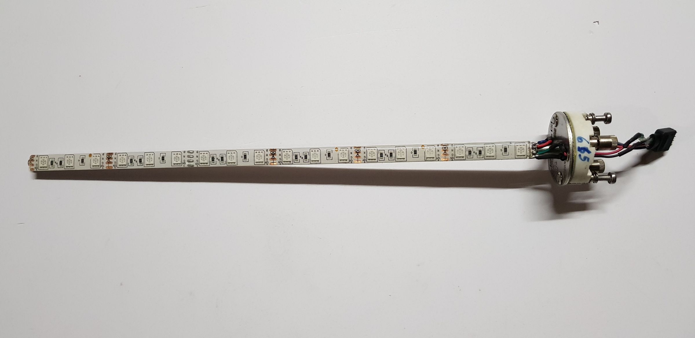

Normally, it has 2 holes on thermocouple transmitter and I threaded four cables through two holes then soldered them to the led strip.
Fixed them into thermocouple head and led strip is glued to thermocouple rod.

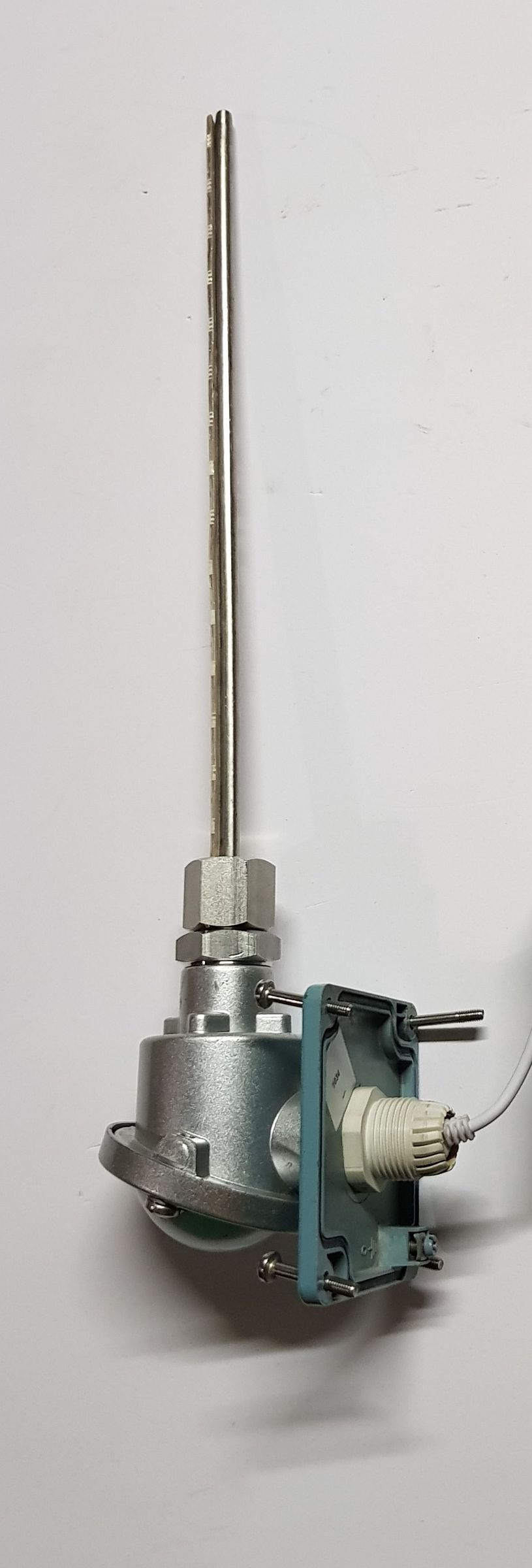

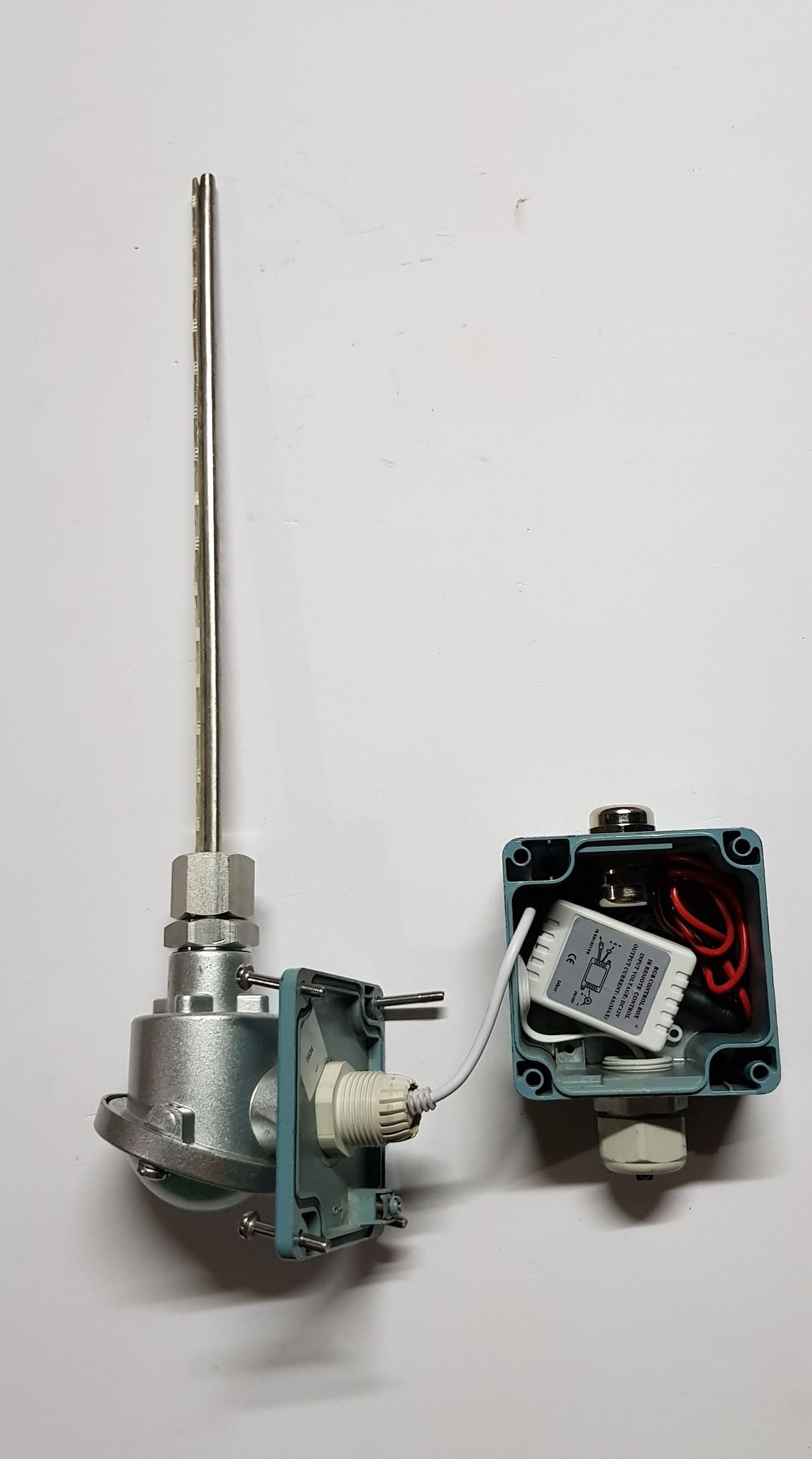

Step 3: Local Box Assembly

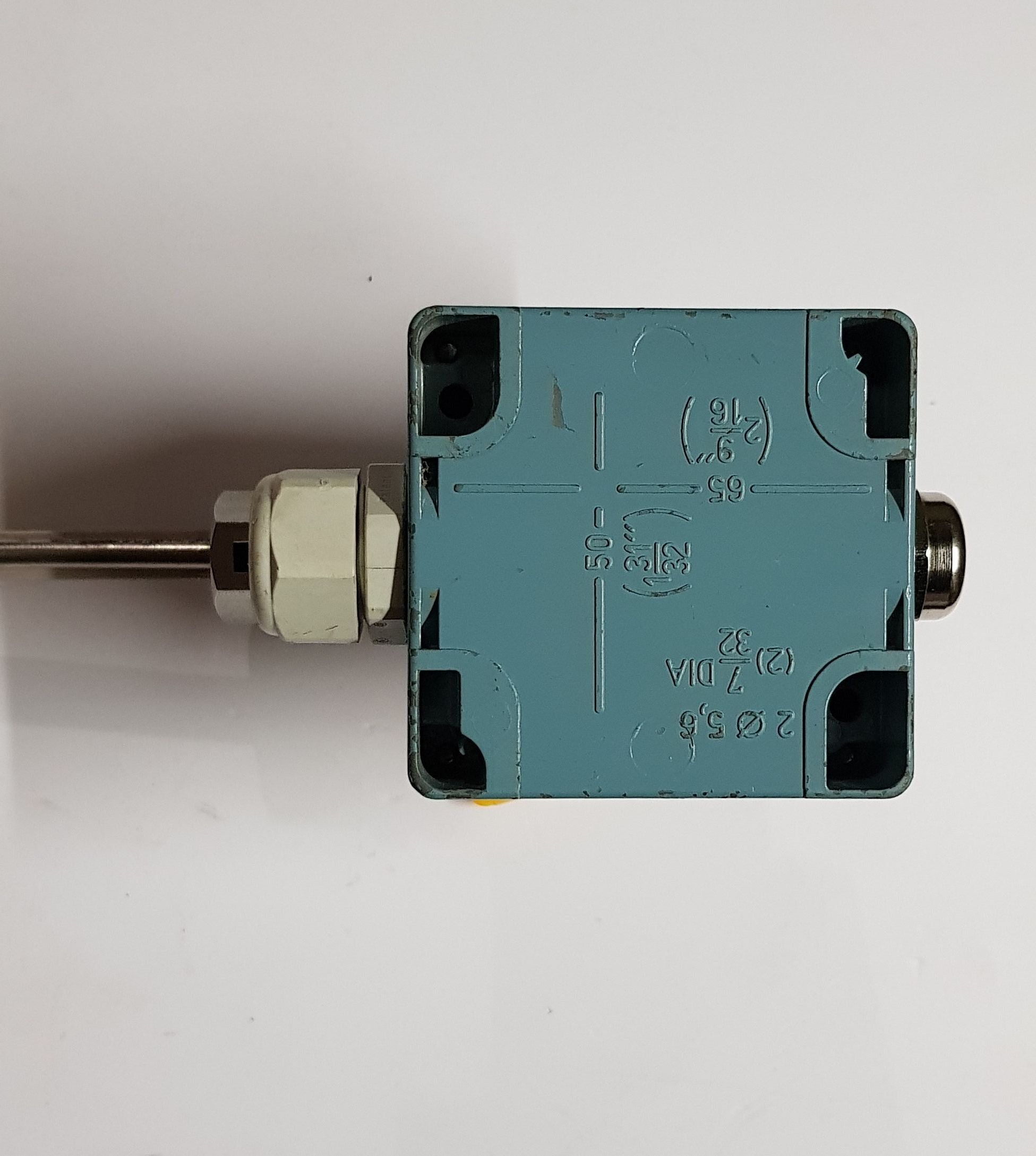

With this local box, it totally has 3 holes:
- Top hole: usually it will be used for Ø 22 mm control and signaling units. We use this hole to connect thermocouple.

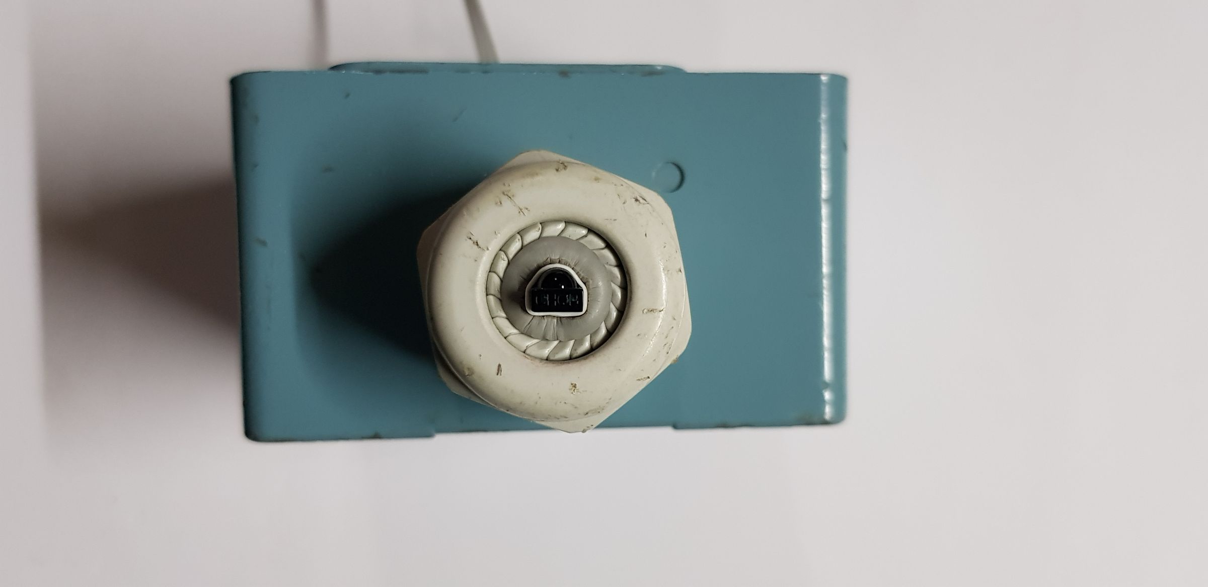

- One side hole: we use cable gland 20 mm to grip the IR led.

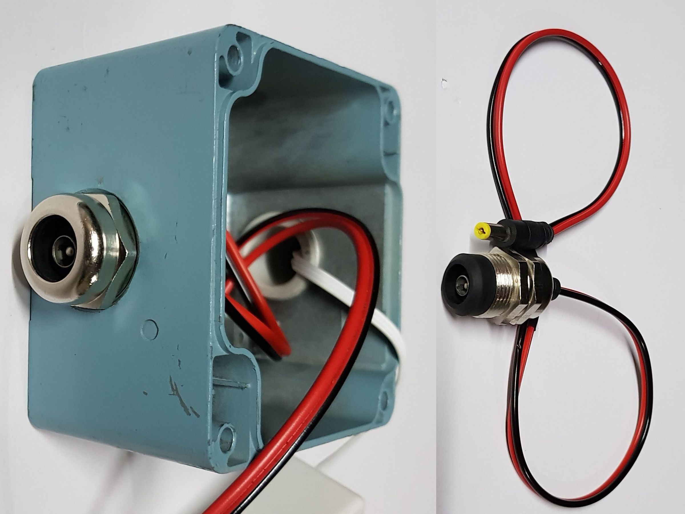

- The other side hole: we use cable gland 20 mm to grip female 12VDC power plug after soldering male & female power plug together.
Connect all part together & put remote control receiver into local box.
Finally, all parts fit together and look very firm.

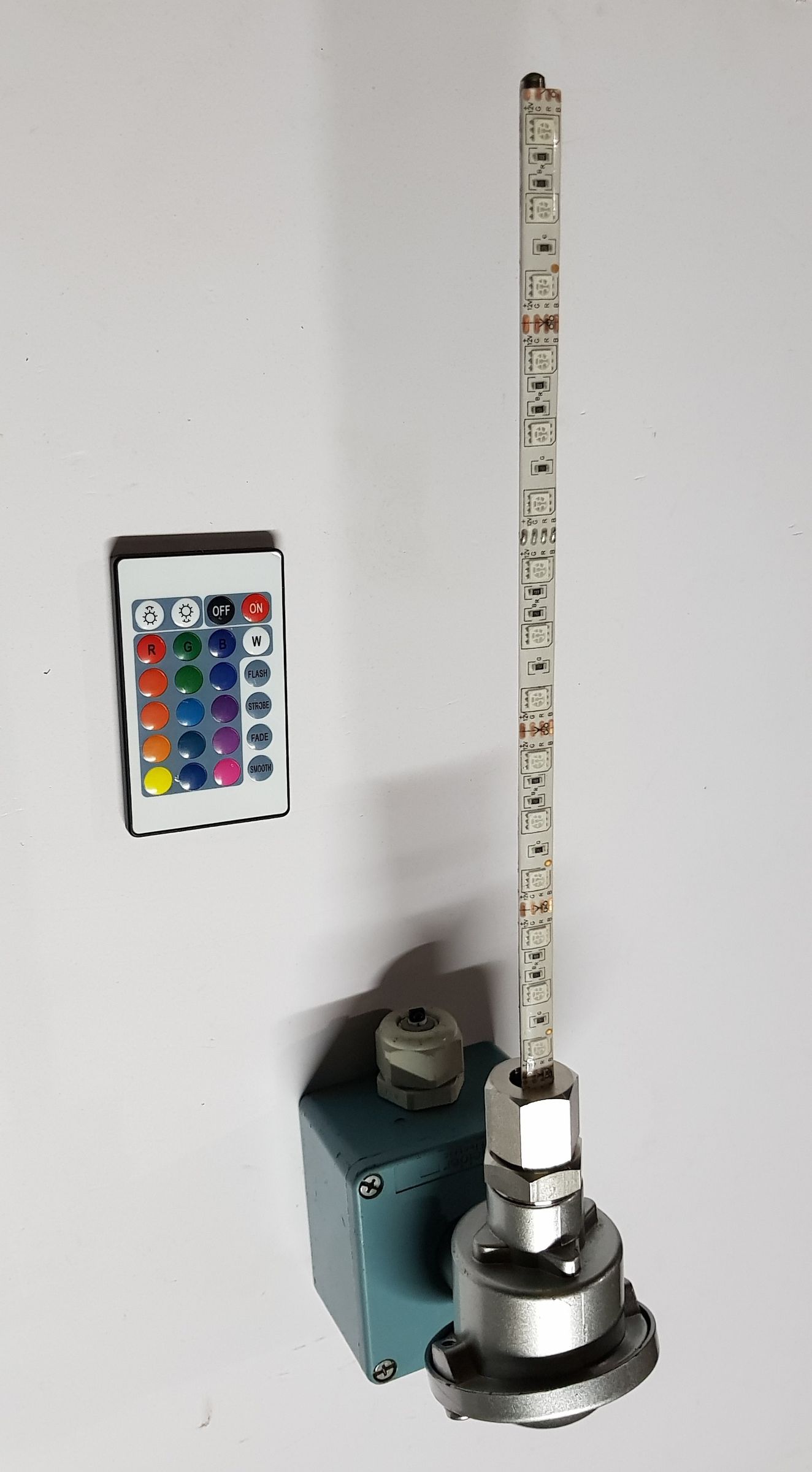

Step 4: Finish
We can put thermocouple LED on the table or mount back side of local box on the wall.
Of course, we can control thermocouple LED by IR remote with some colors and effects.
