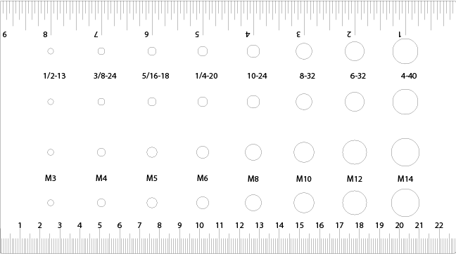

I know, I know, you can buy these. I wanted to make my own thread ID tool with all the nuts and screws I most commonly use for projects. This one has metric and imperial with rulers on each side so I can measure length as well.

The STL files are 3D print ready, so feel free to use them if you want the exact same nuts and screws that I used. The graphic files have the ruler and label graphics that you can print out and stick to the top of the tester.
Step 4: Assembly
The assembly is pretty straightforward. The screws go through the holes in order the nuts go in the nut pockets, and the laser etched graphic panel is glued to the top with E-6000.
