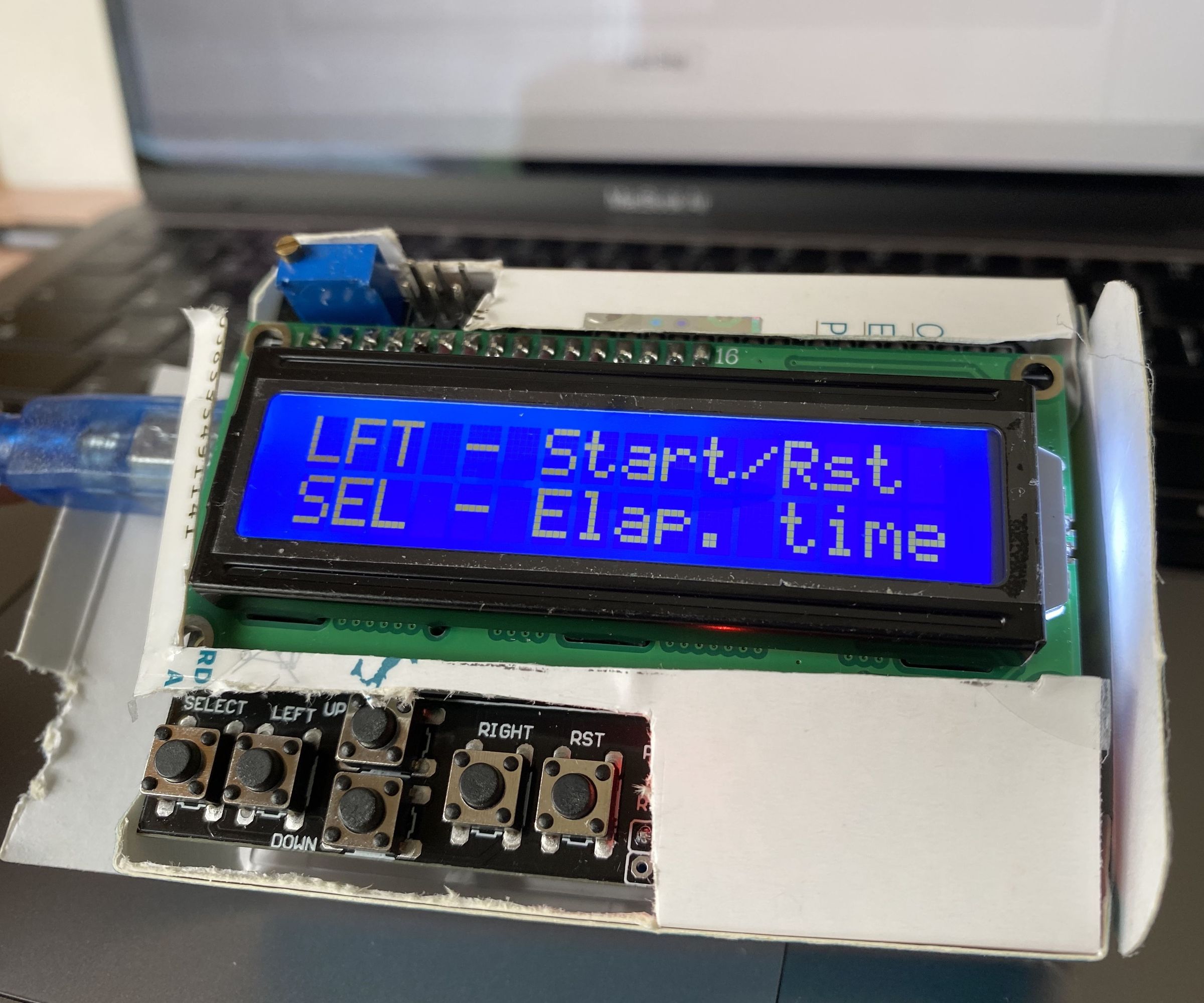

Introduction: Time Restrictor
It's very easy for a lot of us to get off-task during work. And you might set a time, let's say 5 minutes of video or games for a little break, and then you go back to work. But most of the time, you definitely watch more than 5 minutes or even half an hour, like I always do. This instructable is a countdown timer that automatically switches your computer page when the time is up, so that it forces you to go back to work. If you try to switch back to the "entertaining page", it will still force to switch back unless you reset the timer or unplug the power. The 2 things you would be changing will be the time you want to countdown (where to change is noted in the code) and the key you want to press. For example, if your working page is at the right of your entertaining page (video, games, shopping, etc.), you set the pressed key with Ctrl and right arrow key(if you're using Mac).

Step 2: Connecting LCD Display
Connect the LCD display to the Arduino board with the four jumper wire (male to female). Counting from up to down, the orders are negative charge, positive charge, SDA, SCL, as shown in the chart.
2 things to notice here, SDA pin and SCL pin are also D2 and D3, so try to avoid using these 2 pins(D2 and D3). Also, the reverse polarity here would burn up the chip, so make sure you double-check the polarity before connecting to power.
Step 3: Connecting D4 Pin
Use the jumper wire (male to male) to connect the D4 pin and GND pin(negative charge).

Step 7: Upload Your Code
Plug the USB cable to the Arduino board and your computer, and upload your code. (You might need an adaptor for Mac)
