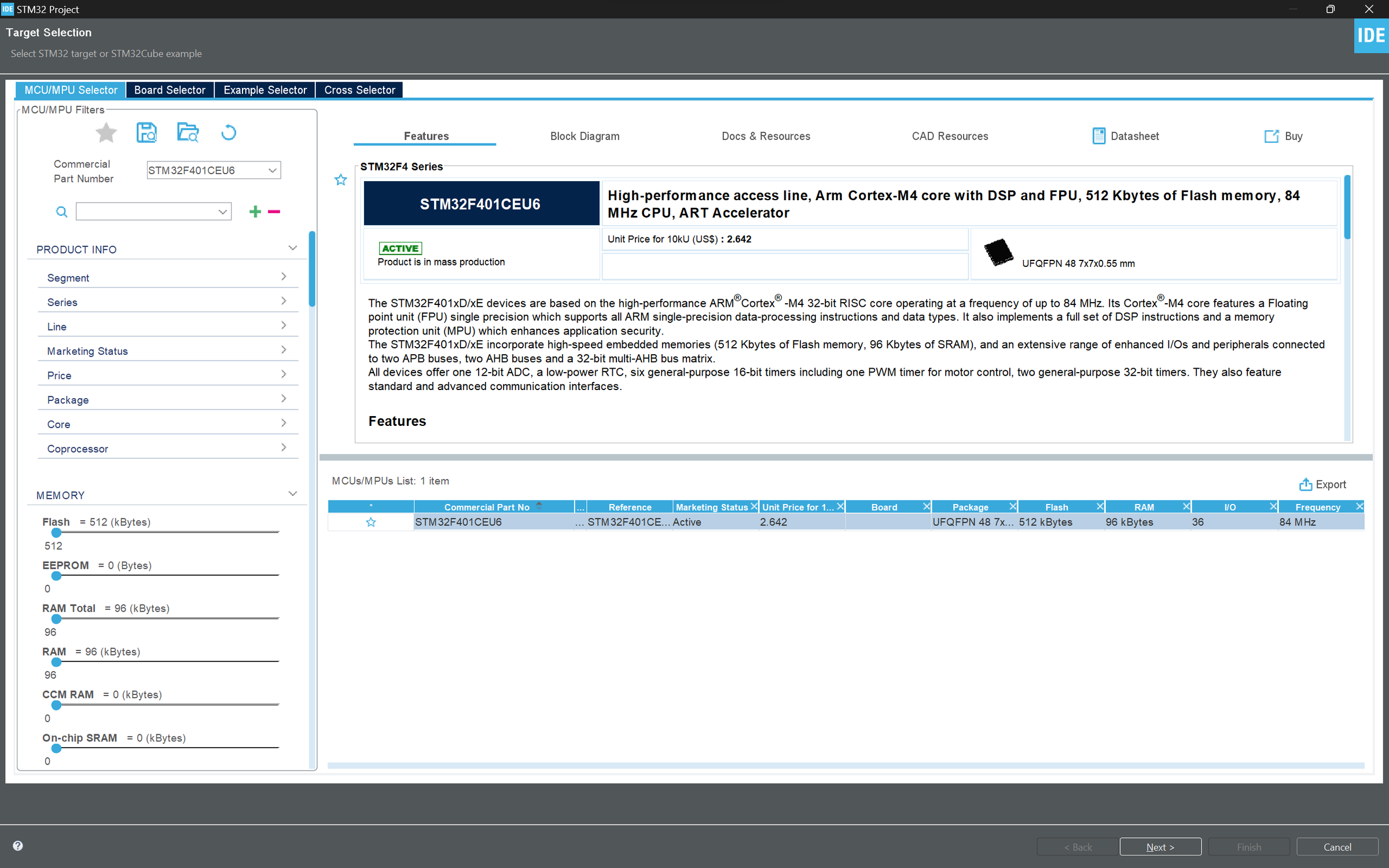

Step 2: Configure Your STM Cube IDE
We will use STM32Cube IDE to program our STM32 board. Open the IDE and head over to a new project.
Then for the target selection, specify the STM32 Black Pill board number. After that click on any column as shown in the picture below. Then click the ‘Next’ button.

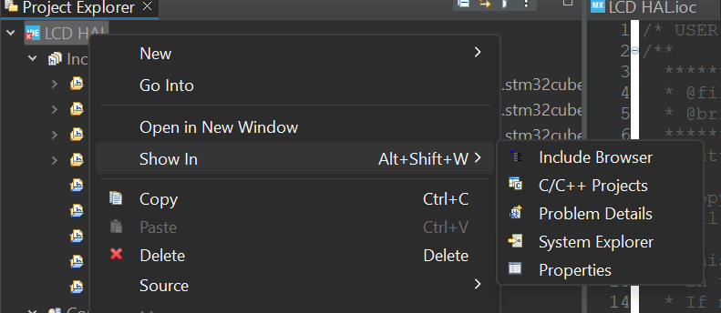

Step 8: Opening the .elf File Created in System Explorer
Right click on the project and click on show in system explorer and copy its path

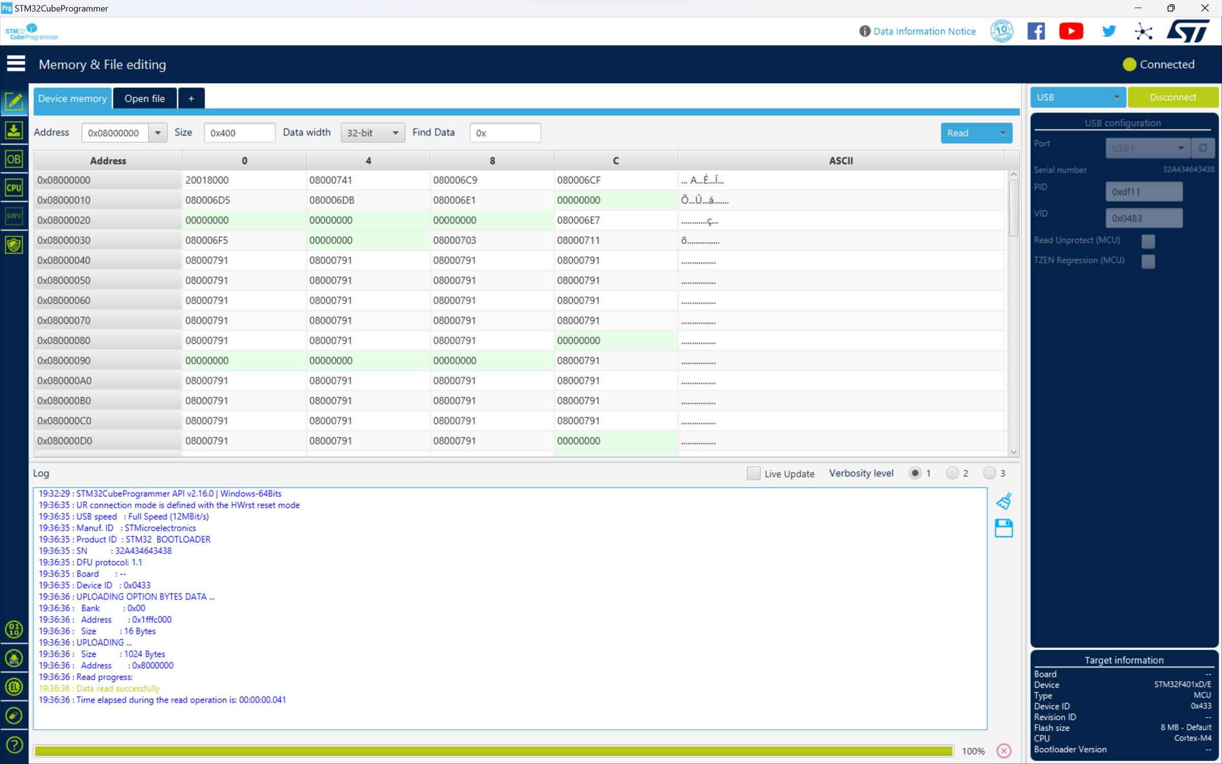

Step 9:
Step 9: Open STMCubeProgrammer and Connect to STM Board Via USB

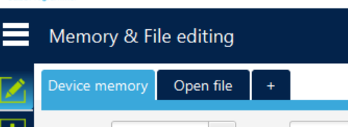

Step 10:
Step 10: Click on Open File and Paste the Copied Path

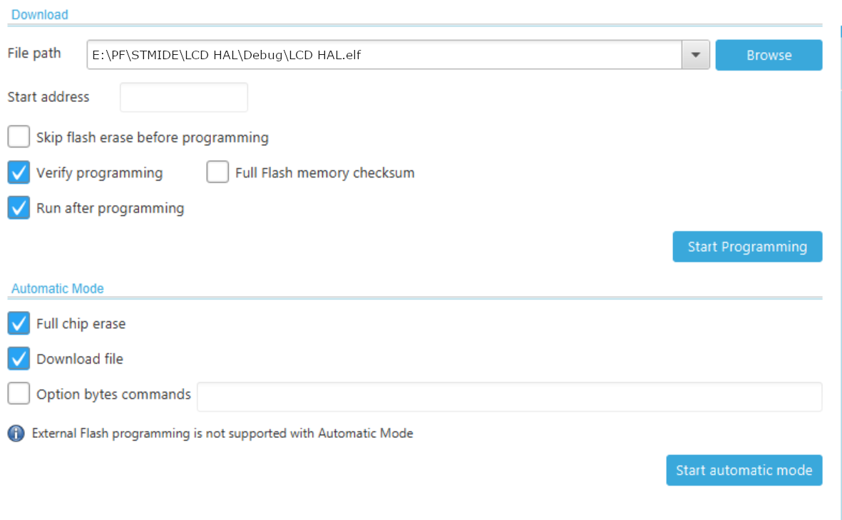

Step 11:
Step 11: Go to Download Options (Found in Toolbar on the Left)
Step 12:
Step 12: Change Download Options and Click on "Start Automatic Mode"
Step 13:
