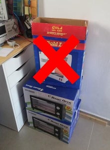

The first problem that I struggled with was to find a small toaster oven with controllable heating elements. In my country most of the small toasters have two elements in series. This means that each element is for 110V (problem ☹). I watched a video of making a reflow oven with Controleo3 and 220V oven: https://www.youtube.com/watch?v=8IZIGu6rKEs&ab_channel=nihtila.com
But I thought that there would be a lot of metal work, which I didn’t want to do.
So, I tried to hack it by buying one small standard toaster oven and one small portable infrared heater. The purpose was to use the heating elements from the infrared heater for the toaster oven.
Long story short: NEVER MAKE THIS MISTAKE! 🥵
This was a bad idea🤬, a total waste of time and a lot of cuts in my hands from the heater opening. The heating elements were too short and had a different diameter, which made it difficult to install them inside the oven.
So, the only available option that remained was to roll up my sleeves and start working.
I bought the second oven to make one reflow oven from two similar toaster ovens.

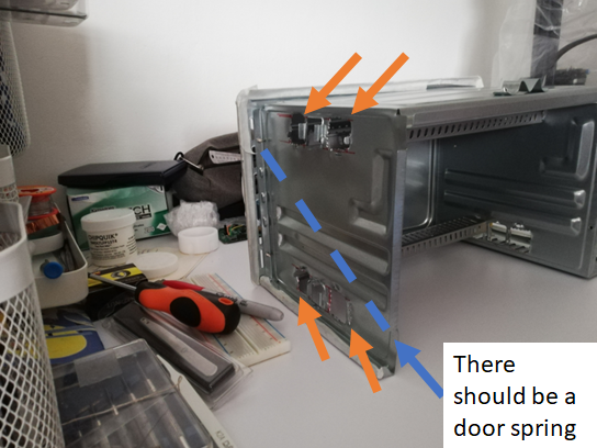

Step 2: Cut Holes for the Heating Elements
The reason that you need to do this is because you want full control over the top and bottom elements. Since each heating element is designed for 110V, you need two heating elements on the top and two heating elements on the bottom in series so you will be able safely to plug in 220V.
WARNING! If you don’t fully understand the right electrical connection, consult with a professional. It is high voltage and may be dangerous!
Remove the front and the back oven panels before the metal work.
I used an electrical screwdriver with 2.5 mm drill to make holes in the perimeter of the rectangular shape for the heating element installation (8 openings in total). After I did it, I understood that it may be easier to make these openings using a Dremel tool.
When you decide to make the openings, pay attention to the fact that many ovens have a door spring that is located on the side of the oven, as shown in the picture above (marked by the blue line). So, place your opening on the side walls in such way that you will be able to install this spring afterwards.
Don’t forget to install the covering metal shields for the heating element at this stage for both top and bottom element. These shields are required for good reflows as they prevent hot spots during the heating process. In addition, these shields will prevent you from breaking the heating elements during the insulation placement.
