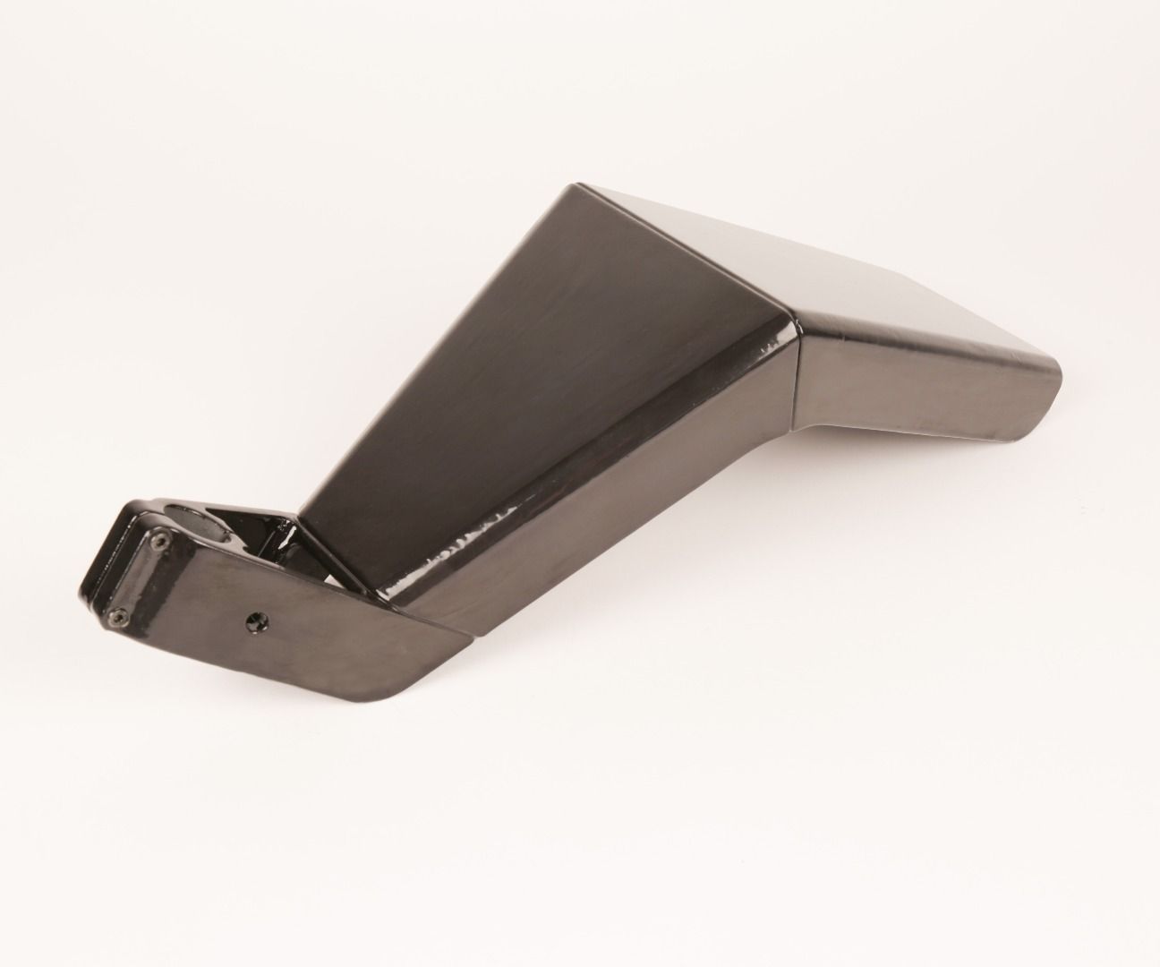

Throughout this class, you'll learn about large-scale design, multi-part assembly, and finishing with the Bike Fender project.

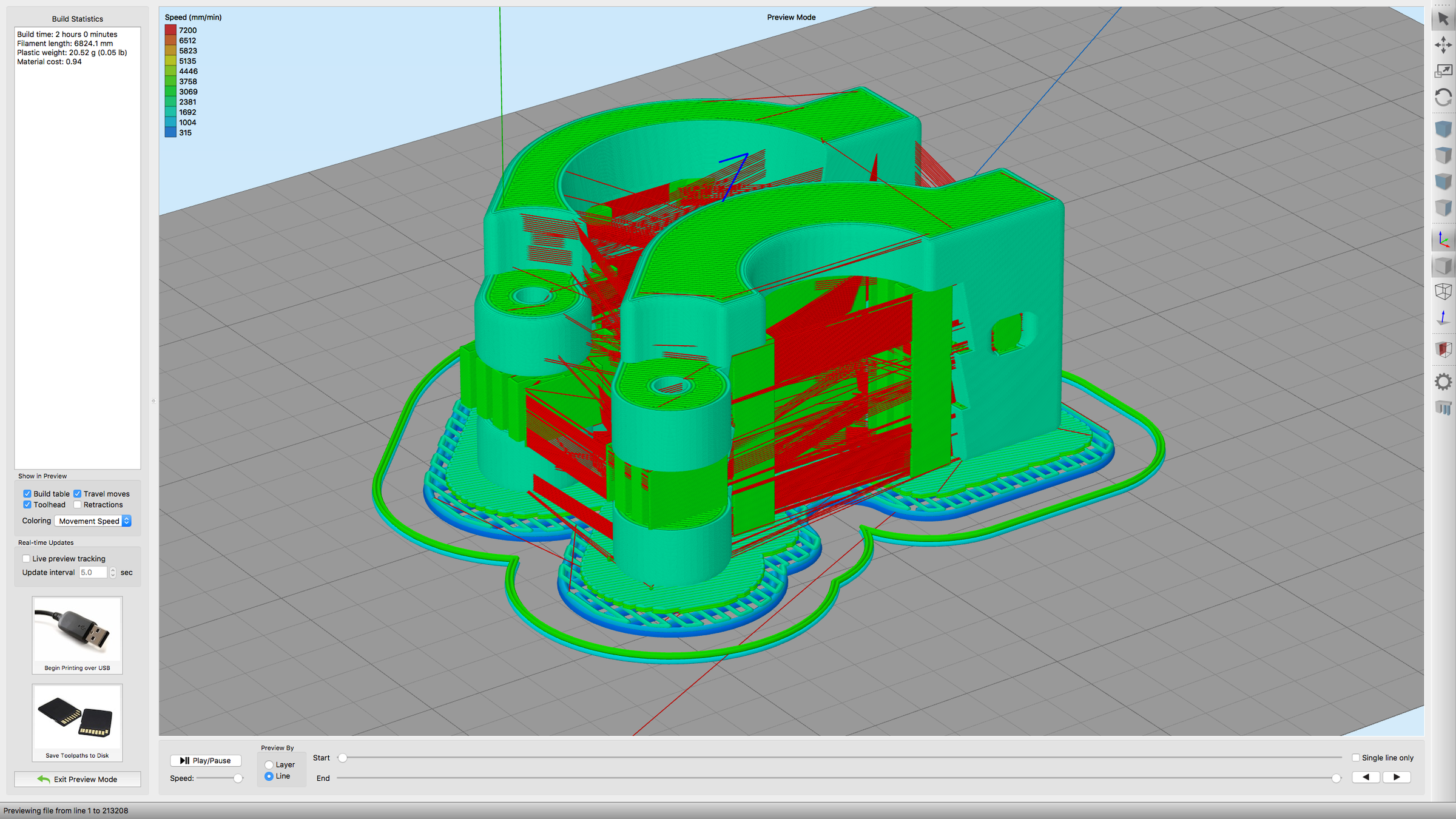

Simplify 3D: Advanced Slicing + Control Software ($150)
This slicing software has an amazing amount of control and superior support structures, which are very important for objects with overhangs. I've had outstanding results with this program. You can also run a 3D printer with this program if the printer doesn't have an on-board computer.

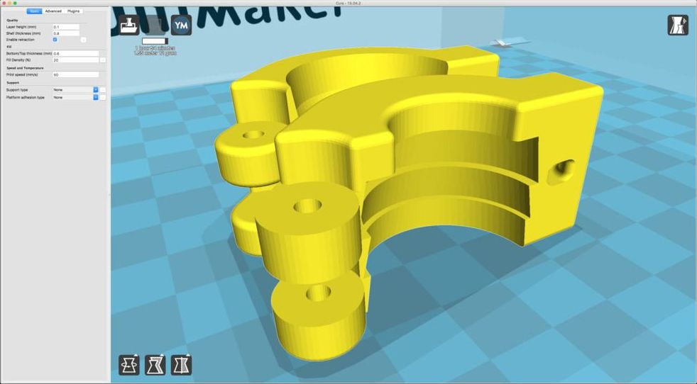

Cura: Advanced Slicing + Control Software (Free)
I've never used it, but a lot of students have said it's a good, free alternative to Simplify 3D. It has superior support structures, which are very important for objects with overhangs and some more advanced settings than Simplify 3D. You can also run a 3D printer with this program if the printer doesn't have an on-board computer.

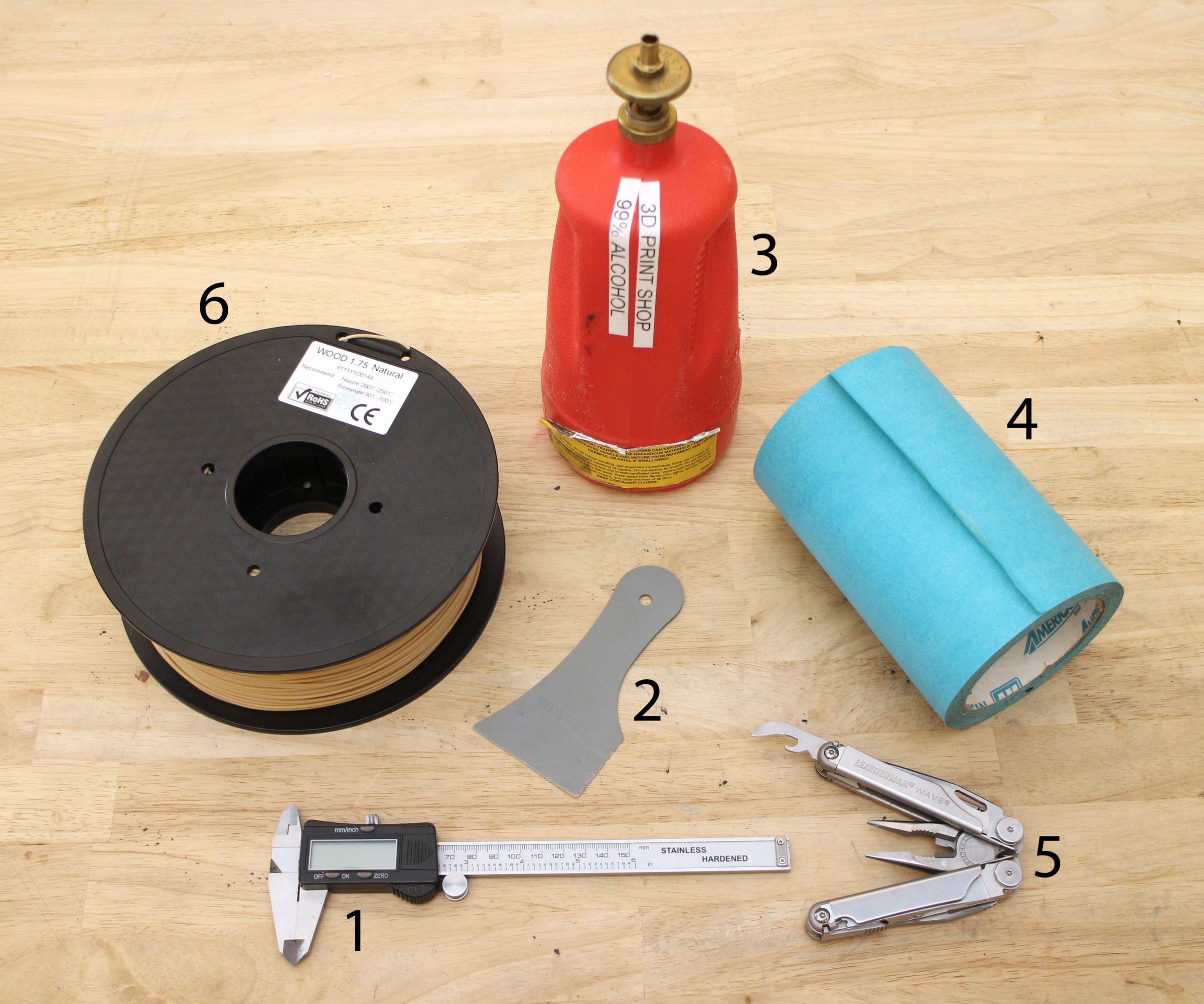

1. Calipers ($17): Calipers are the tape measure of small-scale design. This handy tool will make it easy to measure tight spaces, curved objects, and all kinds of unusual shapes.
2. Plastic Putty Knife ($7): Getting printed parts off of the build platform can be tricky. This handy tool works like a spatula that will help you remove the part without damaging it or the bed.
3. Isopropyl Alcohol ($7): Filament has to stick to the build platform. Oil from your fingers keeps it from sticking. Solution: rubbing alcohol! Add cleaning a 3D printer build platform to its endless list of other uses.
4. 6" Painter's Tape ($30): Save your build platform, your money, and your sanity by buying some 6" painter's tape to cover your build platform. It's a great surface for the filament to stick to and it's cheap, so you can replace it when it gets too rough.
5. Multi-Tool with a Can Opener ($77): No self-respecting maker leaves home without a Leatherman multi-tool. I mostly use the can opener to clean out support structures (more on that later), but I find myself using it quite a lot throughout the process.
6. 3D Printer Filament (varies): Filament is the spooled plastic material that gets extruded into a 3D object. There is a wide array of options for the material, but for this class we'll stick to 1.75mm PLA, which is the best option for the Dremel Idea Builder.
