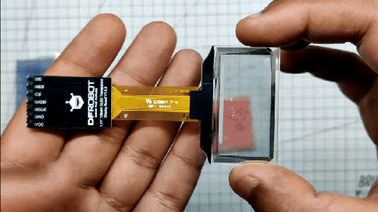

Step 1: 1.51” SSD1309 Transparent Monochrome OLED Display
Here's something really cool: a convector module-based Transparent monochrome OLED display based on the SSD1309. The compact converter has two available connections for convenience: GDI and SPI.
This Display adopts SPI communication with an onboard GDI interface, which greatly reduces the wiring complexity as there's just one Flex PCB that is connected to the converter module.
Below are its specifications
  • Screen Interface: 8-bit 68xx/80xx Parallel, 3-/4-wire SPI, 12C
  • Adapter Interface: SPI, GDI
  • Adapter Size: 18 x 28mm/0.71 x 1.10inch
  • Working Voltage: 3.3V
  • View Angle: full view
  • Driver Chip: SSD1309
  • Display Color: blue
  • Display Area: 35.05 x 15.32 (mm)/1.40 x 0.60inch
  • Pixel Pitch: 0.274 x 0.274mm
  • Pixel Size: 0.254 x 0.254mm
  • Screen Size: 41.92x27.08mm/1.65 x 1.07inch
  • The fully transparent region resolution :128*56
  • Working Temperature: -40~70 ℃
This Display has a Wiki Page that is well documented; if you need more in-depth information about this play, check out its wiki page.

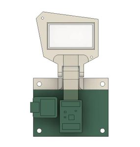

The idea behind this is straightforward: Transparent OLEDs do not come with screen protectors or holders, which are essential during prototyping. We can either add them to a breadboard and take extra care around them, or we can create a test bench or board with a screen holder and a specific MCU for controlling the display, as I did in this project.
In order to construct the converter module with an OLED display, we first model everything in Fusion360 and create a PCB on which to mount the XIAO M0 board.
Next, we create a screen holder modeled after the screen and construct it in two pieces, allowing us to rotate the display and alter the viewing angle.
Also, the modeled holder is connected to the PCB.
After the model is complete, we start the PCB design process.
When it comes to 3D parts, we exported the Screen holder assembly, which consists of three files in total: the Screen holder, Screen holder lid, and Screen holder pcb connector part.
All three parts were made using Yellow PLA on my Ender 3 printer with an infill of 20%, a nozzle of 0.6 mm, and a 0.2mm layer height.

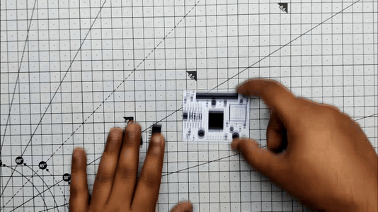

Step 3: PCB Design
PCB Design of this board is actually super simple, XIAO M0 is connected with the OLED Display's Breakout board with below pinout.
  • VCC of Breakout board is connected with 3V of XIAO
  • GND to GND
  • CK is connected to D8 of XIAO
  • SI is connected to D10
  • CS is connected to D1
  • RT is connected to D2
  • DC is connected to D0
Making the aforementioned connections in schematic allows us to open the project's 3D model and export the PCB's DWG file, which we then utilize in PCB Cad software to create the board's PCB outline.
We place XIAO on one side and the breakout board at the bottom, facing the middle.
Four Holes were added on the PCB, which will be used to connect the display holder and add PCB standoffs.

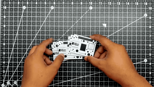

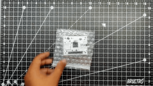

Step 4: Seeed Fusion Service
The final PCB was sent to SEEED Studio for samples.
An order was placed for a White solder mask with Black silkscreen, and the PCBs arrived in less than a week, which was super fast.
The quality was very good considering the price, which was also pretty low.
Seeed Fusion one-stop shop offers one-stop prototyping for PCB manufacture and PCB assembly, and as a result, they produce superior quality PCBs and Fast Turnkey PCBA within 7 working days.
Seeed Studio Fusion PCB Assembly Service takes care of the entire fabrication process, from PCB manufacturing and parts sourcing to assembly and testing services, so you can be sure they are getting a quality product.
After gauging market interest and verifying a working prototype, Seeed Propagate Service can help you bring the product to market with professional guidance and a strong network of connections.

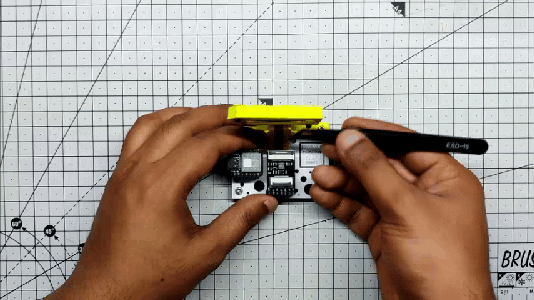

Step 5: PCB Assembly
  • Three CON7 Female header pins were added throughout the PCB assembly process, first in the XIAO Footprint and then on the converter board's footprint.
  • The PCB assembly was then finished by using a normal soldering iron to solder connector pads.

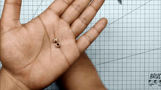

Step 6: Threaded Insert Process
A vital step in this procedure is adding threaded inserts to the 3D-printed screen PCB holder, which will retain the upper screen holder and be movable. The threaded inserts must go inside the part to keep the bolt in place while allowing for easy movement of the part.
  • For each side, we use a pair of M3 threaded inserts, and to attach them to the 3D part, we must lower the soldering iron's temperature to the bare minimum, which for me was 270 degrees.
  • The insert is placed above the hole using a tweezer, and then iron is placed on it to melt the brass. After giving the insert a small push, the insert will fall into position.
  • On the other side, we repeat this process.

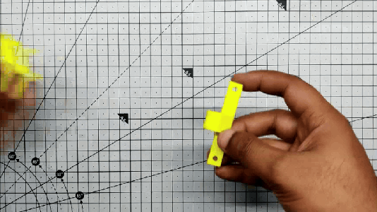

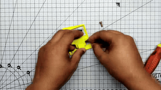

Step 7: Screen Holder Assembly
  • To connect the Screen Holder and Screen PCB Holder, we need two M3 bolts. Threaded inserts will keep the bolts in position and make this portion moveable.
  • The screen is then placed in the middle of the screen holder, the lid is placed on top, and the lid is fastened to the screen holder part with two M2 screws.

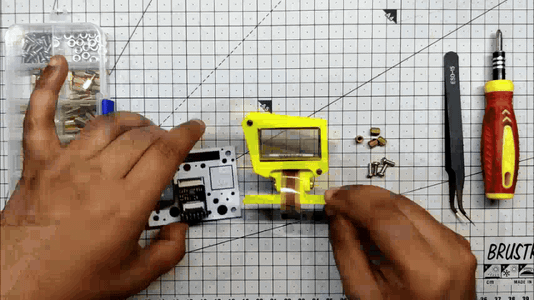

Step 8: Final Assembly
  • Next, we use M2 PCB Standoffs and M2 Bolts to attach the screen holder to the below PCB.
  • The assembling process is finally finished when the Flex cable from the screen is connected to the converter board.

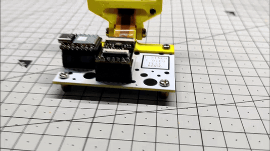

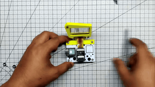

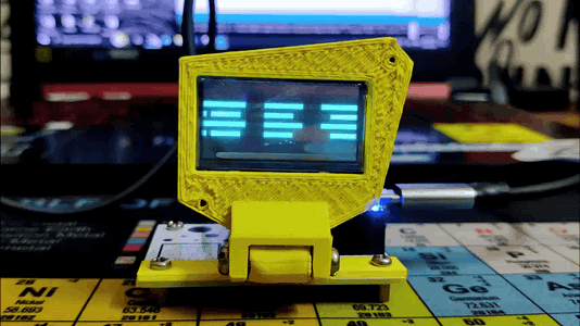

Step 9: RESULT
The finished result of the assembly is a transparent OLED arrangement with an XIAO M0 Board connected to it. It also has its own holder and stand, making prototyping simple unless we need to connect more components to it.
I'm experimenting with graphics for my application and will utilize this Test Bench/Board to run animations and images on this display, as well as possibly run a short game on it.
