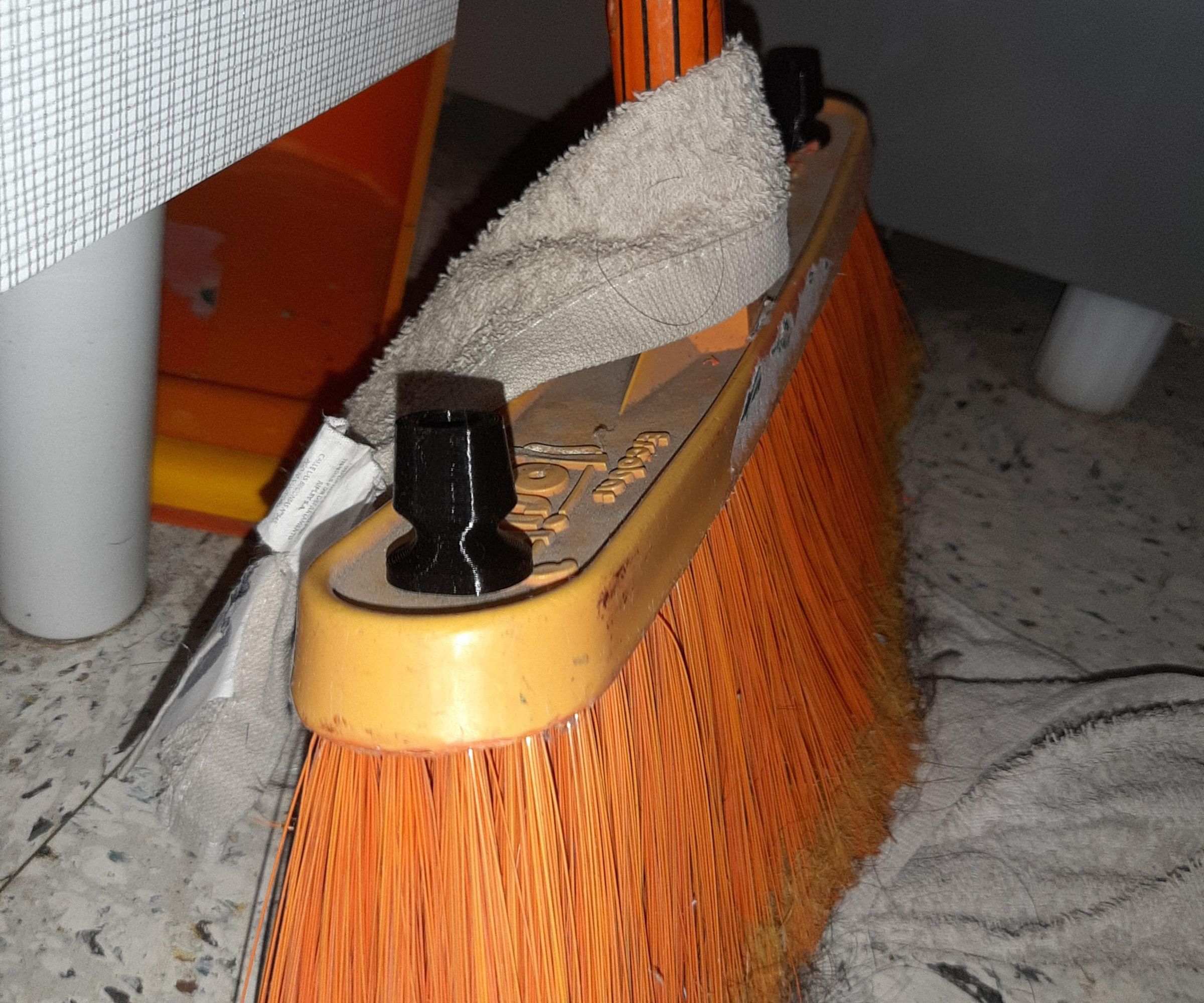

Hello, within this quarantine, we must get creative to supply the things that we do not have at home, and much more having a 3D printer. I needed a dumpster to put the small garbage bags in, so I used a clothes hook and designed the supports in SolidWorks (version 2018). The steps are very simple:
Step 1: Adapt and Print the Attached Models.
I leave the files in Solidworks in case someone wants to modify them and adapt them to the different bag sizes they may have in their homes.
Step 2: Making the Legs
Cut from a wire clothes hook, 3 pieces of 24 cm. then fold it into an "L" shape with one part 20cm and the other 4cm.
Step 3: Putting Everything Together
Join the parts as shown in the photos.
Step 4: Placing the Bag
Place the bag inside the small ring, folding the edges out.
Step 5: Insert the Bag
Insert the bag with the plastic ring inside the support.
Step 6: Start Using!
