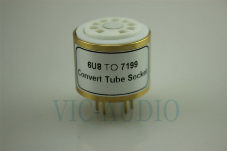

One of the biggest challenges to working on vintage electronics is getting the right component, tube, or the right substitute tube. Some tubes like the tubes 6AN8 or 6AN8A are hard to get or don’t have a substitute tube. However you can make a substitution by finding a compatible tube and rewiring the tube socket or using a tube adapter to make a substitute.

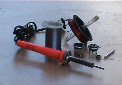

Solder
Wire
Tube
sockets
Soldering Iron
Multi Meter
Spacers
Large Shrink Tube
Tube
Substitution Guide
Tube Data Book

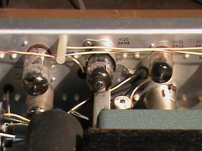

Step 1: Tektronix 515A

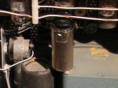

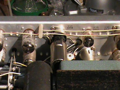

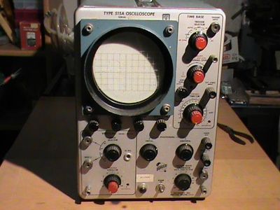

1. I got my hands on a Tektronix 515A oscilloscope, that wasn’t working.
2. From the manual I figured out the 6AN8 tube wasn’t up to snuff.

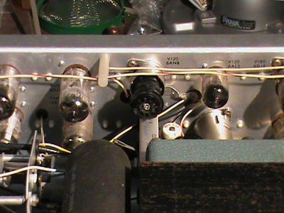

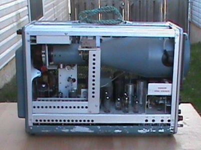

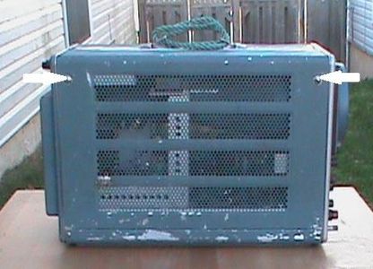

3. I opened the case by turning two screws just one turn and removing the side panel.

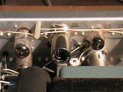

4. I removed the tube cover.
5. Then I removed the 6AN8 tube and tested it.
The tube was bad.

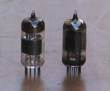

The A at the end of the part number is just a newer manufacture.
Since the 6GH8-A, have about ten tubes you can plug and play substitute I stopped there.
The internal plates and grids of 6GH8, are similar in value as 6AN8 just a different pin out.
The heaters are the same voltage and current, so it doesn’t matter if all the heaters in the vintage electronics are connected in series or parallel.
However to substitute a 6GH8 tube for a 6AN8 tube you do need a tube converter.
Step 6: The Tubes

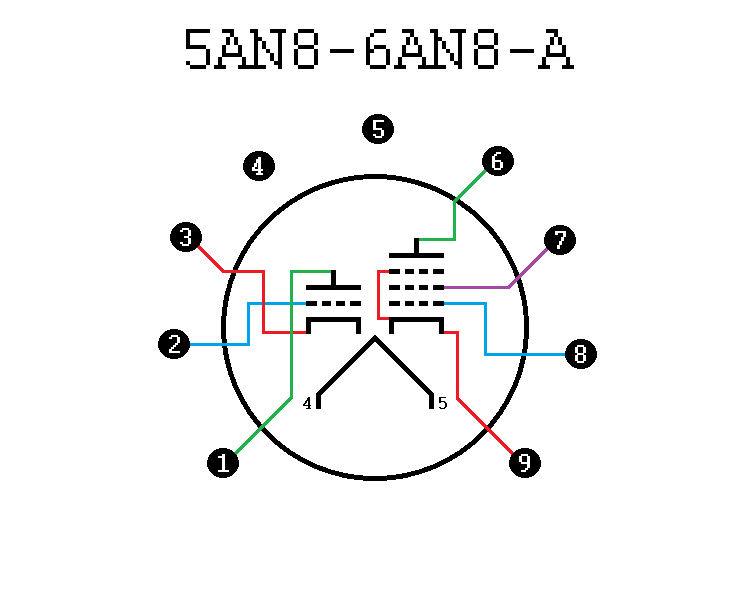

6AN8 VS 6GH8, remember vacuum tubes are like transistors they only need to be in the ball park.
6AN8-A
Pin 1 triode plate.
Pin 2 triode grid.
Pin 3 triode cathode.
Pins 4 &5 Heater. 6.3 volts, 450 mA
Pin 6 pentode plate.
Pin 7 pentode grid 2.
Pin 8 pentode grid 1.
Pin 9 pentode cathode, grid 3, and shield.

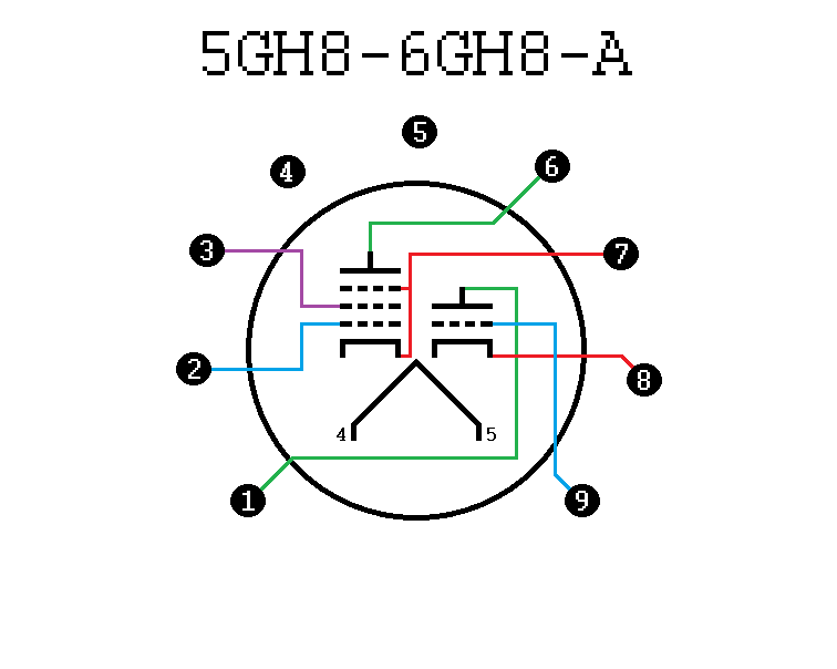

6GH8-A
Pin 1 triode plate.
Pin 2 pentode grid 1.
Pin 3 pentode grid 2.
Pin 7 pentode cathode, grid 3, and shield.
Pin 8 triode cathode.
Pin 9 triode grid.

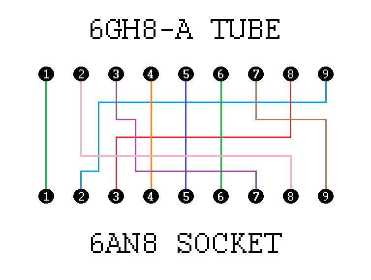

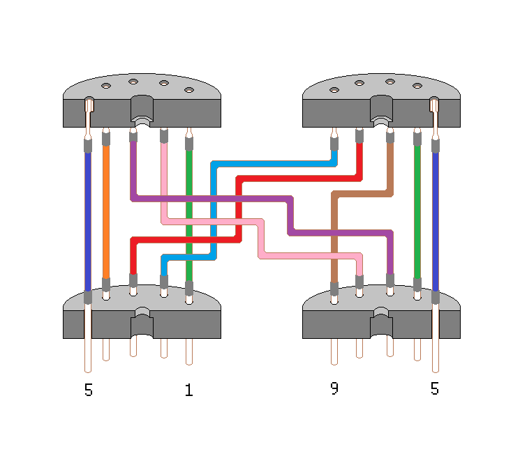

To make a converter you just need to connect the pins from the 6AN8 tube socket to the pins of the 6GH8 tube socket.

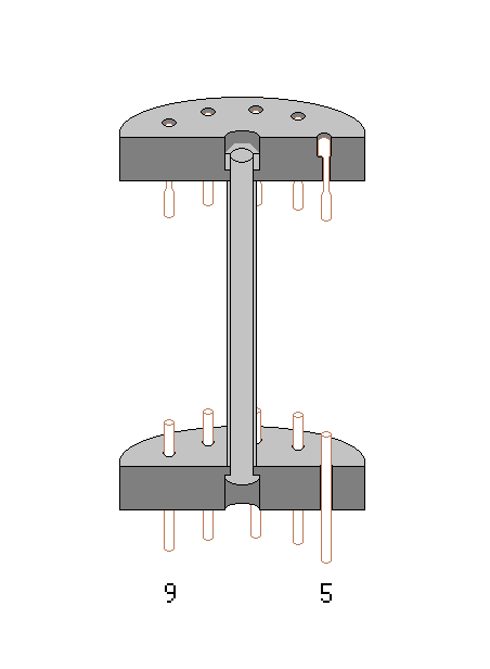

Step 7: The Converter

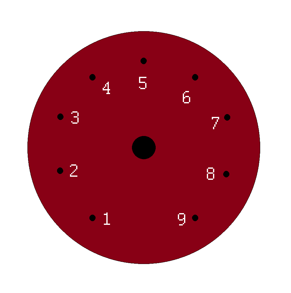

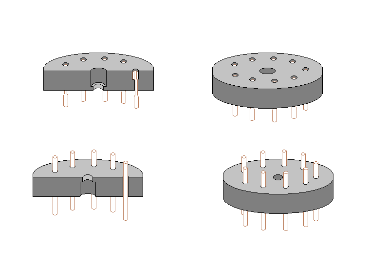

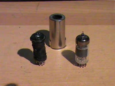

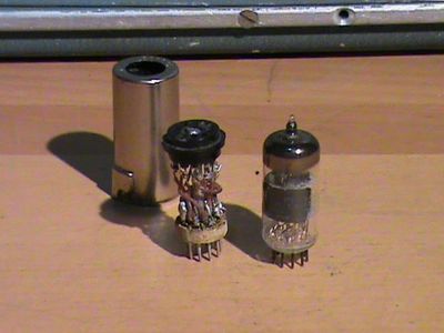

To make the converter I used two nine pin sockets nine pins and a spacer.
To make the male fitting I simply soldered 9 steel pins into a 9 pin socket, then ground the sides so it would fit inside the tube shield.
Solder the wires carefully to avoid missed or cross connections and shorts.
Then it is just a matter of making the connections.
Pin 1 on the 6AN8 socket to pin 1 on the 6GH8 socket.
Pin 2 on the 6AN8 socket to pin 9 on the 6GH8 socket.
Pin 3 on the 6AN8 socket to pin 8 on the 6GH8 socket.
Pin 4 on the 6AN8 socket to pin 4 on the 6GH8 socket.
Pin 5 on the 6AN8 socket to pin 5 on the 6GH8 socket.
Pin 6 on the 6AN8 socket to pin 6 on the 6GH8 socket.
Pin 7 on the 6AN8 socket to pin 3 on the 6GH8 socket.
Pin 8 on the 6AN8 socket to pin 2 on the 6GH8 socket.
Pin 9 on the 6AN8 socket to pin 7 on the 6GH8 socket.
Step 8: Test the Converter
Using a multi meter check the connections between the two sockets, make sure you have continuity only between the socket pins you need continuity. Use shrink tubing to prevent shorting.

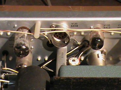

Step 9: Install the Tube
Insert the converter into the socket first.
Place the tube in the tube cover and insert the tube into the converter.
Make sure the tube socket is grounded, the tube cover prevents transient signals from interfering with the tubs functions.
Place the side panel back on and test.
