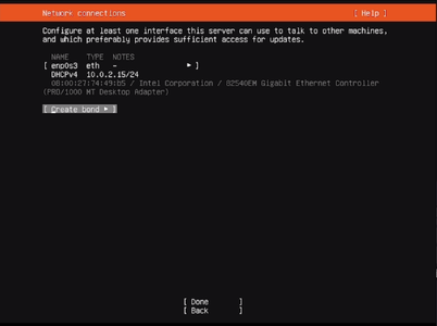

Configure your network, as in my case it is connected to the network by cable I did not need to configure
[IMG 4]

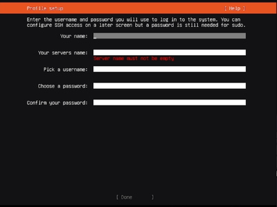

As only those who are connected to your network will be able to access your data, configure your name, the server name, username, and password for CasaOS
[IMG 6]

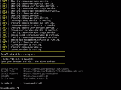

After logging in, go to the official CasaOS website and type curl -fsSL https://get.casaos.io | sudo bash in your terminal, enter your password and wait.
After the installation, an IP will appear. Just put it in your browser. It will ask you to create a login and password. I recommend creating an easy one so you don’t lose her login. And your home server is ready. You can access it from any device that has a browser.
