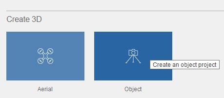

The only real difference between the ReMake and ReCap Photo dashboards, is that there are now two options under Create 3D: Ariel allows you to create scans from ariel drone footage and Object does what the Photos button did in ReMake. We won't be using the Ariel feature in this class, but I encourage you to experiment with it if you have a drone!
To upload your photos, click on the Object icon under Create 3D. ReCap Photo only creates meshes in the cloud, so there is not option here for 'Online' or 'Offline' as there was in ReMake.

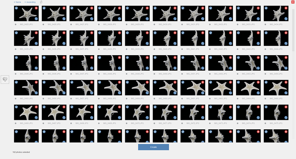

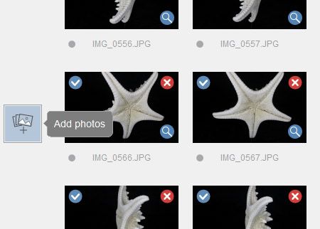

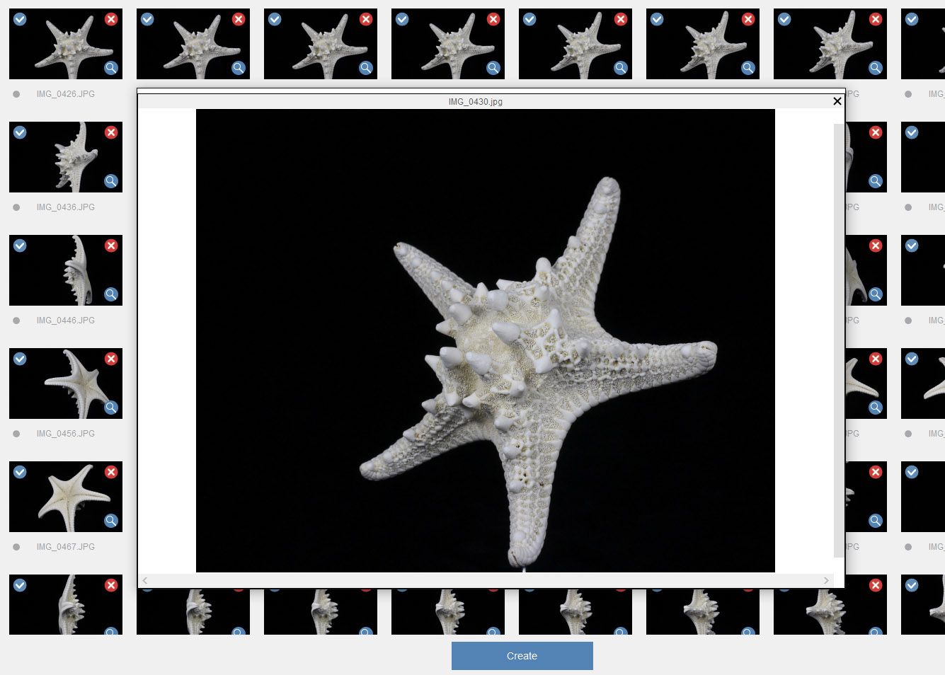

Browse to the folder with the photos of your object, select all of them and click open. All the photos you selected will show up in a window. They will always be shown in landscape even if your photo files are oriented in portrait. If there are any photos you forgot to delete from the set, you have another opportunity to do that now by clicking on the red x in the top left, or deselecting the photos by clicking on the blue check mark in the top right.
You can also click on the magnifying glass in the bottom right to see a large version of the photo. On the bottom of the screen you can see how many photos are in your set, to add more photos, click on the 'Add Photos' button on the left. Different versions of the software give you different numbers of photo options. The free trial and subscription versions let you process as many as 1,000 photos, while the education version only lets you process 100 photos.

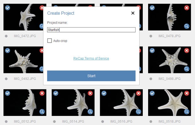

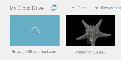

Once you have all the photos you want, hit the ‘Create’ button at the bottom of the page to upload your photos to the cloud. In the dialog box that pops up, enter a name for your file.
You will also see an option that says for 'Auto-Crop'. If you shot using the 'shoot around the object' strategy, auto crop will help prevent objects from in the background from being reconstructed. Once you’ve made this selection, hit 'Start' to start creating your model.
You’ll be taken back to the Dashboard screen and you’ll see a thumbnail of your project under ‘My Cloud Drive’ at the bottom of the screen that shows the upload progress of your photos. Don’t click away from this screen until the upload is complete and has switched to ‘Waiting in Queue’. Once it has processed at least 1% in the queue, you can click away from this screen, but if you click away before that, your job will stop processing.

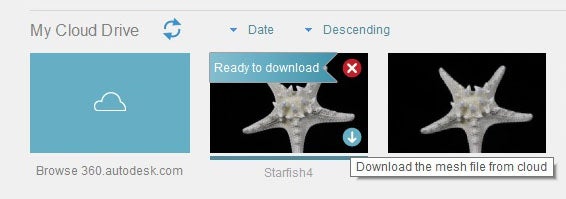

Back on the ReCap Photo Dashboard, you will now see a thumbnail of your project under ‘My Cloud Drive’ that says ‘Ready to download’. If you hover over the thumbnail you will see a blue download symbol in the bottom right hand corner.
Click on it and a dialog box will open asking you where you want to save the file on your computer. Browse to the location you want and save the file. Once you have saved a file from ReCap in a specific location on your computer, moving it will remove it from the ReCap Dashboard, so it's best to save it in the place you want it to stay.

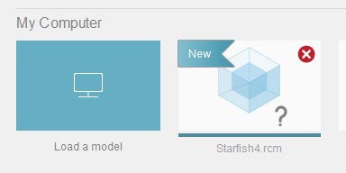

Once it is downloaded, it will appear on the Dashboard under ‘My Computer’ where you can click on it to open it in the ‘Editor’ environment.

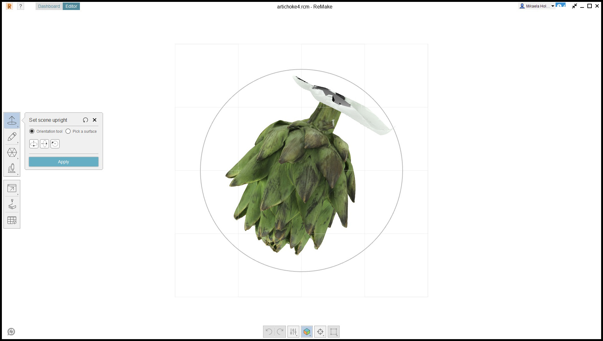

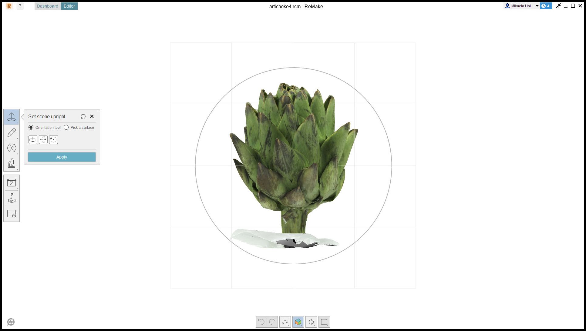

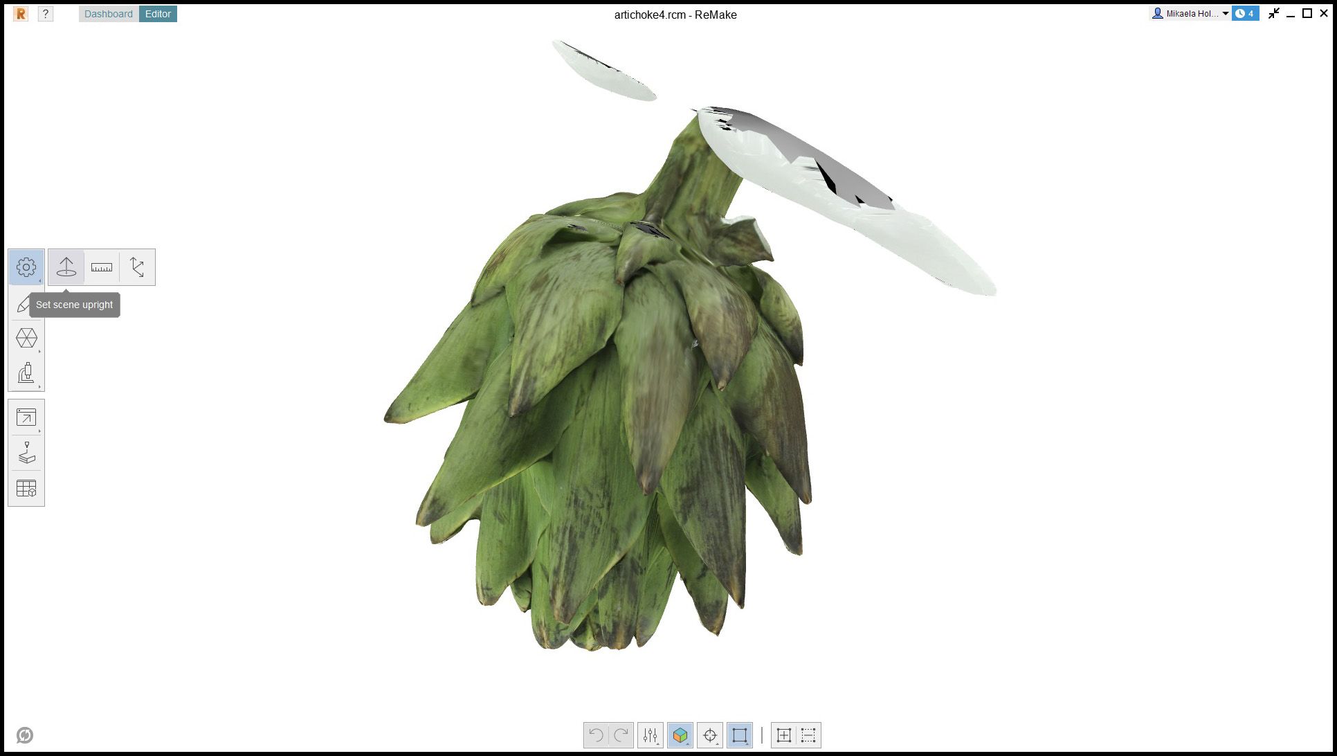

If moving around your model seems difficult or weird at first or if your model is visibly upside down, or oriented oddly, you might need to set it upright (once again, the interface has some slight visual differences now that it's called ReCap Photo, but everything fundamentally works the same way).
To do this, click on the gear wheel icon at the top of the left-hand toolbar and select the 'Set scene upright' tool which looks like an arrow with a circle under it.
A ring will appear around your object, this is a gizmo that will let you rotate the orientation of your model when you click and turn it with your left mouse button.
You can also use your right mouse button to click on the model and move it freely, or use the orientation shortcut buttons in the dialog box. Move your model around until it is right side up and centered, then click 'Apply'. Now when you orbit your model should behave more naturally.

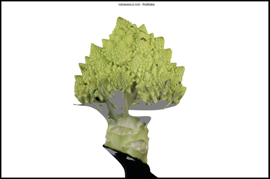

It's usually fairly easy to tell immediately if there are any big problems with your model. For example, this romanesco has a giant hole in the underside and isn't color mapped in some places.
It looks like the top was actually captured pretty well, so if you only wanted to use that part, this model might still work for you. However, some flaws are a little harder to see at first glance, and to check for these you need to change the way you are viewing your model.

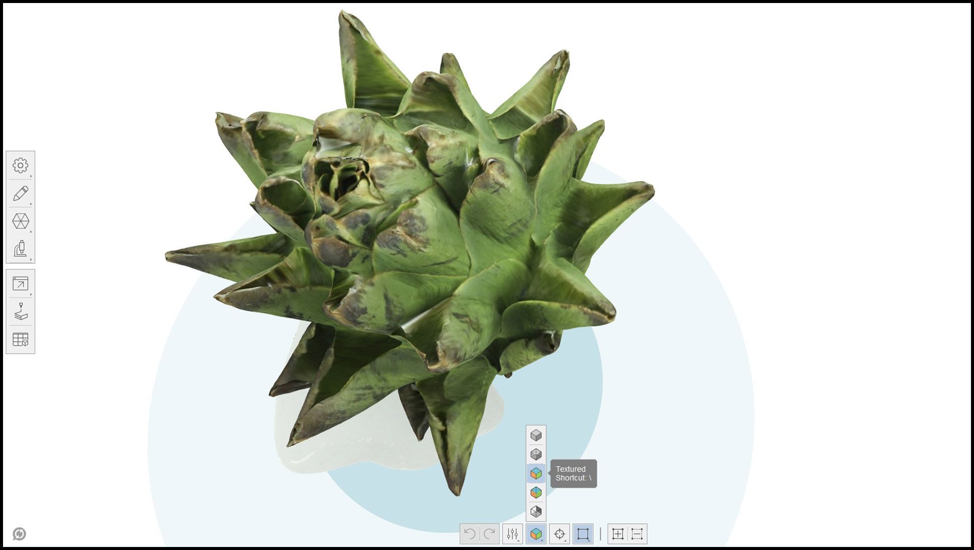

When you first open your model, it will be shown to you with the color mapping, or 'texture' turned on. (I personally find the term 'texture' to be misleading because this colored surface is only visual not geometric). The model almost always looks best with the color layer turned on, and if you are intending to use it in a gaming or online environment (or print it with a color 3D printer) this is great, but if you are planning to use the actual structure of the object for 3D printing or some other physical application, the color mapping actually hides some structural details.

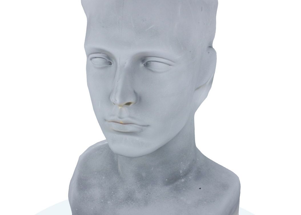

To actually tell how accurately your scan has captured the shape of your object, you need to turn off the color layer. On the bottom menu, click on the colored cube and you will see a menu with visualization options. Each of these will let you inspect your object in a different way.

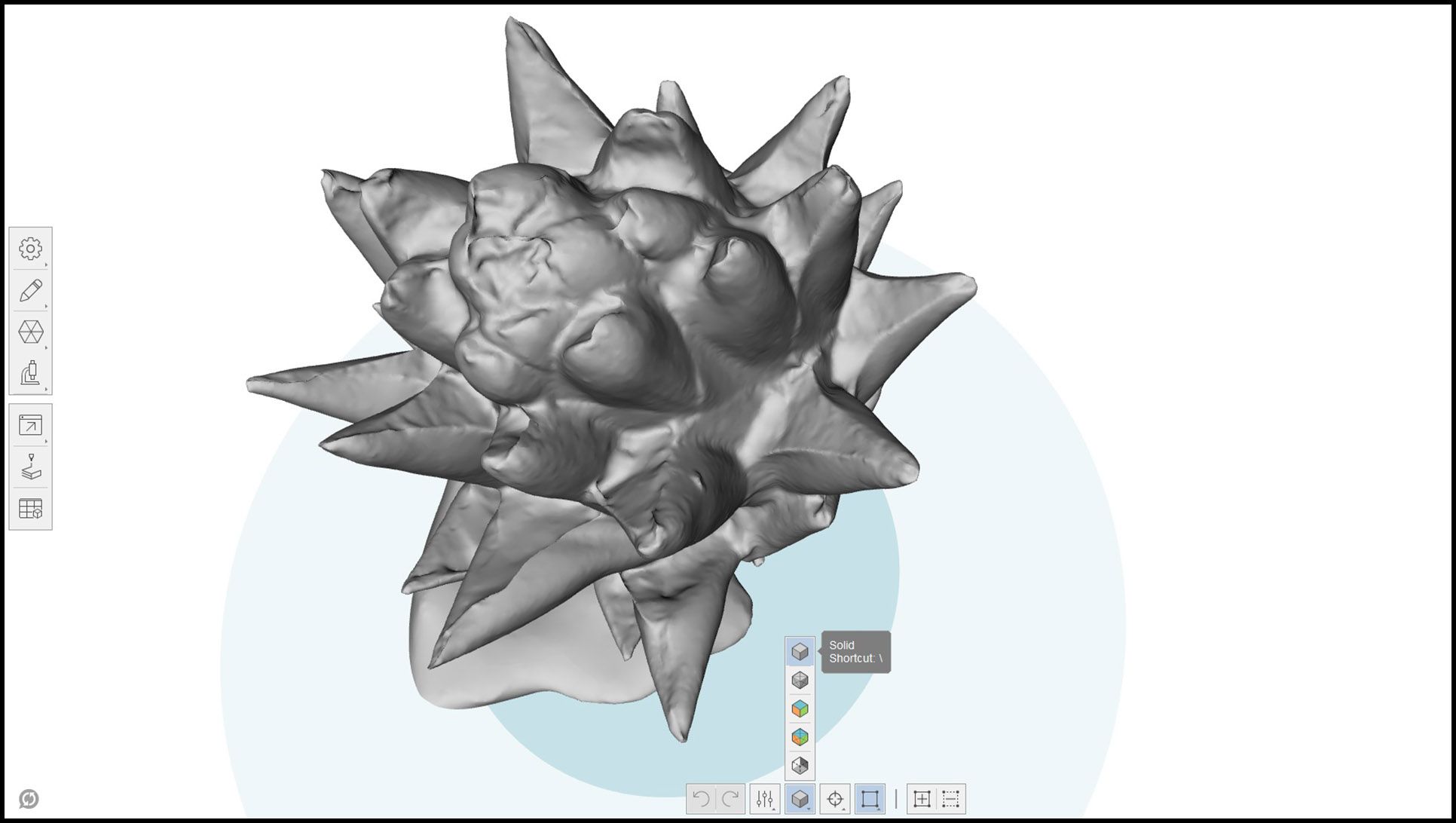

The greyscale square at the top will put your object in 'solid' mode, showing you just the shape, not the color. This is the best mode to use for a quick inspection of the quality of your scan.
As you can see, when you switch to solid mode, some details of your object that are represented in color will disappear, and sometimes other flaws may appear that were hidden by the color. In the case of this artichoke, the concave areas of the leaves were not captured as part of the structure, even though you can see them in the color map.

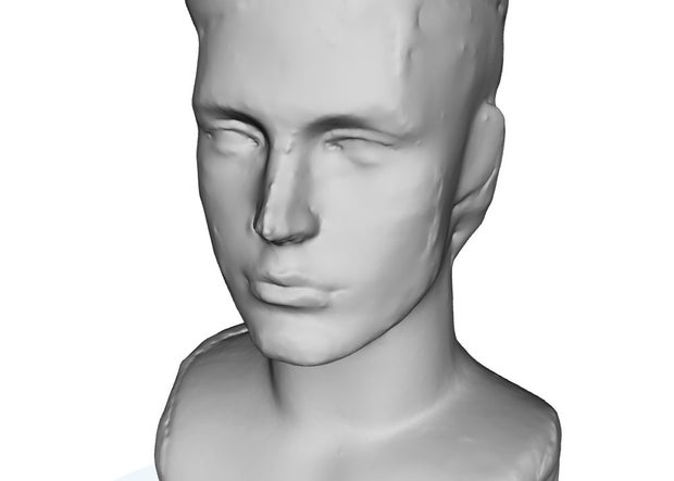

Similarly in this mannequin head, though the color mapped version looks smooth and the features are defined, the solid model is oddly lumpy and the features are a little blurred.
Some of these imperfections can be fixed by using the smoothing and sculpting tools we will learn in the next lesson, but if your model really looks too far away from the original object, you might want to try shooting a new set of photos. In this case I think the artichoke is probably as good as I'm going to get, but the head needs to be re-shot. Repairing and fixing models can be a very time consuming and frustrating process, so the more accurate your original scan is, the better.
