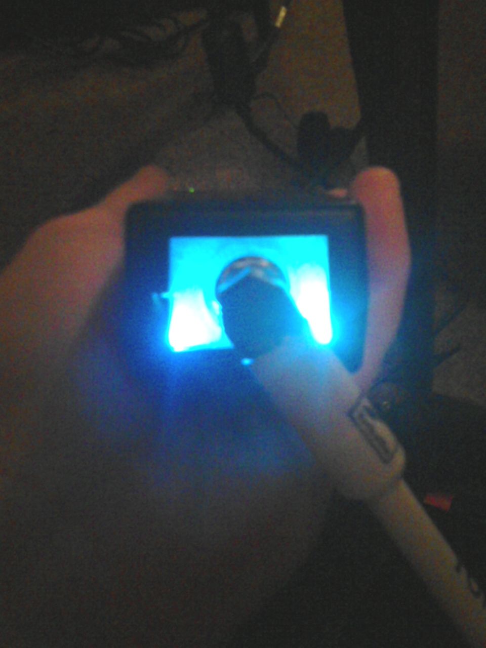

Step 2: Assembly
Open keychain flashlight housing and remove all components. Solder positive wire of USB plug to the positive of the LED, solder the negative lead to the 100 ohm resistor, and solder the other end of the resistor to the negative of the LED. Install components in case.
Step 3: Test It
Connect to a working USB port and it should light up. :)
