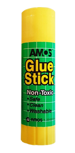

Print out the attached PDF of the Ulu and using a glue stick fix it onto the saw blade. Use an angle grinder to cut the Ulu out and then grind the bevel onto the blade. Drill both holes into the Ulu blade and give everything a sand down.
You'll notice that I didn't cut the slot out in the handle and kept it solid, this saved a lot of time and I really like the look.
