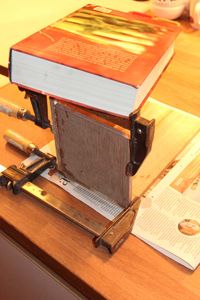

The hardest part is glueing the box together. I may seem simple, but it is difficult to glue 5 pieces together, keeping right angles everywhere. So I decided to help you with some step by step advice :
1. Put one side on a flat surface
2. Glue the bottom on top of it : Align the bottom, and one corner (in my pictures I aligned the bottom right corner)
3. Glue one extra side at the opposite corner (so I added a side to the left)
Apply clamps and some weights (I often use books)
5. Glue the remaining sides, one by one.
6. Finish by applying a bit of glue to all inner joints with your finger.
Remark : ideally, the side will stick out just a little on all four sides. That's OK (better than being too small). This excess will be removed in the next step.
Remark 2 : It is important to take your time, take it one part at a time and let it dry enough. (my glue takes about 30 minutes, but 24h for full hardening out). So patience is your friend here !
