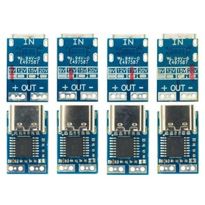

Fast forward to 2020, when we were all stuck at home and with spare time to tinker. That's when I found a finger-sized USB-C PD trigger module while browsing for electronic components in an online market. It is tiny enough to fit snugly inside my TS100's board and I figured it was a good time to streamline my workspace, fix all the dangling wires, and cut down the unnecessary power supplies. So when I received the PD trigger board that I ordered, I started disassembling my TS100, delicately removing the DC input, and seamlessly integrating the module onto the main board. It wasn't just about streamlining and reducing the clutter in my workspace but also enhancing the functionality of my soldering iron wherever I go.

  2. USB-C PD trigger module (20V)

Step 3: Soldering the USB-C PD Trigger Module
In this step you have to have steady hands or use one of the handy third hand tool. I traced out the original DC input connection and connected the positive and negative of the USB-C PD trigger module as shown in the picture. I set the enough wire length and twisted it so I can properly mount the module upside down. As for the wire, I took it from the power supply and didn't care the gauge. I recommend to use a wire gauge that support 20V 65W rating.

The USB-C PD trigger module is a little wider than the panel cover. Either you trim the trigger board or panel cover. I decided to trim panel cover since I have to bore a hole anyway as the original DC input opening is too little for the new USB-C input. Using a rotary tool, I drill and grind the side panel until I get the module fit and bore a larger hole to accommodate for the new USB-C connection. Unfortunately for me, I got too excited and crack the panel. It can be easily fixed with a super glue but as gentle reminder take it slowly and have a patience so this won't happen to you!

I advice to have this done before the assembling or be like me - cross one's finger and hope everything will work as expected. Lucky for me, everything works like a charm. Now, my TS-100 is USB-C ready and all I need to do is plug it to any USB-C power charger.
