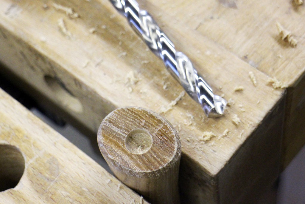

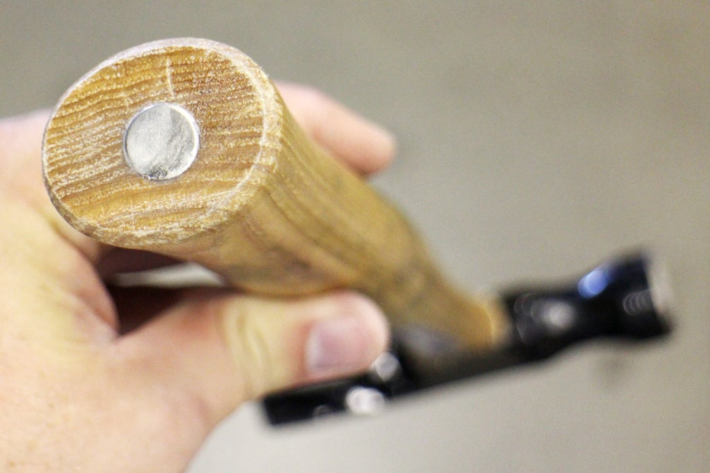

Wood handled hammers are perfect for including a small magnet in the flat bottom. I found a drill pit with a matching diameter to the magnet I wanted to use.
![](https://content.instructables.com/F65/H6OG/J44FWFU4/F65H6OGJ44FWFU4.jpg?auto=webp&fit=bounds&frame=1&height=1024&width=1024)
Secure the hammer so the location for the magnet is facing upwards, then drill into the bottom of the handle as deep as required to contain your magnet.
![](https://content.instructables.com/FYT/22XK/J44FWFU7/FYT22XKJ44FWFU7.jpg?auto=webp&fit=bounds&frame=1&height=1024&width=1024)
Add a small dab of epoxy into the cavity and then insert the magnet until fully seated. Allow the epoxy to cure and you're good to go!

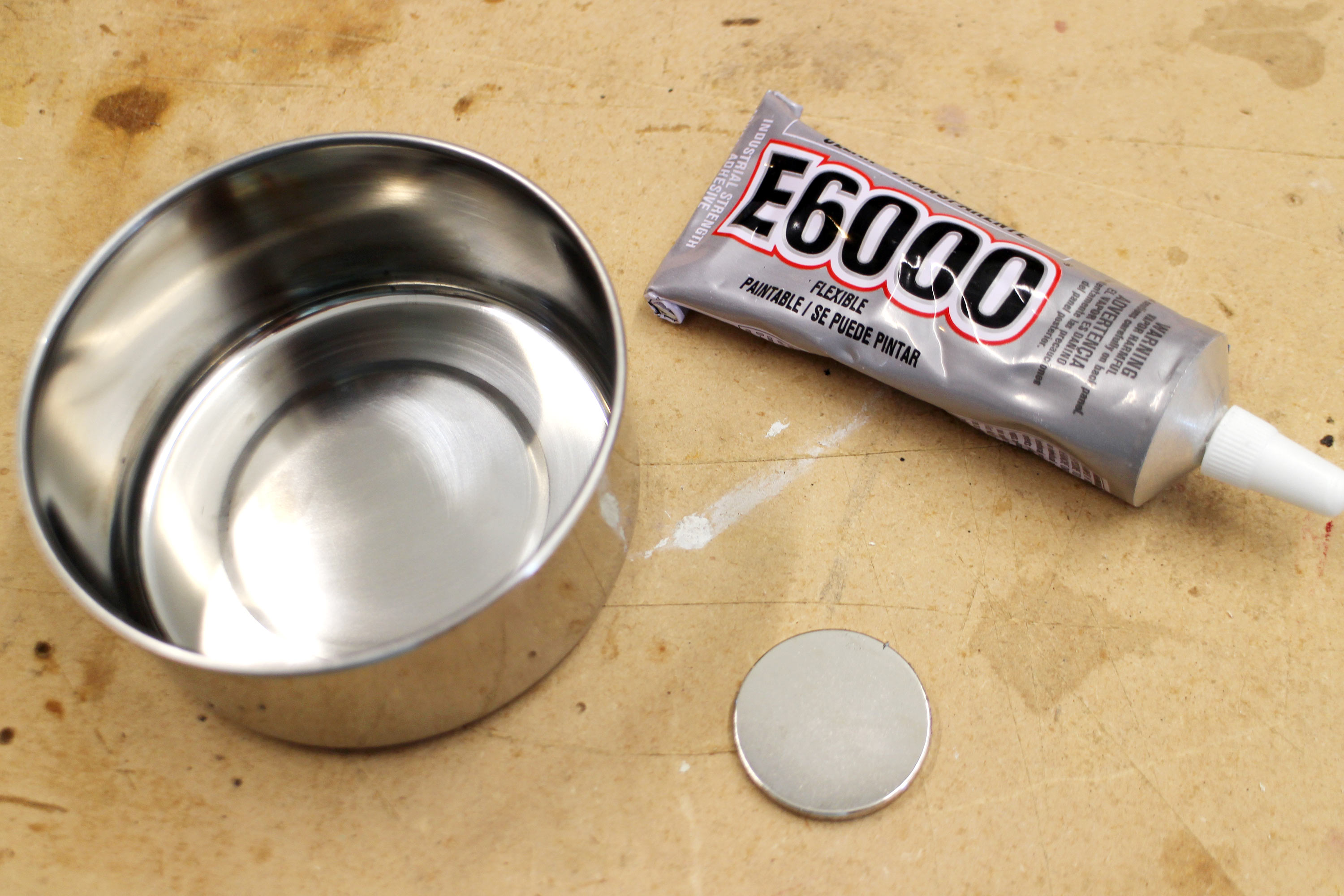

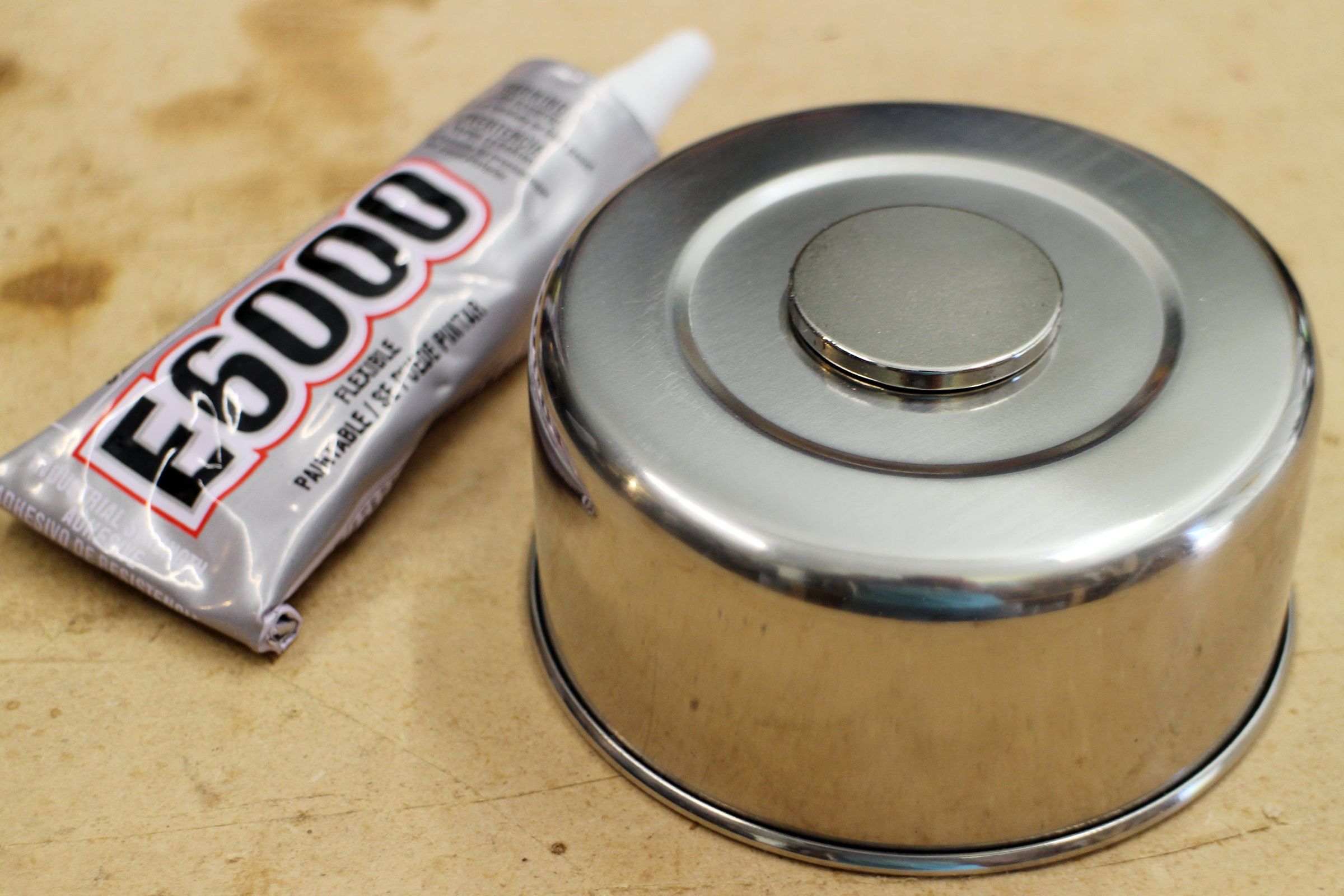

Crafty makers void warranties and fix all their own stuff. Keep your screws and other bits organized when you're doing your next disassembly with a magnetized dish.
Almost any dish can work for this, but I used a stainless steel container. Since some types of stainless steel aren't magnetic magnetic, I used a strong adhesive (E6000) to bond my large diameter flat magnet to the underside of the dish.
Allow the adhesive plenty of time to cure (I left mine overnight), then your dish is ready to be used.

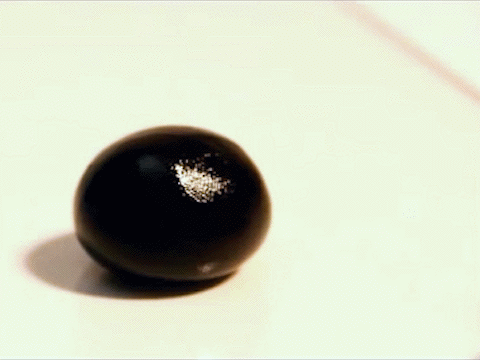

Magnetic Silly Putty is super easy to make, and displays some curious properties when a strong magnet is placed nearby. Making your own is easy, you just need some silly putty, a little black iron oxide powder, and a powerful rare earth magnet.
![](https://content.instructables.com/FKH/P0I0/J62G39J9/FKHP0I0J62G39J9.gif?auto=webp&fit=bounds&frame=0&height=1024&width=1024)
Magnetic silly putty is a great teaching tool, as well as a fun science toy for kids of all ages.
