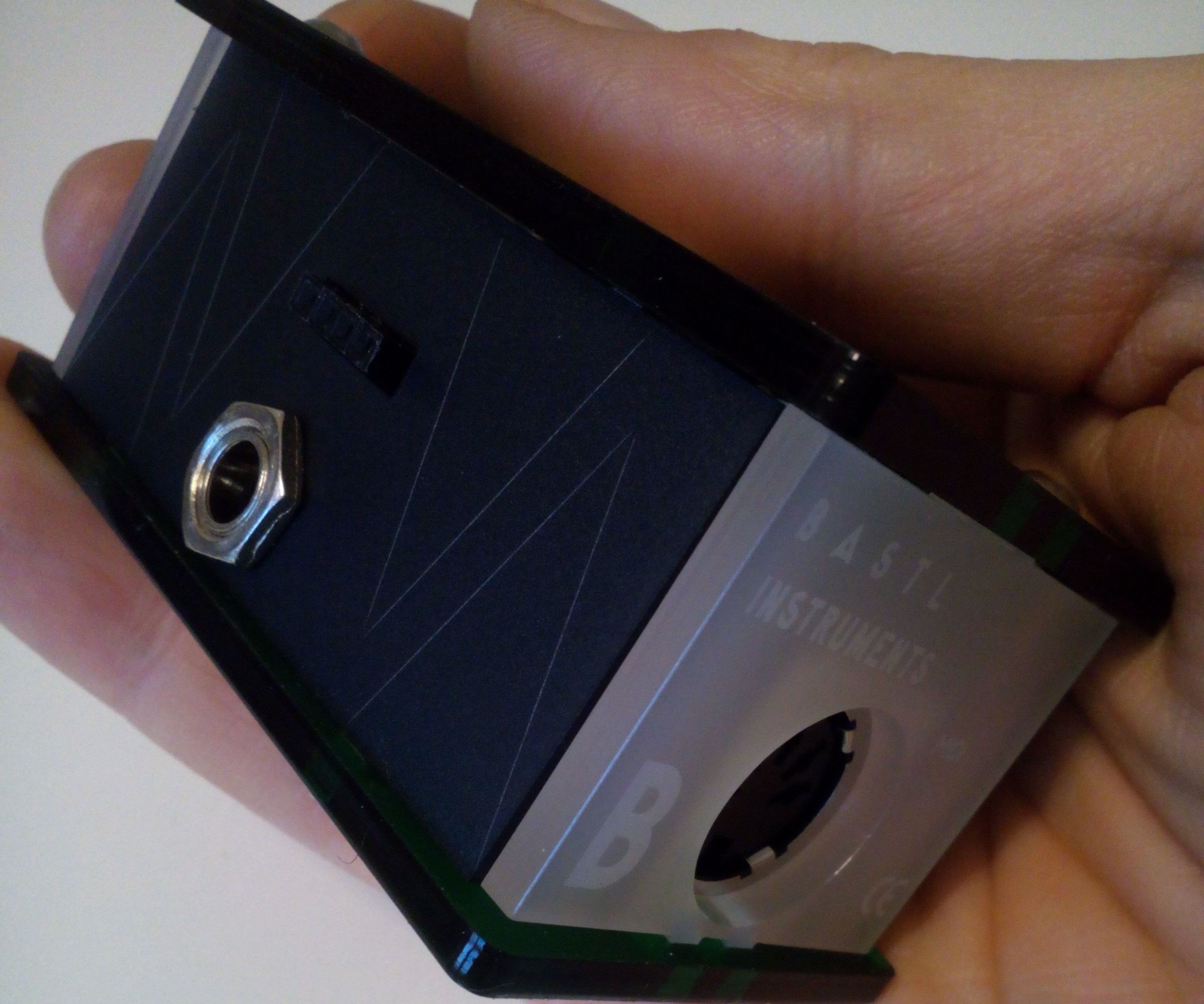

As show on the picture you connect the Trinity to the FTDi USB board and this one you connect with cable to your computer.
The other picture shows how you can wire it up to your Arduino to upload the software.
IMPORTANT! the 2nd picture is not 100% correct because I have bad version of Arduino-this shows more how to wire it up. You need the version of Arduino - the older model that has the DIL big chip - not smd. The same kind of chip as Trinity has. You need to take the chip out as on this picture: http://arduino.cc/en/uploads/Guide/ArduinoMiniAndNGBreadboardPhoto.jpg

Step 6: Upload the Software [nahraj to Tam]
[česky níže]
So now we should be ready to upload the software. Chose for example File>Examples>bastl>POLY
- On the picture 1. you see i clicked the "Upload" button (second from the left - arrow pointing to the right)- first it compiles - the status bar tells "Compiling sketch"
- If it compiles the status changes into "Uploading "
-if everything is right you should see the LEDs on the FTDi board blinking while the status bar tells "Uploading.."
-if there was problem with compiling - an error about something "not defined" you probable made something wrong with installing the libraries - go few steps back and check if everything is right
-if it tells you something about sync there is a hardware problem. check if the ftdi is connected properly - it might be also problem with soldering or you might have something connected to the chain connectors or wrong board version selected - Now the status bar should tell you "Done Uploading" without any error message.
CONGRATS - everything smooth and the world of software hacking is here! let us know what you do with it!
