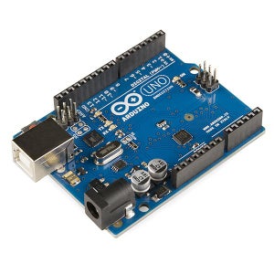

  • Arduino Uno
this is the microcontroller that I programmed and connected all of the electric components to for the timer to function. I believe the Arduino Nano will also work.

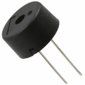

  • Piezo Buzzer
Can be programmed to make a sound at a certain frequency and duration.

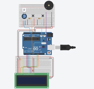

Step 2: Wiring
The wiring is a bit complicated, which is why I included the wiring schematic, and I made an organized wiring diagram with on TinkerCad.
