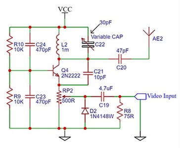

3. **Design Circuitry**: Design the circuitry for your transmitter. This involves connecting the components in a way that meets your requirements. Pay attention to impedance matching, power requirements, and signal integrity.

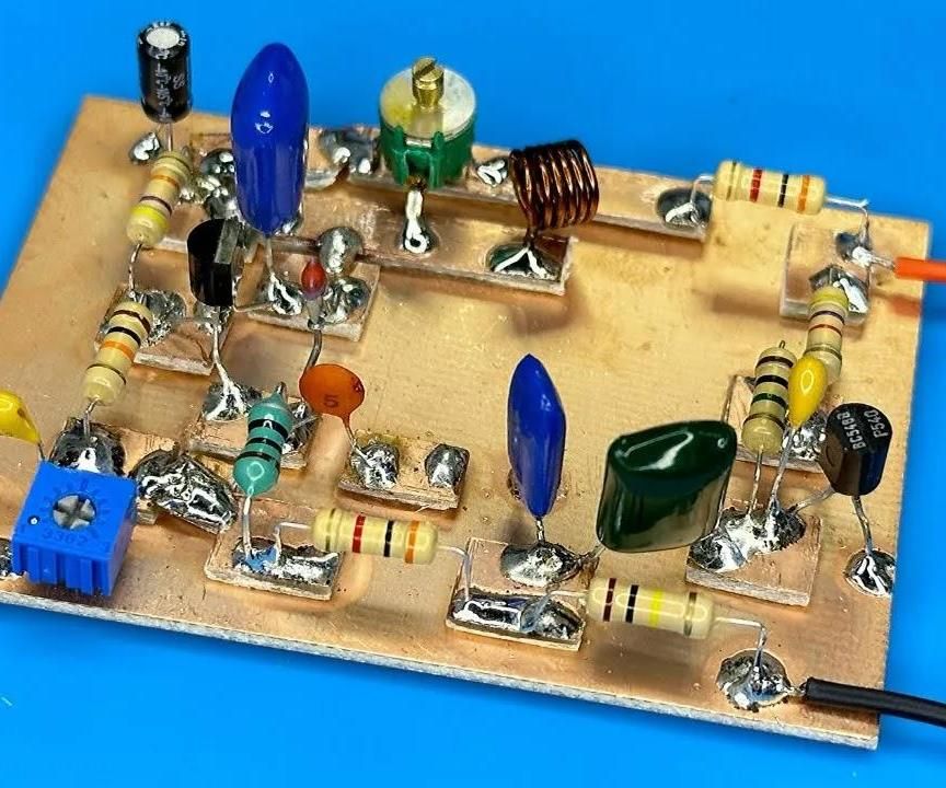

4. **Assemble the Hardware**: Once your circuit design is finalized, assemble the hardware components onto a printed circuit board (PCB). Ensure proper soldering and connections.
