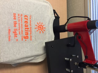

Step 8: Press
![](https://content.instructables.com/F9A/I0PF/IDECW4EG/F9AI0PFIDECW4EG.jpg?auto=webp&frame=1&width=320)
![](https://content.instructables.com/F5P/8AAF/IDED2AJA/F5P8AAFIDED2AJA.jpg?auto=webp&frame=1&width=320)
Open the heat press carefully and place the t-shirt onto the platform with the vinyl stickers facing up. Close the heat press and wait the required amount of time (for the heat transfer vinyl I am using, it takes 15 seconds at medium pressure). Open the heat press and carefully (the shirt will be hot!) remove the plastic sticker backing from the top of the vinyl.
Enjoy your new t-shirt!
