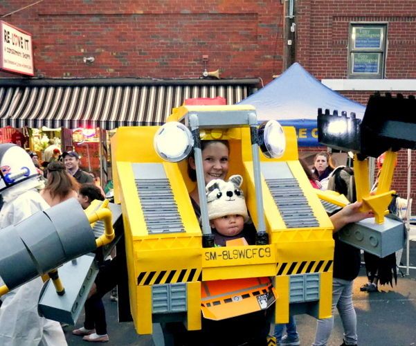

Using foam core boards from the dollar tree, a scalpel, ruler & hot glue gun I scaled up 1:20 from this mini Wall E model (you can just see it sitting on top). My favorite (and my sons) was making the claw grabbers look like Wall E arms - as you can see he couldn't wait to get playing with them!
Step 2: Paint and Rust
My son finally got the chance to get stuck in painting the brown under layer for the rust technique - this added so much time but he was so excited to help. We used acrylic paint (2 browns & then some patches of a gunmetal grey) at first I was just painting where I was going to show the rust, then when my son helped we just did brown all over. I then sprinkled regular table salt (thickly where I wanted main rust spots) then used the yellow spray paint. Once dry, I used a stiff brush to brush off the salt, then decided to use sandpaper by hand then the brush to really work areas of rust. This technique was relatively easy and and was very happy with the results.
Step 3: Wall E - Last Minute
Wall E's eyes were finished with plastic from an apple carton - they were good enough but I would have liked more time on them.
So the day of the Halloween party my son really couldn't wear the main body (it had just become too heavy) and the eyes were just too awkward to wear on his hat. So very last minute I stole the wheels from our stroller and attached to a PVC pipe frame i knocked up from pieces I had left from another project. And more foam board to the rescue for the neck.
