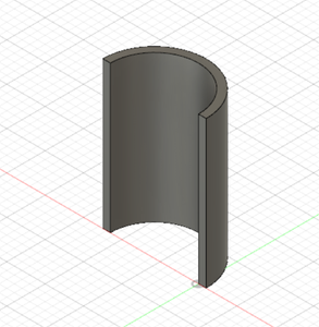

Step 9: CAD Modeling
The first image is the assembly of the two other images. (I used Fusion360 for this step)
The bridge is essentially a frame that acts like a skeleton to supports all the soil, dirt, and gravel that will be put into the bridge.
I chose this design because it had multiple points of drainage so that the water can flow freely instead of just sitting on the bridge, adding weight to the soil. Because it seemed to use more material than the other bridges, I tried to make most of the bridge out of soil, leaving large amounts of empty space so that the bridge will use less material, which is a more sustainable design.
(The scale of the CAD design is 10.28m : 1cm, that is probably not the proper way to write it...But basically, take the real-life measurements [which are in meters] and convert it to centimeters using the ratio)
