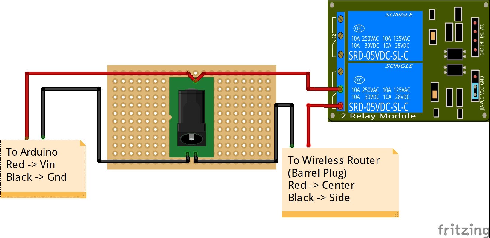

Step 2: Power Distribution
A small old PoE for outdoor radio is best for this project. The power goes in from center barrel jack. Jumper wires come from one side to power the Arduino. Barrel plug comes out from the other side to power the wireless router. Well yes, this is a power distribution so we need only one line to mains socket. Hence we need a larger amperage rating adaptor to run both Arduino and Wireless Router. The original adaptor for my router is 9V 0.85A, then I need to change it to something like 9V 2A. Arduino itself is running at around 0.5A, then we need more to juice up Relay Module.
You can use two barrel plugs because Arduino Uno has a jack on it. Instead I soldered two jumper wires and plug it into Vin and Gnd on Arduino. Working with barrel plug, you need to double check the polarity with Continuity Test on your MultiMeter. Although some cables are marked with dashes on its ground line, but remember that some old devices have inverse polarity on their plugs, that is negative in the middle instead of possitive.
Here is the power distribution schematic :

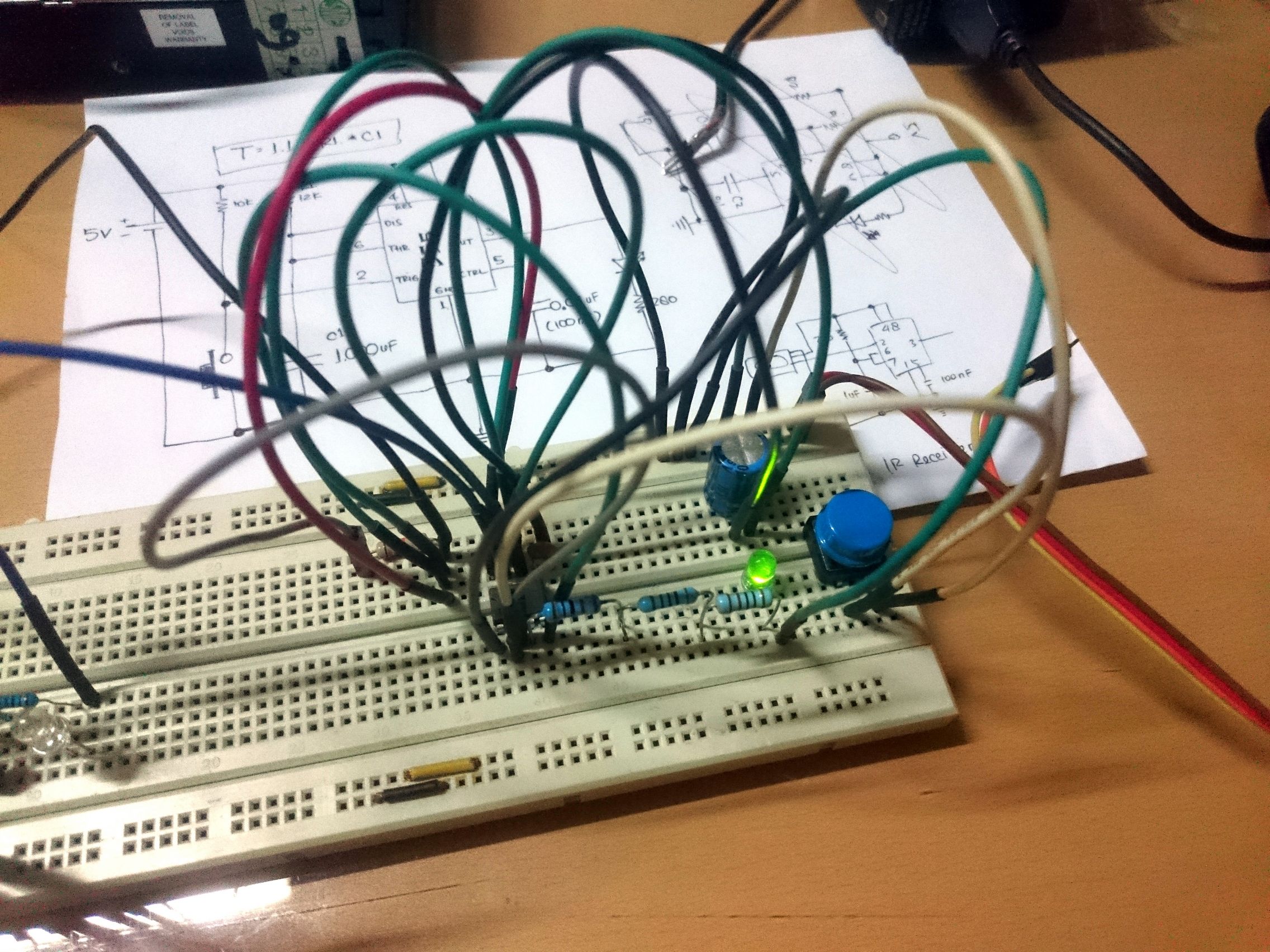

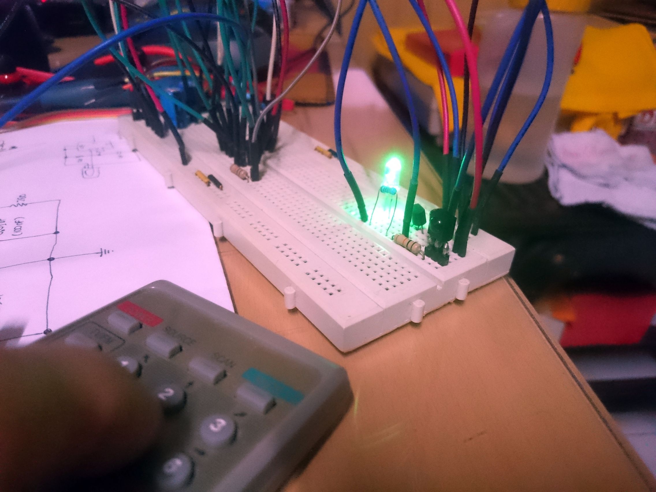

I am thinking of shrinking the device. I reboot my router about once a week and I think Arduino is wasting the power sitting there for this simple job. Yes I have some Arduino Mini and Micro around but there must be a way to reduce the power for this mini task. I have build an IR detector circuit with a transistor and some resistors. I also build a Monostable Multivibrator with 555 IC for 15 seconds delay. Both circuit works with LEDs for testing, but none of them success switching 5V relays. Maybe I need more transistors or opamp. I am no good in circuits. I am better in coding, that's why I finished this with Arduino. Yes it needs hard work to be lazy ^_^
