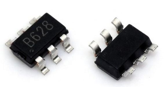

Step 9: Slave Component : SMPS
Finally, to finish the component selection for the slave, I will use the MT3609 SMP circuit to generate a variable power supply for various sensors. As most industrial sensors can easily vary from 5V to 24V.

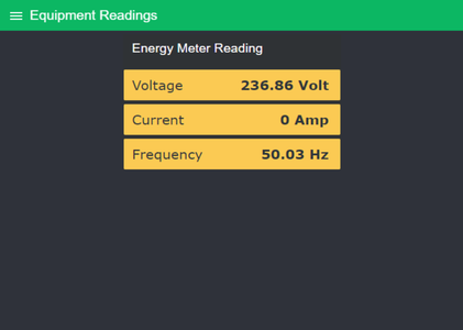

Master Node EM Setup
Now for the master setup, I have connected a Industrial grade, RS485 enabled energy meter. Which will simulate the energy meter used in industries or other harsh environments. Once the master node receive the data from the slave, it will also request the energy meter to provide current, voltage and frequency of the live supply (it can also produce wattage, since currently the energy meter isn’t connected to any load it will always read zero).
Once it has all the data in hand, it will transfer the data to the custom built cloud platform via MQTT for further processing.
We can watch all this in real time using the Node Red Dashboard.
Step 22: Node RED Dashboard
If you have done this setup correctly and visited "Your Cloud IP:1880/ui " you should see the dashboards updating live every 30 seconds.
