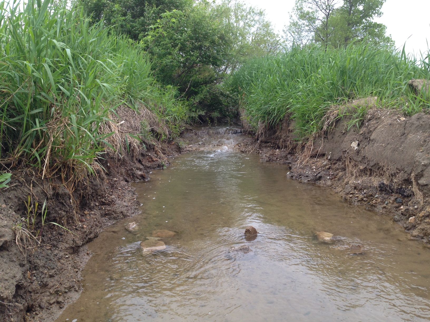

i uploaded the video of the flowing water beside our home. Its was dug by the local water supplier of the city and was abandoned when it deemed unable to supply the growing community.
Will this be useful in some other way? I want to ram pump this to better use
https://youtu.be/CORpxiynLZ0

Not likely enough flow rate for a ram pump. You might investigate a solar pump that moves water into a holding tank for use later when you have pumped enough to fill the tank.
