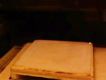

You could leave the tops of your coasters blank, but not embellishing this space seems like a waste
To personalize these bottle opener coasters I decided to etch the top. You could do wood burning, decoupage, or paint. I have access to a laser cutter so I decided to use it to etch an image onto mine - a simple beer bottle and can with a note letting you know there's a bottle opener hidden underneath.
