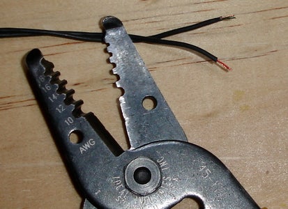

Step 3: Strip the Wires
split the two sets of wires from each other, separating them might be easier if you cut them a little bit with a knife first.
the strip the insulation back. i only have about a 1/4" off here, i ended up stripping it further, to about a 1/2".
