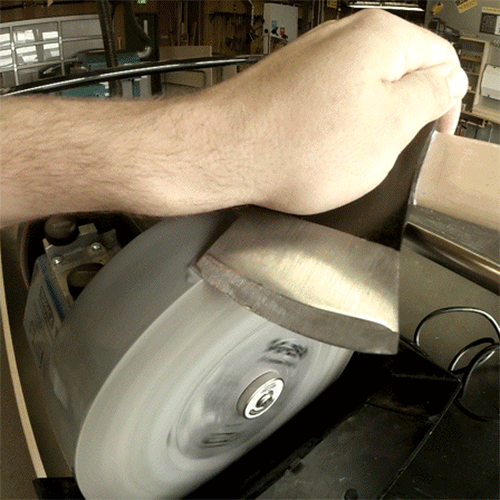

You can buy blade angles for kitchen knives that attach to the spline of the blade, but they don't make them for axes. Luckily we have a large sharpening stone at work with an axe jig and a blade angle.
After setting the desired angle and dialing in the sharpening stone diameter the axe is fitted into the sharpening jig and the jig is moved up or down to meet the desired angle.
Step 2: Sharpen Axe Blade
Sharpening a blade requires patience. LOTS of patience!
Most blades are sharpened wet and with the blade edge towards the direction you are sharpening. Though I am using a wheel with a water reservoir, sharpening on a whetstone is the same. With the jig set at a very low 15 degree angle I gently rocked the blade on the jig across the sharpening stone. Since the axe head is curved I needed to maneuver the axe handle up and down slightly at the ends of the blade to keep good contact with the sharpening stone.
![](https://content.instructables.com/FZD/ZJ16/ICX7KZRW/FZDZJ16ICX7KZRW.gif?auto=webp&fit=bounds&frame=0&height=1024&width=1024)
By sharpening the blade angle from 30 degrees to 15 degrees I am creating a longer bevel on the blade, which means removing material on the axe blade. Removing tool steel by sharpening is a slow process that takes time. Put on some tunes or listen to an audiobook and be zen-like while sharpening. Go slow and check your work often to avoid mistakes.
Sharpening this axe from the wedge shaped blade to one I felt comfortable shaving with took about 3 hours.
