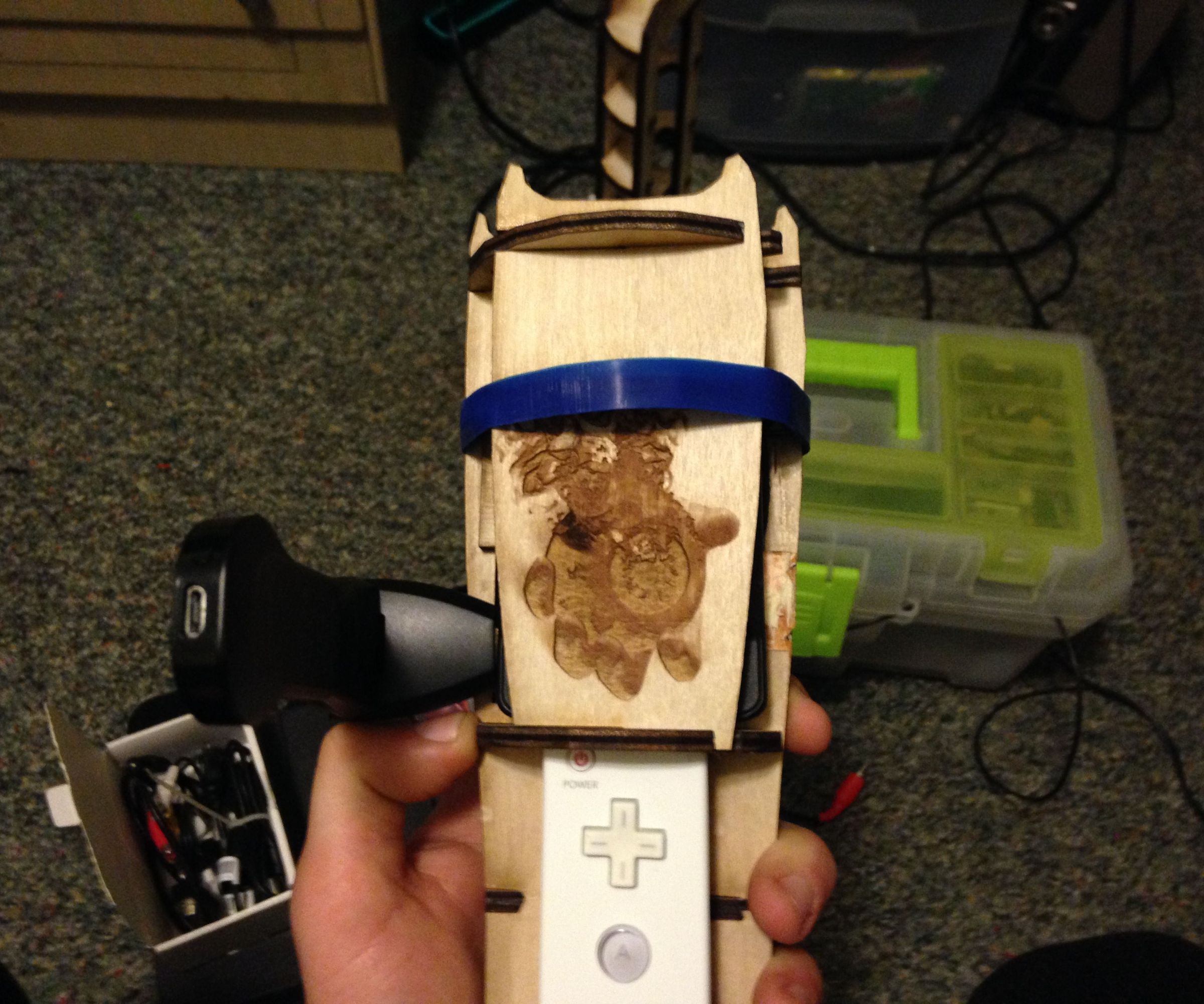

UPDATE: May 3rd - Playing Minecraft on the newer iTorch :)
UPDATE: NEW iTorch 3D printed version! && Finally uploaded some videos, hope you like them. :)
