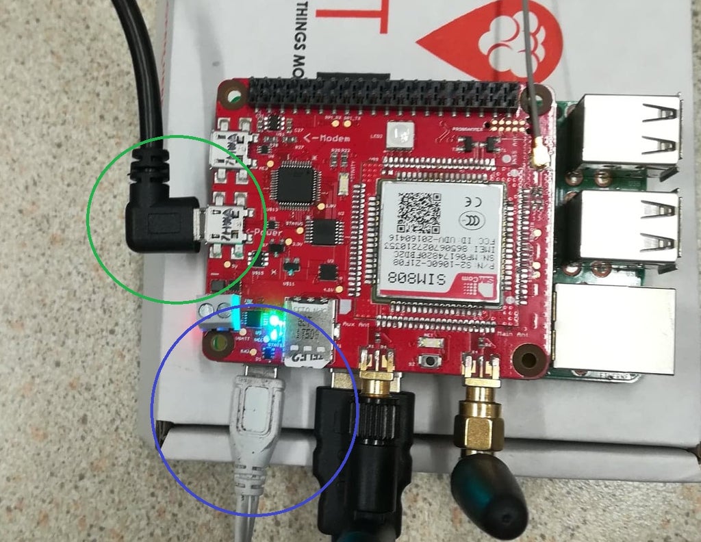

Step 3: Put IoT Bit Together With the Raspberry Pi
  • Raspberry Pi wall plug Into IOT BIT to power both IOT BIT and Raspberry Pi.
    ( You don't need to also plug in the Raspberry Pi).
  • Put the 2 antennas and the GPS antenna into IOT BIT.
  • Place the Sim card into the IOT BIT simcard holder with the cut corner facing away from the board(which you can buy from any major sim provider )

To use turn on the IoT Bit by plugging in the power cable to the USB port labeled POWER. Once connected the IoT Bit will power the Raspberry Pi.

Step 6: Functions of LEDs
POWER (Green) - This Led should be on when the IoT Bit is connected via USB when the IoT Bit is powered via battery this led will be off.
CHARGE (Blue) - Led is on when the IoT Bit is connected via USB when the IoT Bit is powered via battery this led will be off. This Led also works as an indicator when the battery is fully charged. If the IoT Bit is connected via USB and the battery is connected too. Once the battery is charged this Led will turn off.
ACTIVITY (Blue) - Turns on in startup when is off it means the modem is ready for use.
NET (Blue) -when it turns on shows that the IoT Bit is reading the sim card, when this led is blinking fast it means that is looking for a signal lock, when it starts blinking slowly it means it has locked to the provider of the Simcard.
RGB Led - This LED will turn White at the start meaning that the board is not connected to the modem USB, then the activity light will turn on the RGB will flash green and then blue, the activity and the RGB will turn off meaning the modem is ready for use.

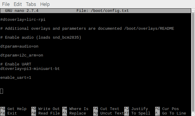

  2. Open up terminal and type
    • $ sudo nano /boot/config.txt
  3. add the following to the file
    • enable_uart=1
    • dtoverlay=pi-miniuart-bt
  4. Save the file use ctrl-x then y and enter.

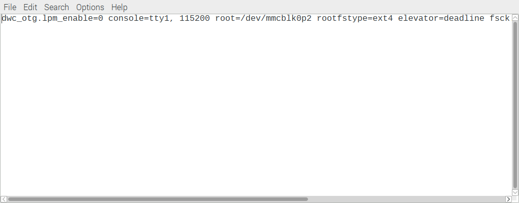

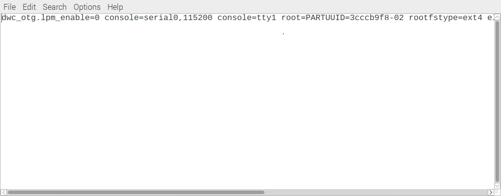

  5. Next open up the cmdline.txt file using the following command.
    • $ sudo nano /boot/cmdline.txt
  6. Modify the file so the contents are the same as the second line.:
    • dwc_otg.lpm_enable=0 console=serial0,115200 console=tty1 root=/dev/mmcblk0p2 rootfstype=ext4 elevator=deadline rootwait
    • dwc_otg.lpm_enable=0 console=tty1 root=/dev/mmcblk0p2 rootfstype=ext4 elevator=deadline rootwait
  7. Now reboot the system
  8. Once you have rebooted the UART bus should be enabled.
