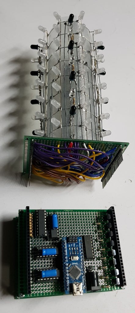

This is a creative cylindrical LED cube with proximity sensing by infrared led and photo-transistors. Interactive Cylindrical Cube includes: 8X8 royal blue LEDs, 12 infrared LEDs, 16 photo-transistors and all of them are bent & formed a cylindrical shape.

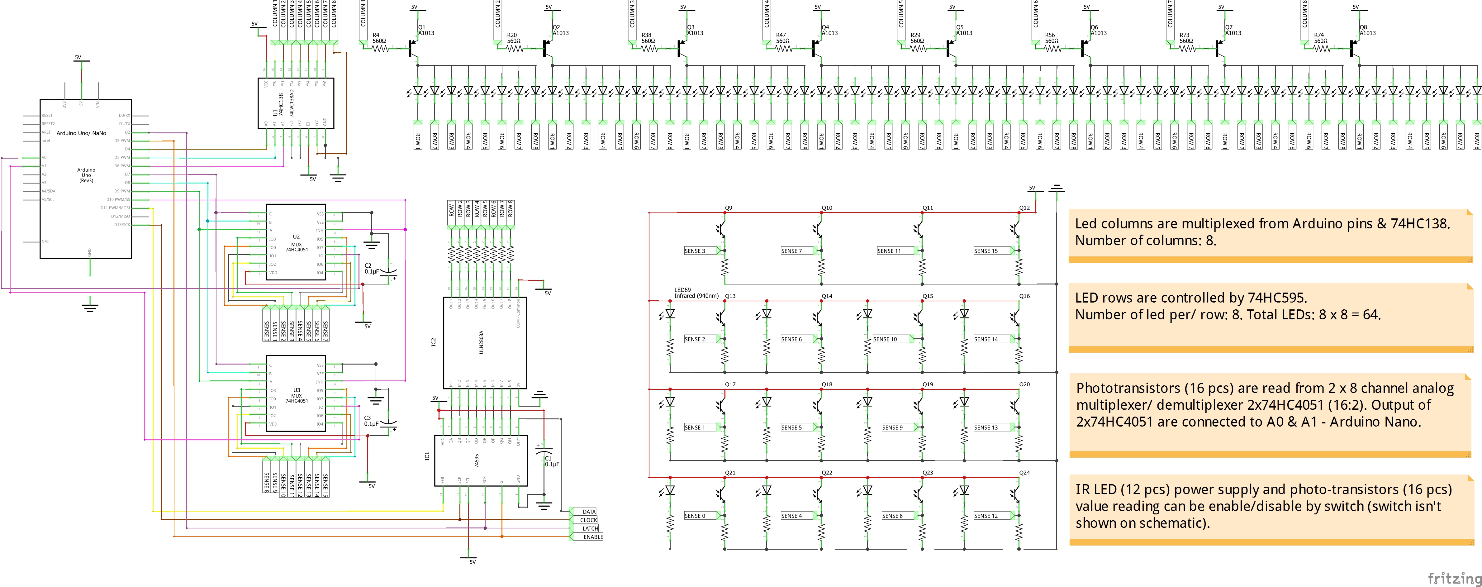

Step 2: Project Schematic
You can download high resolution version at link: Interactive Cylindrical Cube Schematic

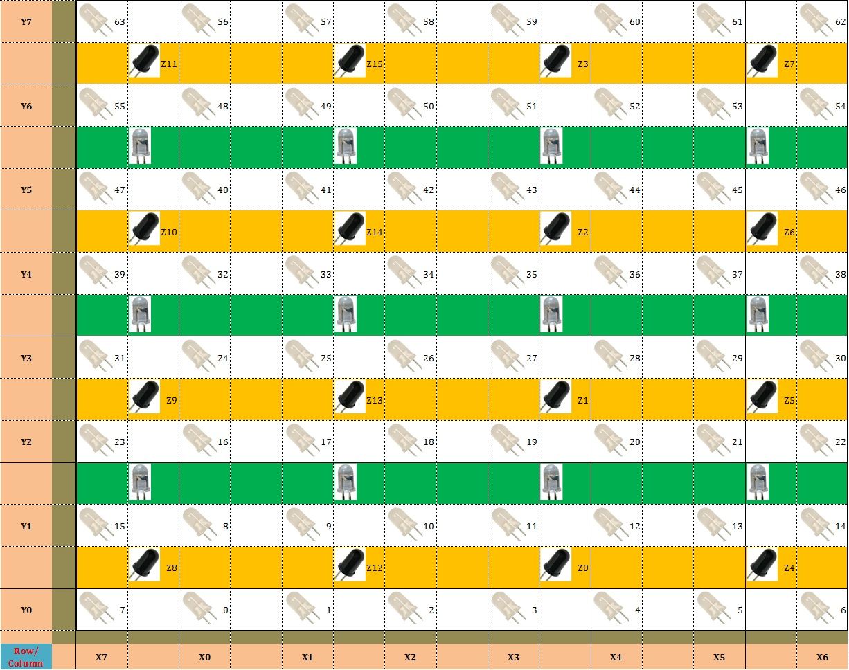

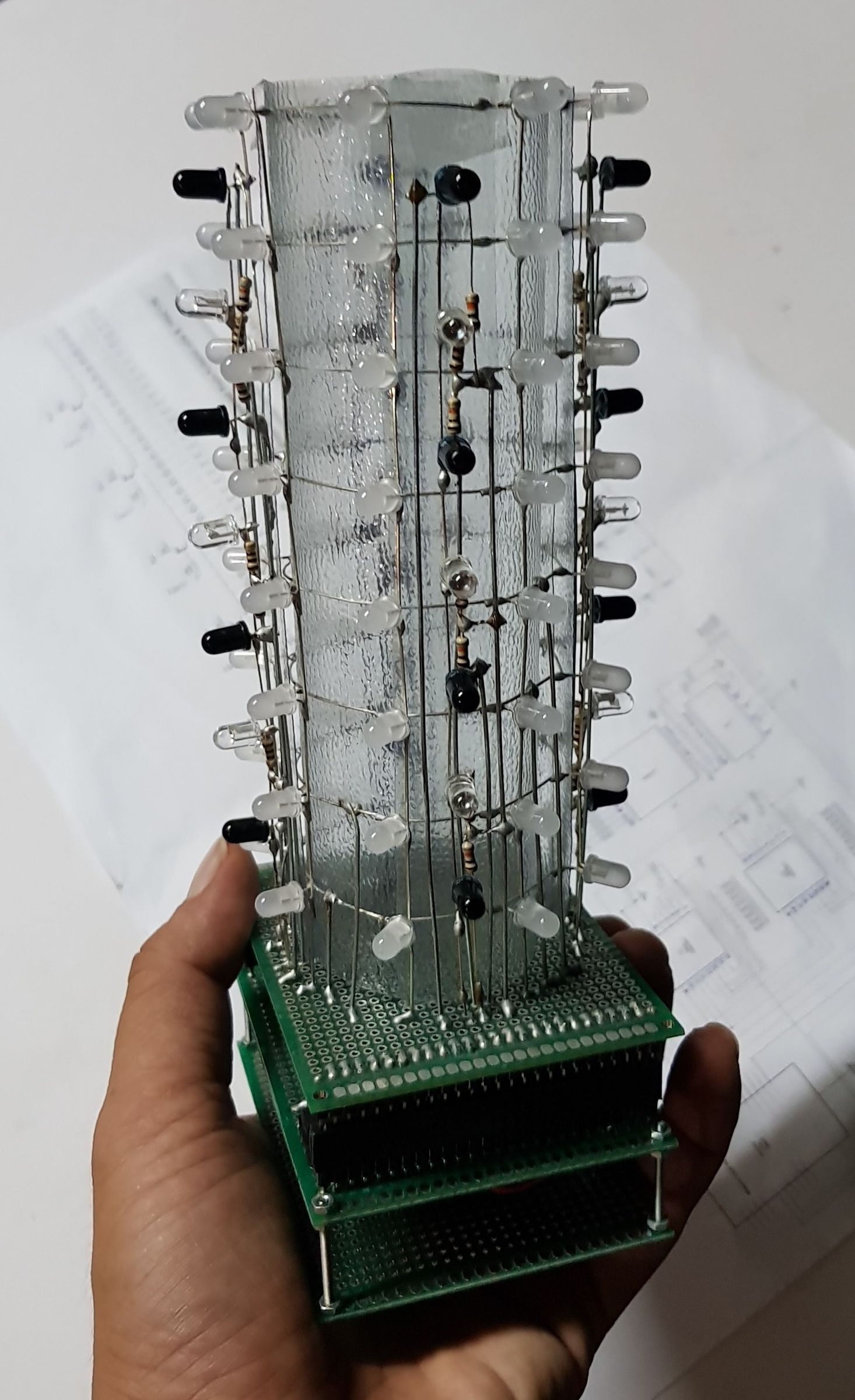

  • Cylindrical cube arrangement:
Let see the picture above to understand how to arrange Leds - Phototransistors - Infrared Leds.
- Yellow row: photo-transistors (x16 pcs), Common - Collector type with with RE ~ 10Kohm.
- Green color: infrared Leds (x12 pcs), connect to 5V with current limit resistor 100 ~ 150 ohm.
- White color: royal blue LED (x64 pcs), with current limit resistor 100 ohm.

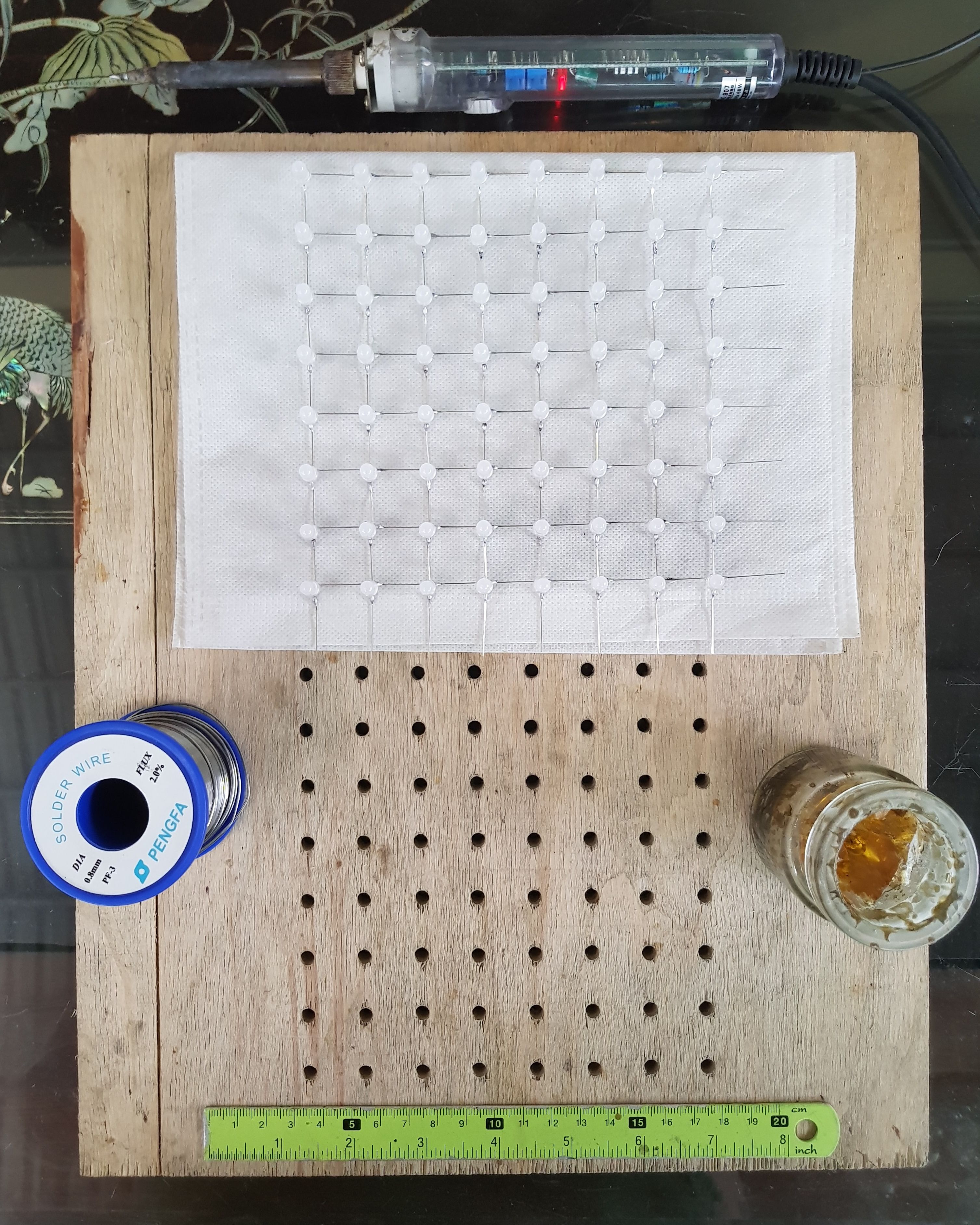

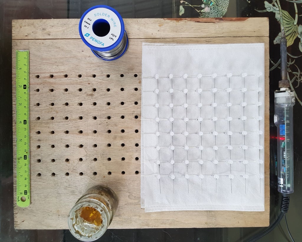

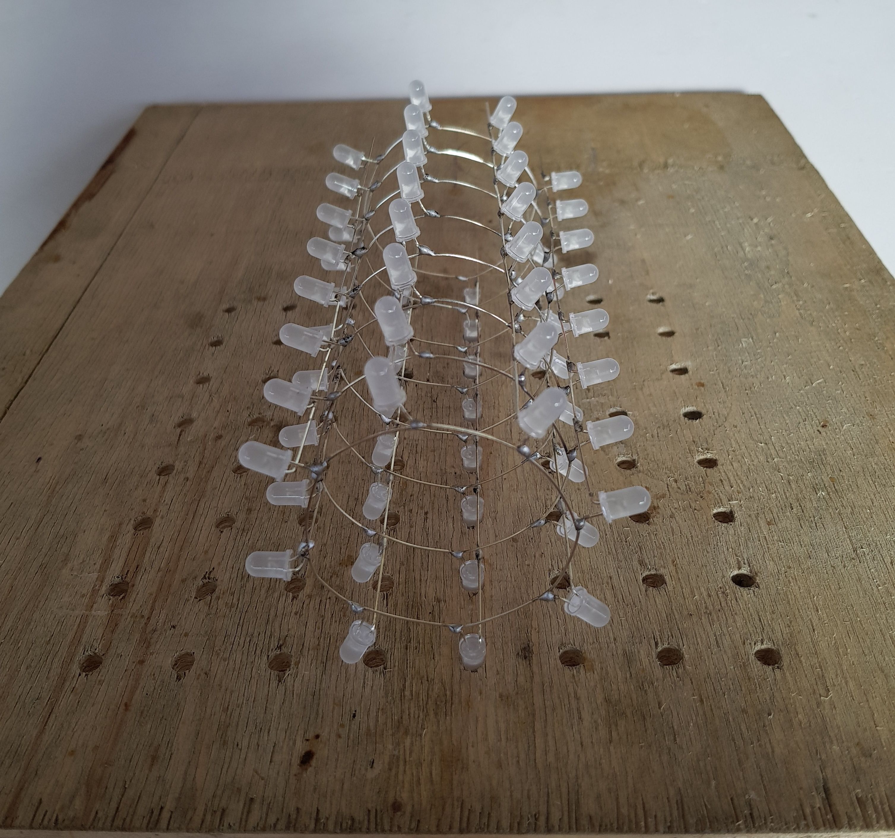

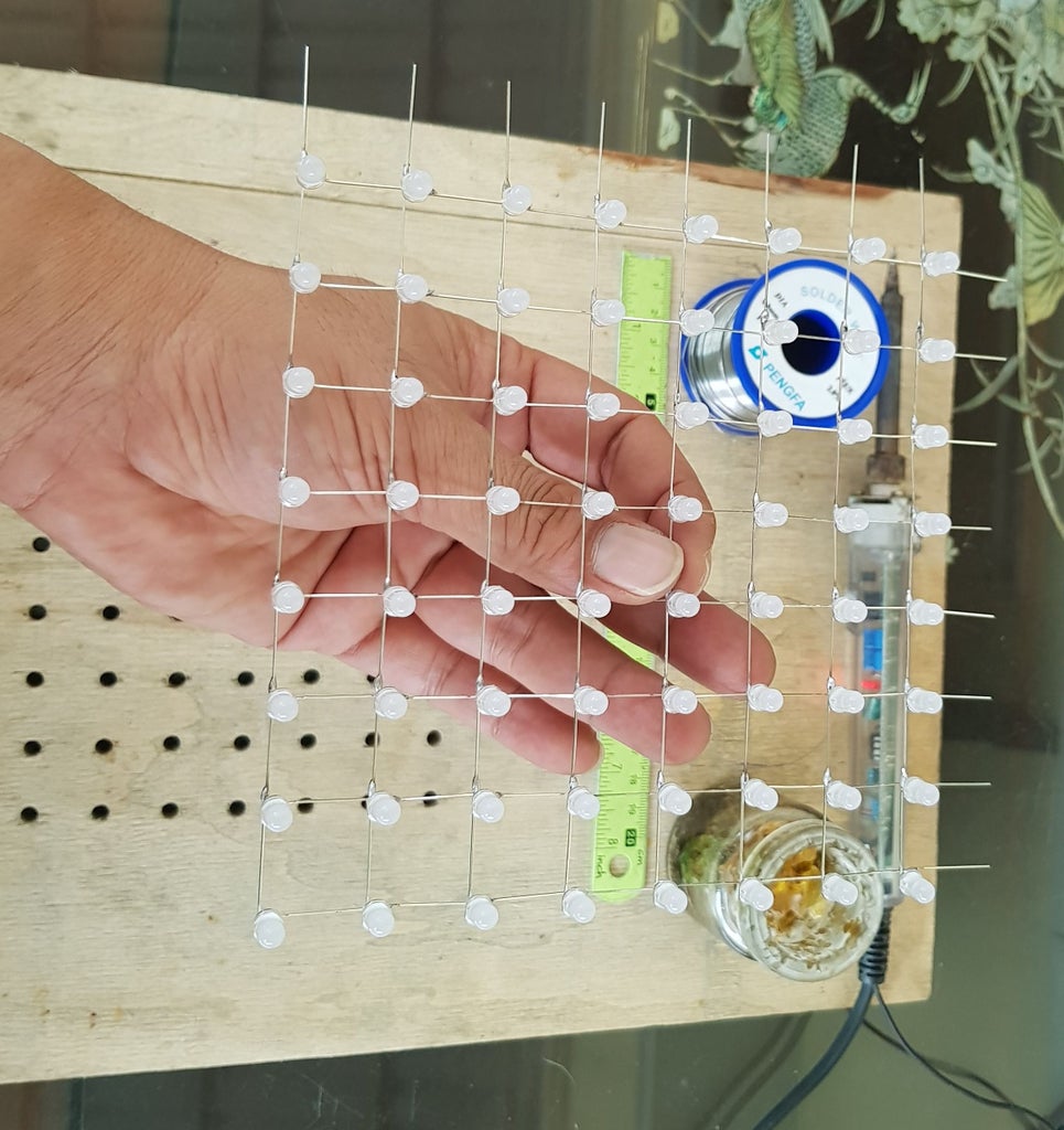

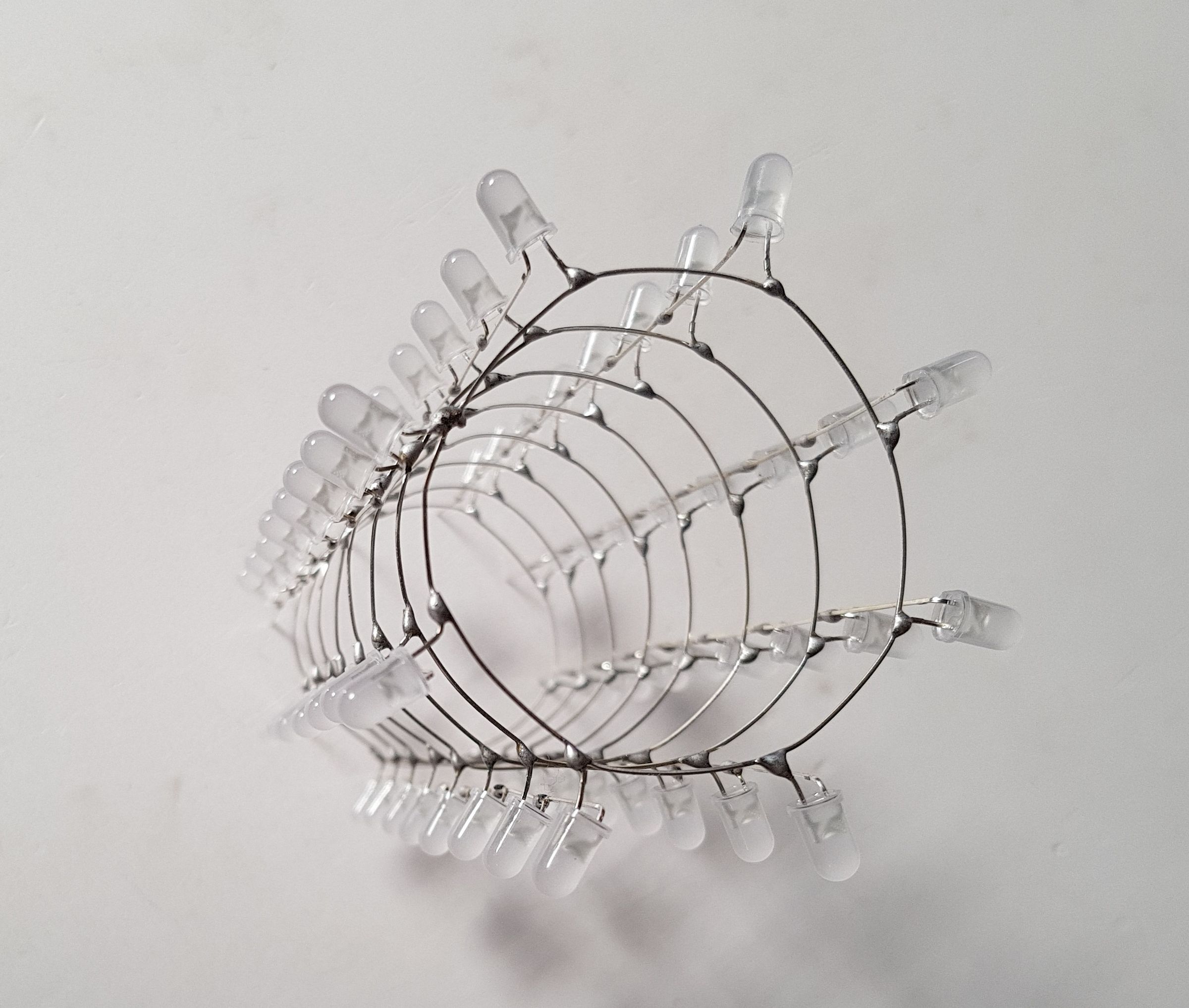

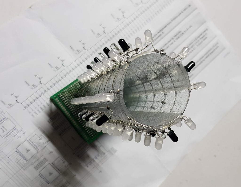

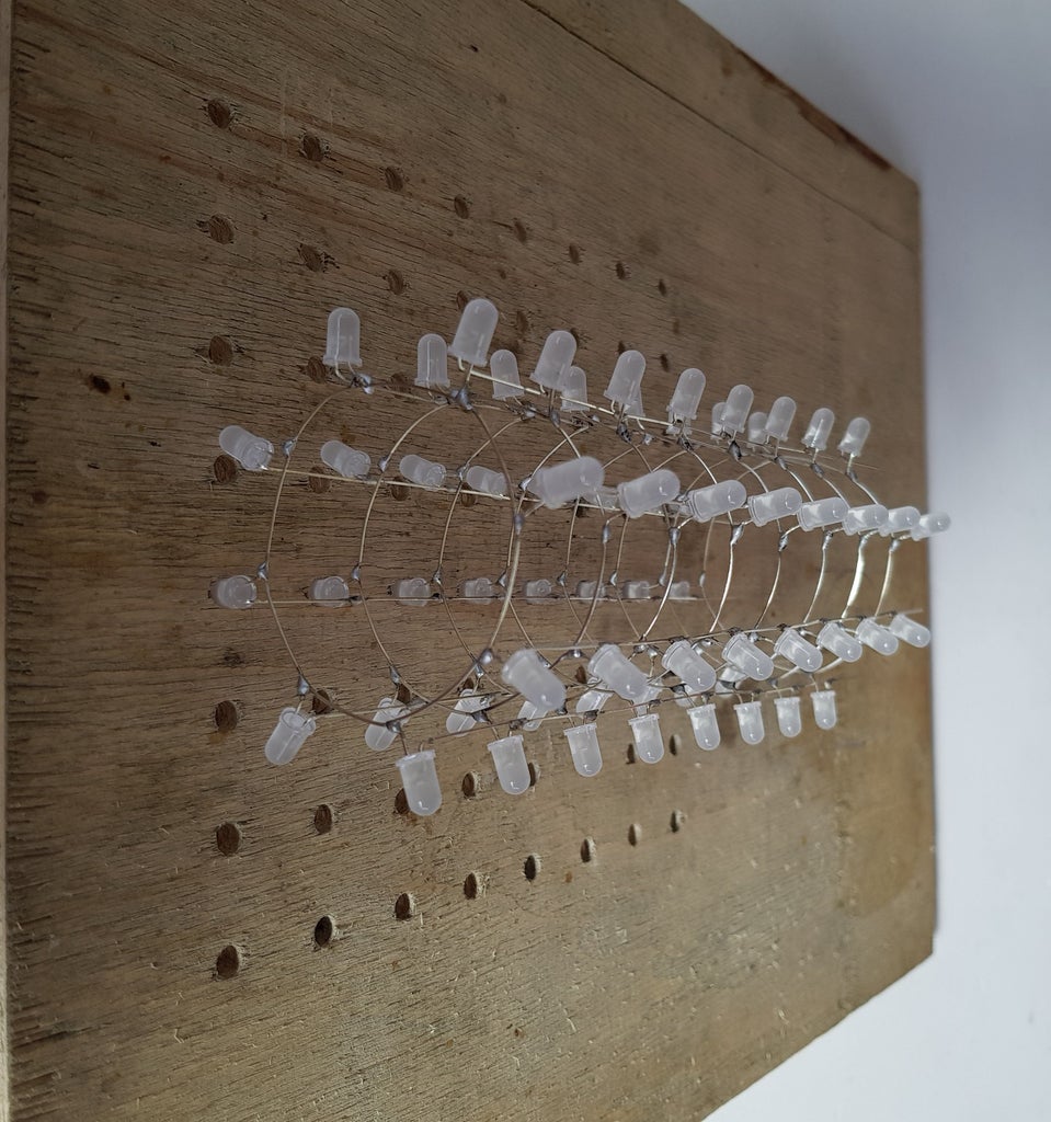

  • Build a cylindrical led 8x8:
In order to arrange leds in cylindrical form, I used a flat wooden template with LED spacing 20mm. And after all leds were soldered, I bent them to a cylindrical shape of 50mm inside diameter and 80mm outside diameter.
TIP: I used a PVC pipe with 50mm diameter and bent it slowly following this shape, then using a wooden template to fix the first column of leds while soldering last column and first column together.

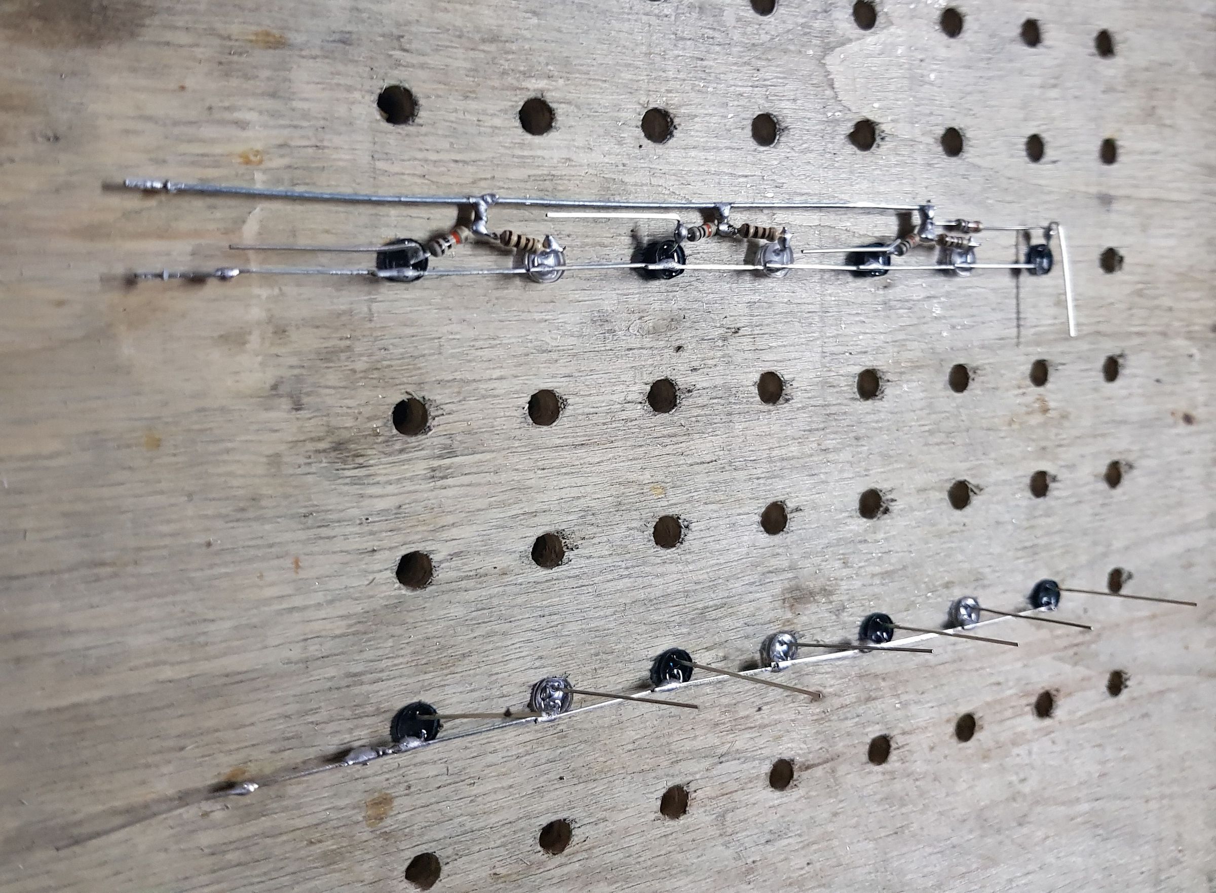

  • Build IR led and photo-transistors circuit:
Picture below is shown how to solder IR leds & photo-transistor circuit. I reused the led's wooden template to arrange the IR leds (white led) and photo-transistors (look like black led), note that 4 analog output pins of the photo-transistors should be arranged cleverly.
Soldering cylindrical led and IR led - phototransistors to DIY Prototype PCB base.

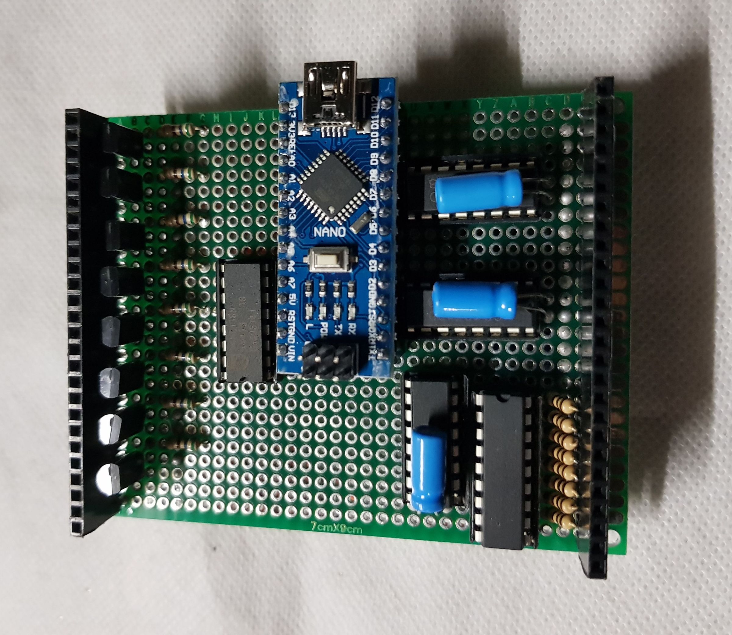

  • Build a control board:
Following schematic above to solder the control board

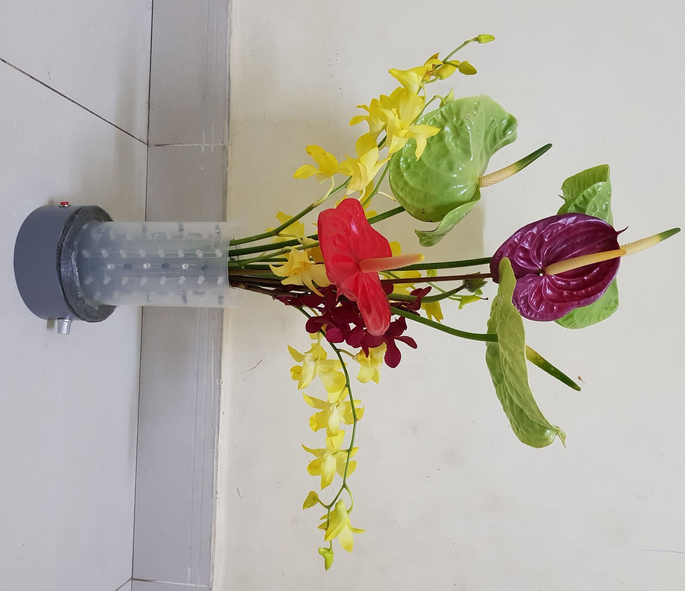

  • Finish interactive cylindrical cube

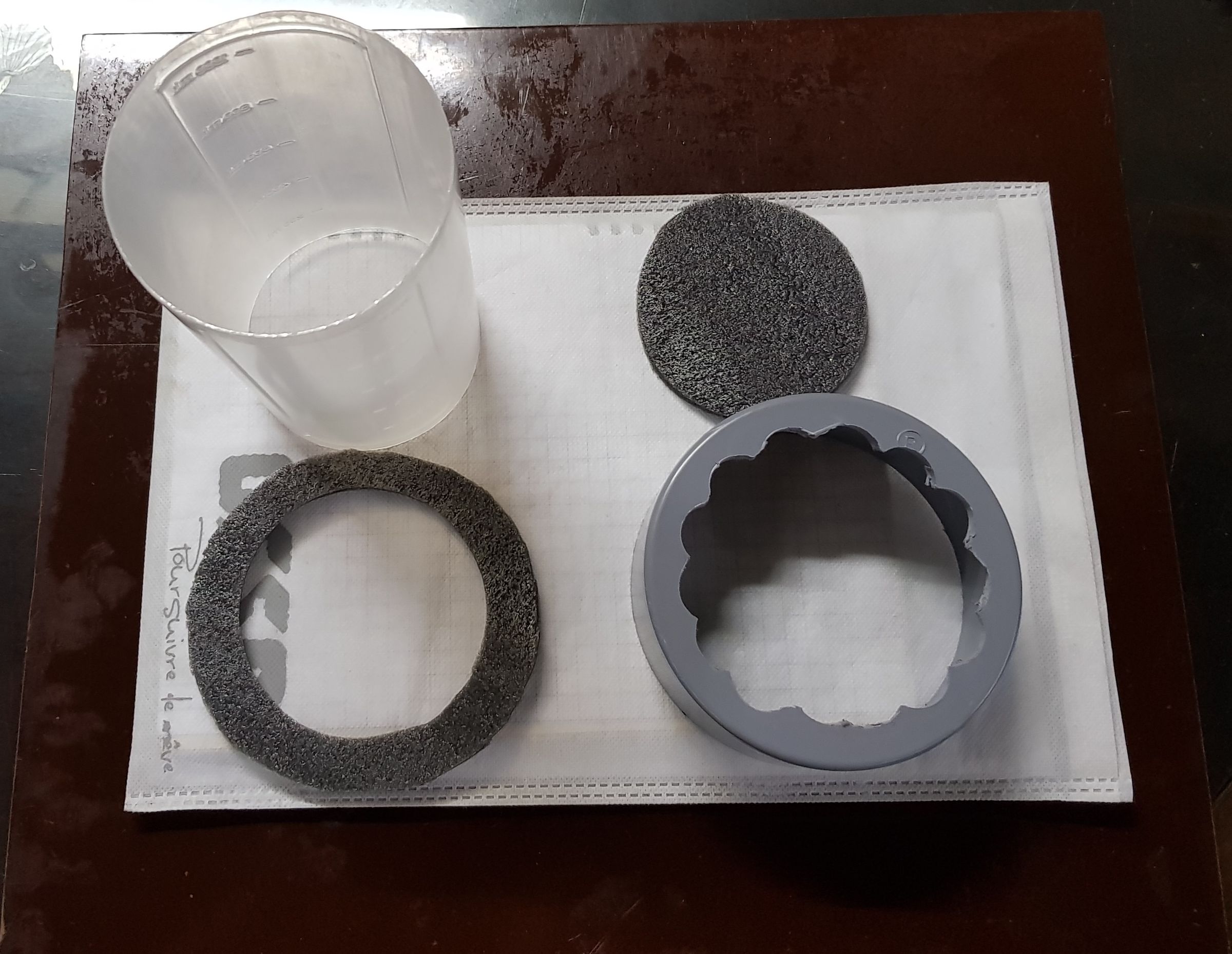

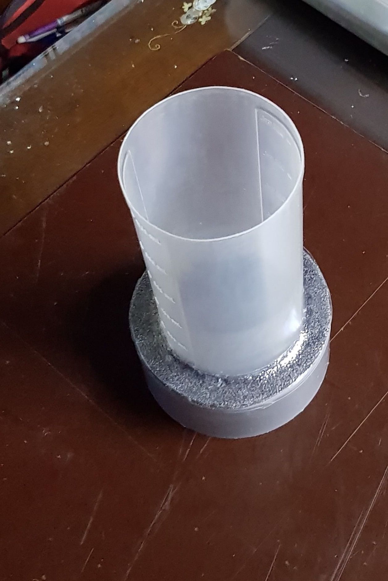

  • Build cover box
I reused one portable bottle, clear color with diameter 90mm, height 160mm and end cap of PVC pipe diameter 114mm to make a box cover.
I also added a push button and a potentiometer for further adjustment, ex:change working mode/ adjust the phototransistor response time/ fading time. Finally, I bought some flowers for decorating and testing.

See the red cell on picture above, it represent for the 16 photo-transistors, marked from Zone00 to Zone15 and around each zone, we have 4 LEDs correspondingly.
Example: Zone00[4][2] = {{3, 0}, {4, 0}, {3, 1}, {4, 1}}; It tells us that photo-transistor number 0 is read by A0 pin of Arduino Nano and around it is 4 LEDs with coordinates: {6, 0}, {7, 0}, {6}, { 7, 1}. When photo-transistor receives infrared ray higher than presetting value (ProximityValue), corresponding 4 LEDs will be turned on.

I used 2x74HC4051 as Multiplexer so Arduino Nano can read 2x8 different analog inputs from phototransistors every 200 microseconds through A0 & A1 pins.
