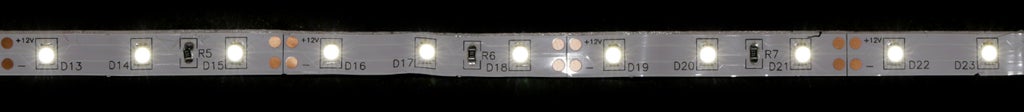

The most common type of LED strip you will encounter are analog strips. These can be either single or multi-color. These types of LED strips typically use 12V power, but you will want to double check. Sometimes they can also be 5V.
Single color LED strips are quite simple to power up. They have two wire attachments, one for 12V power and one for ground. When they are connected to a power source, they glow a single color.
You can find single color LED strips in a variety of colors.

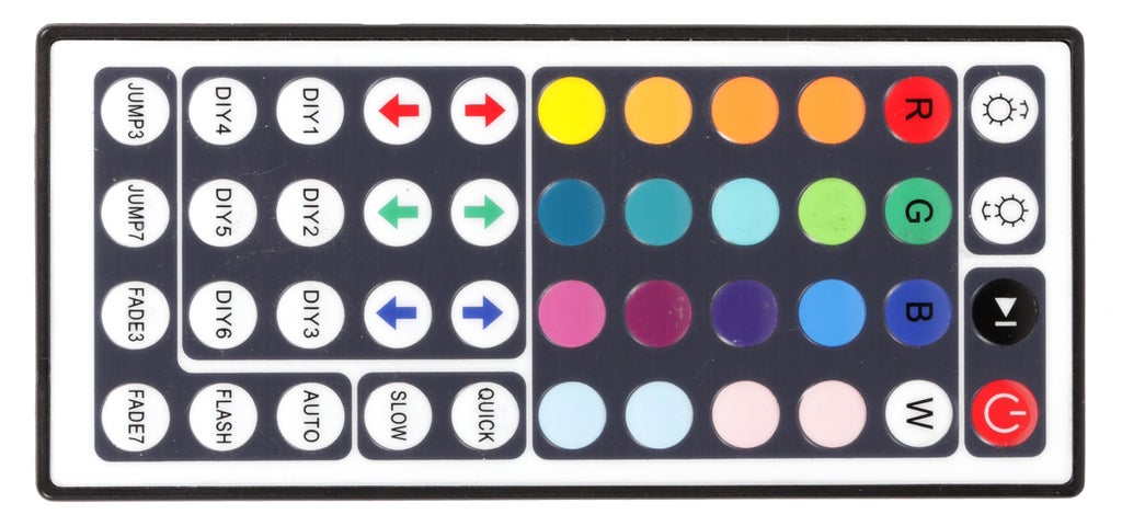

The easiest way to control analog LED strips is with a out-of-the-box LED strip controller. These plug-and-play controllers are typically suitable for most LED strip projects. Before I try to build custom circuitry, I always check to see if there is a controller that suits my needs.
These controllers are simply connected in series between the LED strip and the power.

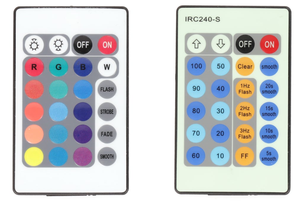

They are then controlled wirelessly via remote. Different controllers have different functionalities which you can tell by looking at the remote. At that, they are dead simple to use.
One thing to keep in mind about wireless control, is that there are two types of ways these comes. Some are radio, which works even if the receiver is hidden. Others are IR (infrared) and require the remote to have "line of sight" to the receiver (like your TV). These receivers have a cable connected to a little plastic box.
The only thing to be mindful of is whether you are getting a controller for single color LED strip or multi-color LED strip. The quickest way to tell the two apart is that multi-color controllers have color settings on their remotes and single color controllers don't.

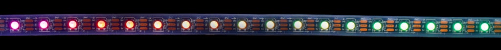

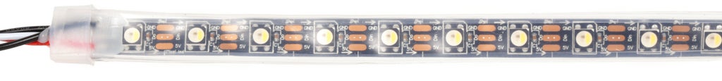

Aside from analog strip, there is also addressable LED strips. This type of LED strip uses a digital communication protocol to control each LED or "pixel" individually. While all of these strips operate roughly the same, there are a number of different communication protocols for controlling LED strips. It is important to understand which protocol to use. This can be determined by checking the documentation provided by the distributor of the LED strip.
For our example we are going to use Adafruit's 60 LED neopixel LED strip. This LED strip uses a single-wire protocol, and by varying the length the signal is high (5V) or low (ground), determines the type of data being sent. It is very confusing.
Fortunately, Adafruit has created a library to do all the complicated timing and single-wire communication for you. It just requires downloading, and copying their Neopixel library into your Arduino software's library folder. Once it's copied, just reset the Arduino software and it should be installed.
To make use of the Neopixel library, load the following file:
File --> Examples --> Adafruit Neopixel --> RGBWstrandtest
The LED strip should now run through a series of test routines to demonstrate their use. Notice how each LED is capable of being a different color. This is what sets addressable LED strips apart from analog.
