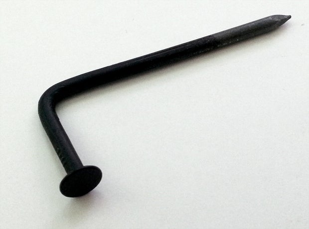

Using a capped bottle as a guide the nail was positioned where the flanged nail end met with the edge of the cap lip, a mark was made where the nail met the drilled opening in the wood handle.
With two vise pliers, the nail was bent in a 90° angle at the mark. Any scuff marks made during bending will be covered in paint later.
