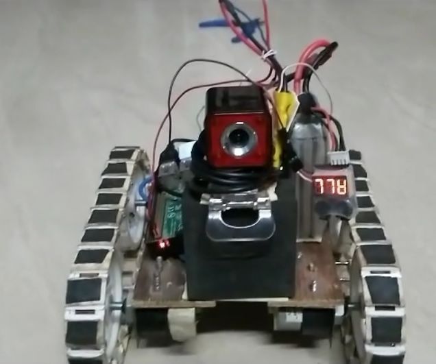

Introduction: Object Tracking Bot Using Image Processing
the objective of this instructable is to bridge the gap between image processing and robot manipulation . yes , they are two different field but we can combine them to do some amazing things.this instructable is just a basic process of interfacing two different fields . it illustrates how to communicate between a computer application to an hardware .

5.things needed for building a bot(chassis,wheels,motors,caster wheel,wires,battery)
i am just going to cover how to get information about the position of the object and how to follow it . since details about building bots are available every ware on internet..................... i am going to leave that part to u

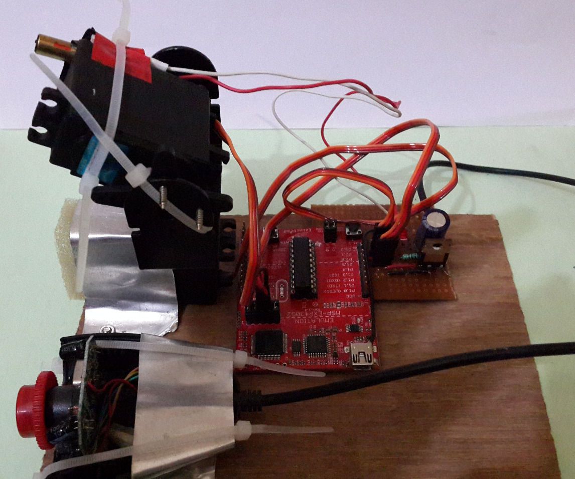

Step 3: Arduino Setup
this is just simple step. open the code in arduino ide and click upload .. that's it .. (i will explain how this codes work in further steps don't worry )
PINOUTS
right side positive =11
right side negative = 10
left side positive = 9
left side negative = 6
all these pins are pwm enabled . you can modify this same code if u wnt to add any kind of control algorithms like PID,FUZZY,NEURAL etc
these pins should go to the driver board because arduino cannot supply enough current for driving motors from your usb port .
positive and negative are chosen in a manner if i connect 5v to positive and 0 to negative the bot will move forward
