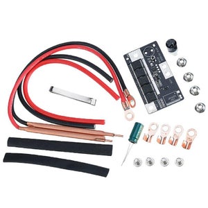

Material Used:
  • 3.2V 150Ah LiFePO4 battery cells (8 pieces)
  • BMS (Battery Manage System, 1 piece)
  • Connectors (About 8 pieces)
  • Others: Epoxy boards, EVA cotton, screws, ribbon cable, plastic pipes, etc.
Tool Used:
  • Spot Welder
  • Spot Welding Pen
  • Soldering Iron
  • Wire Cutter
  • Wire Stripper
  • Multimeter
