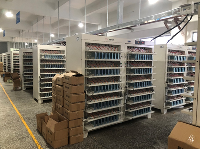

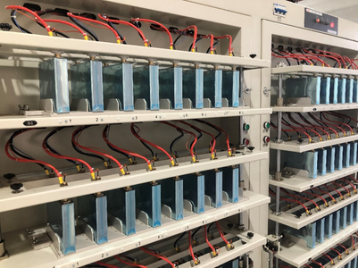

Step 1: Capacity Grading
Determine the capacity of the battery cells.
In this step, every cell is charged and discharged in the capacity grading machine, which resembles a huge charging station.
Capacity= Discharge Duration* Discharge Current
This process is capable of weeding out products with substandard capacity and those of poor quality.

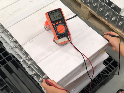

Step 2: Matching
Make sets of battery cells in the light of the difference of the values of capacity (<1%), voltage(<10mV), and resistance(<0.4mΩ). The cells with close values form a battery pack which only in this way can perform at its best.

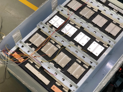

Step 3: Forming
Form the battery according to demands.

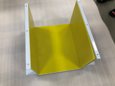

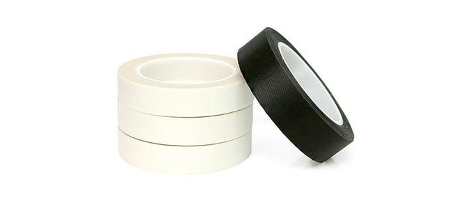

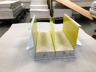

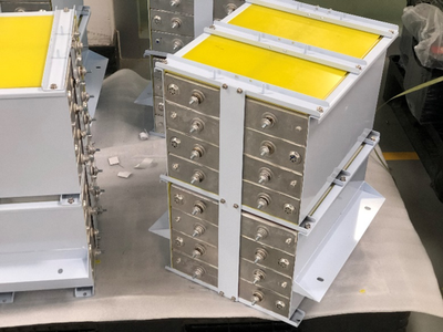

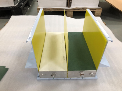

Insulation is the most important part when forming a pack. The metal box painted is associated with an insulating effect. But it happens that the painted material is scratched, in which case the metal is still conductive. Therefore, it is necessary that the epoxy boards should be placed between the cells and the metal plate to have an insulating effect.
Epoxy board and fish paper are put between each of the two cells.
Metal bars are needed to fix the cells.
Step 4: Welding

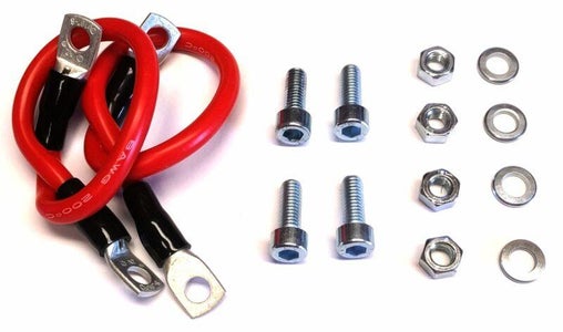

The cells can be connected in series or in parallel by the screws or the connecting sheets. There are two types of connecting sheets: aluminum or copper-aluminum composite. The purpose of welding is to connect the cells in series or in parallel so as to obtain a pack with the voltage or the capacity needed.

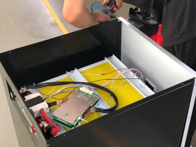

Step 5: Installing the BMS
The BMS can control the state of the battery to avoid over-charging and over-discharging, to protect the battery from over-current and high working temperature in order to prolong the battery life and improve battery utilization.
To install the BMS, the first step is to fix the signal acquisition cables and then the positive and negative cables of the BMS. Finally, put on the cover plate and test the screen.

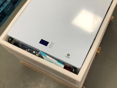

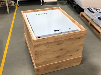

Step 7: Packaging
After the test, the assembly is almost done.
The battery needs to be packaged before transport. During this step, all the accessories should be put inside the package case, including a communication box, communication wires, cables linking to the inverter, some screws, and so on. The battery and the kits are well protected by the wooden box.
