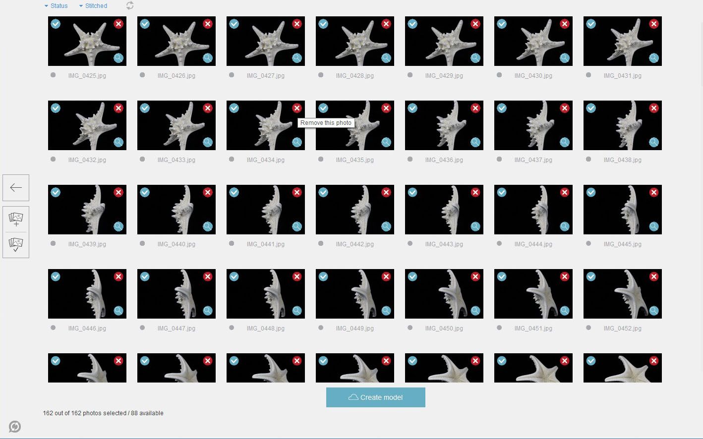

When you think you have enough photos of your object, upload them onto your computer and take out any that are blurry or have other flaws. Now you can upload them and turn them into a model!
When you open up ReMake on your desktop, you will see a tab for your 'Dashboard' and 'Editor'. The Dashboard is where you will upload photos to be made into 3D models, and access the models you have already created. The Editor is where you view and edit your models once they've been reconstructed from your photos.

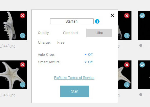

On the Dashboard, click on the ‘Photos’ icon under ‘Create 3D’. At this point you can choose to either create your model 'Online' or 'Offline'. Unless you have a very powerful computer, you always want to choose 'Online.' You’ll then be given an option to select photos from either your ‘Local Drive’ or Autodesk Cloud drive. My photos are on my computer, so I’m selecting ‘Local Drive’.
Browse to the folder with the photos of your object and open them. All the photos you selected will show up in a window. When you have all the photos you want, click the ‘Create Model’ button at the bottom of the page to upload your photos to the cloud.
Back on the Dashboard screen and you’ll see a thumbnail of your project under ‘My Cloud Drive’ at the bottom of the screen that shows the upload progress of your photos. Don’t click away from this screen until the upload is complete and has switched to ‘Waiting in Queue’. Once it has processed at least 1% in the queue, you can click away from this screen, but if you click away before that, your job will stop processing.
Now just wait for your model to be created which can take up to an hour.

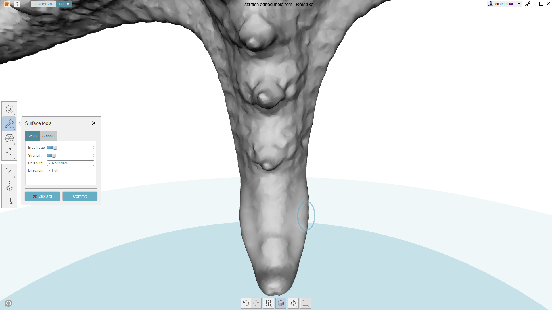

To make a hole in the arm of the starfish, I first used the sculpt tool to pull and widen one of the ends of the arms so it could accommodate a hole.

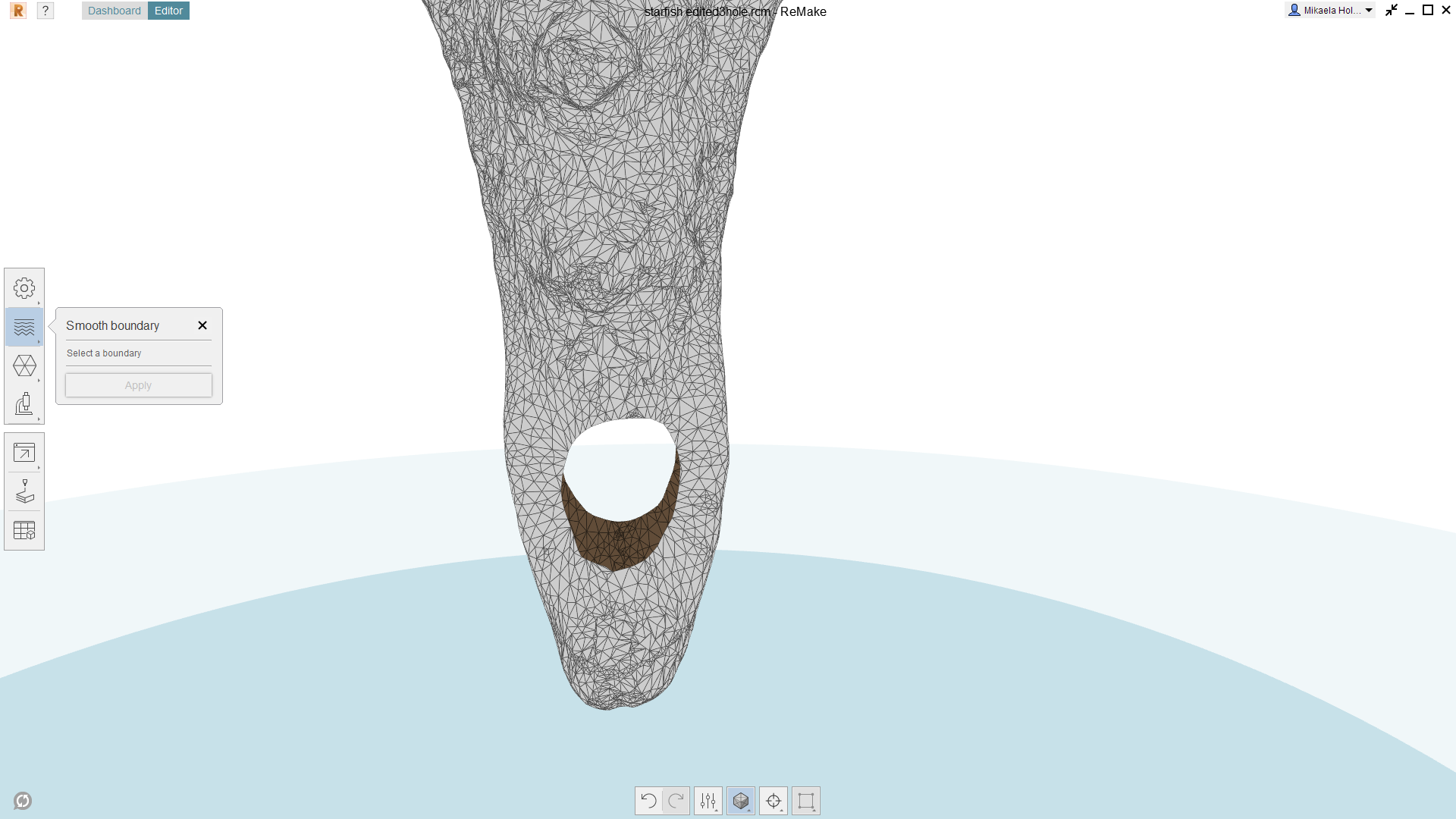

Then I used the lasso selection tool to select all the way through both sides of the mesh and delete where I wanted a hole.

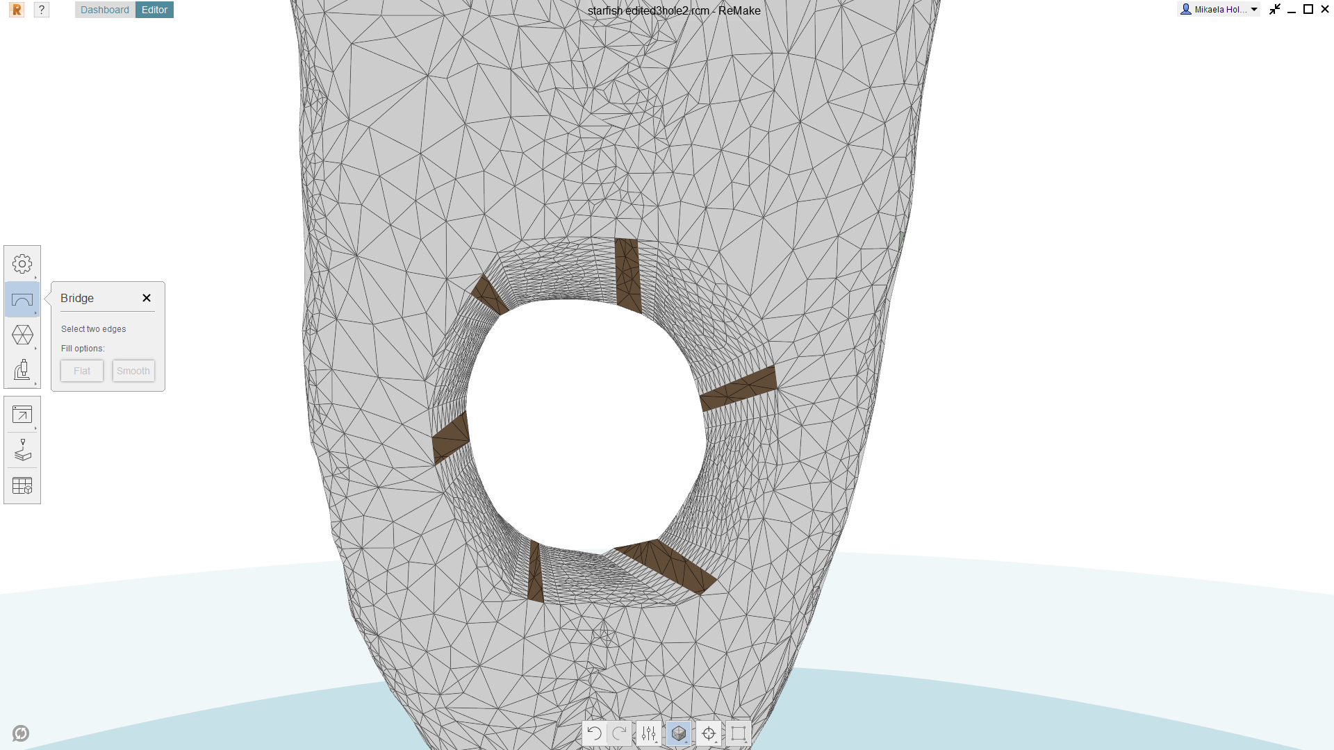

To close the edges of the hole, I used the bridge gaps tool to make bridges between the two sides at regular intervals around the hole.

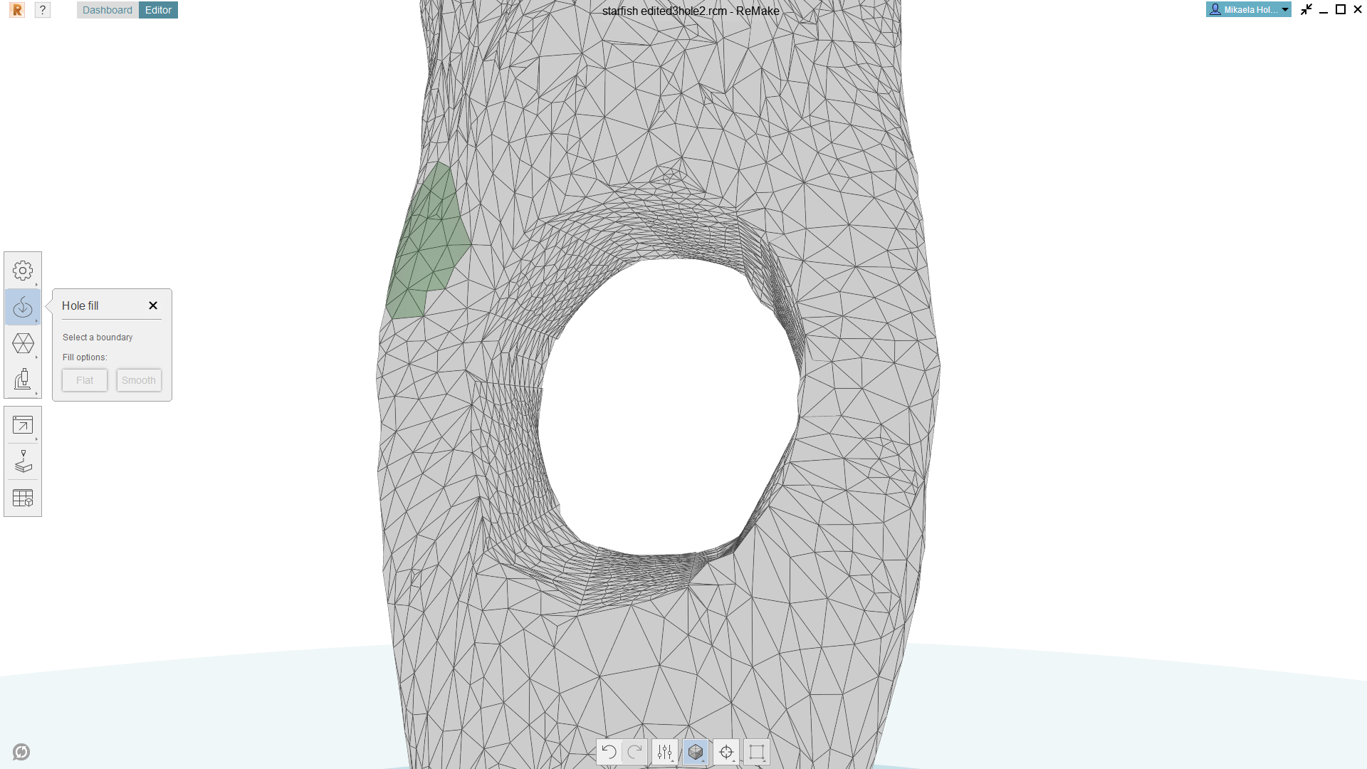

Then I used the fill holes tool to fill in the spaces between the bridges.
I used the same process to create a hole on the opposite side of the starfish between the arms. I saved one version of the file with both holes, and one with only the hole between the arms.
