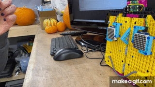

Firstly, I set about making the robot face. Raspberry Pi have a great tutorial on this HERE. The LEGO® Spike kits are great for educators and you can do lots of different projects with them. I originally set up my robot face exactly as it is in the tutorial before starting to play and modify the code. I wanted to make sure that all the basics worked. This build guide was super useful and follows the style of LEGO instructions we know and love,
Step 2: The Lego Pumpkin
I am a lego addict, so I already had a lot of orange bricks. I used a mix of bricks, plates and connectors to make my pumpkin. It took a few attempts to make it the right shape to fit the face. I didn't want to glue any of it in place but if you wanted to make it a regular feature than I would.
