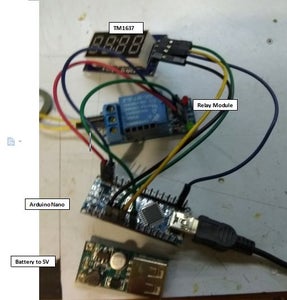

Step 1: Basic Modules
The basic modules of this project are:
  • LCD 7 segments modules TM1637
  • Relay module
  • Arduino Nano
  • 18650 battery and DC to DC 5V USB (or other suitable 5V supply)
optional:
  • 2 toggles switchs
  • blinking led circuit (with a 555 chip)
  • mp3 speaker

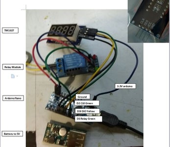

Step 2: Connections
Connect the LCD module to Arduino as follow:
  • Ground to Arduino Ground
  • D2 to LCD CLK
  • D3 to LCD DIO
  • VCC to Arduino 3.3V
Connect Relay module:
  • Ground to Ground
  • VCC to 5V
  • Relay signal to D5 of Arduino
Connect the optional blinking circuit to the ground and 5V
